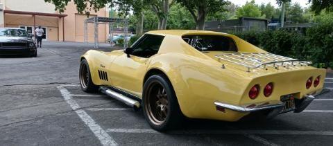

T56 all the way borgeson steering box big flares willwood brakes and a bad *** 600 hp engine and look at ggull's vette .

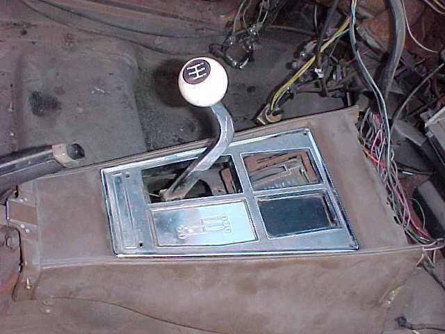

I'm in the middle of such a conversion on a 78. Fixing other things that need attention so will be awhile before road testing. I'll try to remember this thread and report back.
