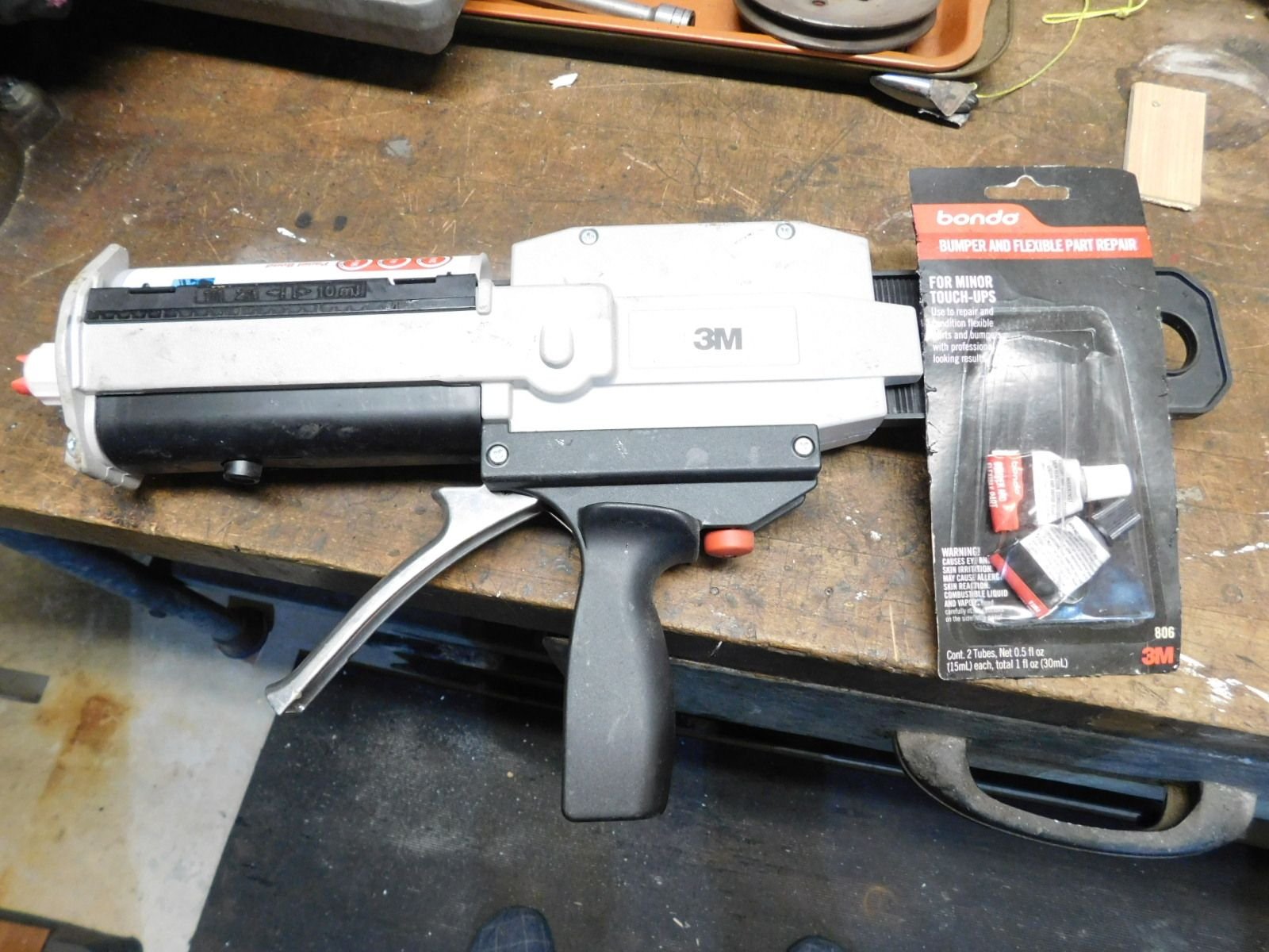

3M panel adhesive will bond and repair most anything/any kind of plastic. What I've found is that Bondo bumper repair is the "same" adhesive. Try it and you will very happy with the results.
