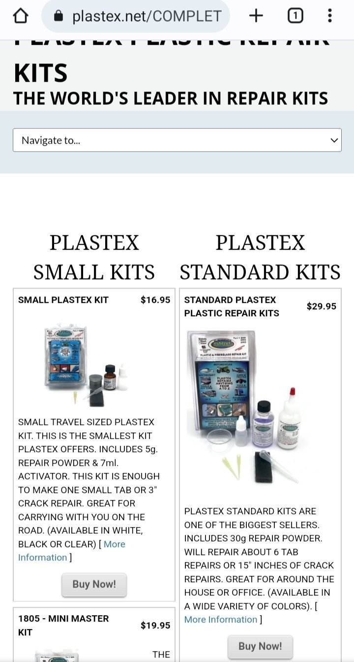

What about this Plastex stuff? anyone here tryed that?
To Plastic glue?
Old Aug 22, 2022 | 05:13 AM
4-vettes's Avatar
4-vettes
Posts: 13,227
Likes: 7,825
Cruise-In VIII Veteran
This stuff.
