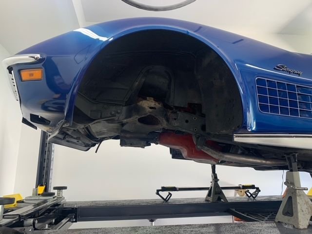

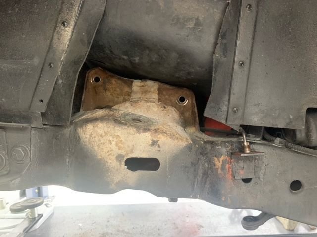

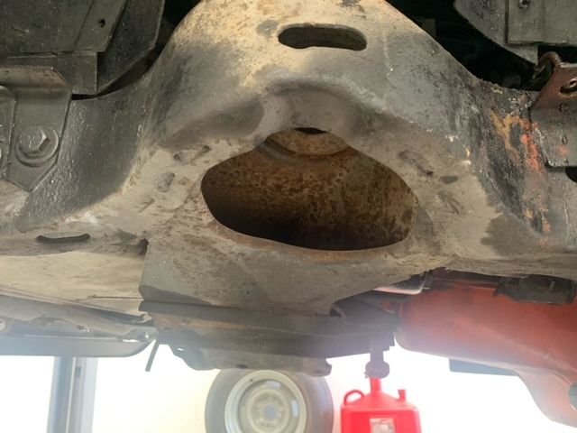

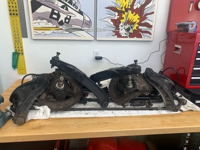

I'm in the process of rebuilding my front suspension. I've stripped everything off and plan on rebuilding using a full kit that I got from Zip. The underside seems to only have had required maintenance over the years, so much of it is original and my goal is to keep the car close to stock/original.
Looking for opinions/suggestions on what to do with the frame and suspension parts as I put it back together.
Part of me just wants to clean up the 50 years of gunk, bolt on new parts and go, or I can take this opportunity to clean up the surface rust, paint the frame, strip and repaint the control arms, springs, sway bar. None of this will make the car drive any better. Does it add much value to take the time to put the "correct" finish on these parts if I'm never going to show it or go for NCRS....

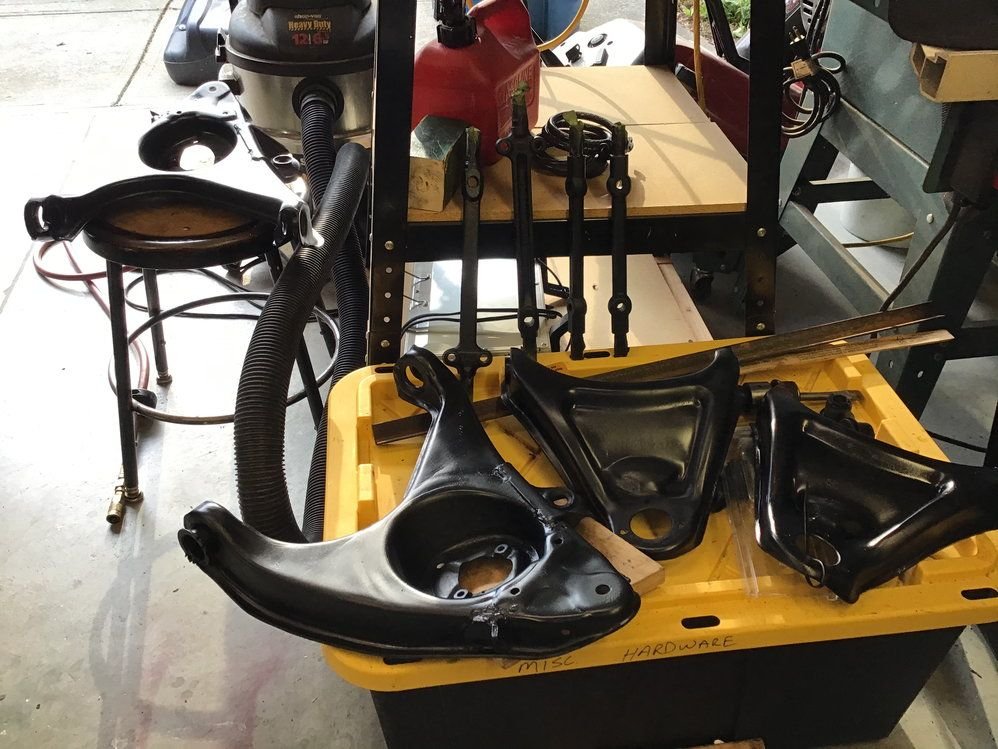

The Eastwoods chassis black (and extreme chassis black) looks, good, covers very well, sprays nice, stands up good. With some creative masking (tin foil as mentioned and press-n-seal plastic wrap) you can do a pretty decent job.\
Remove any loose paint/rust/scale. smooth out any paint/bare transitions, scuff everything with some medium scotchbrite type pads, wash-n-wipe or paint thinner wipe and it'll turn out great (mask the crap out of everything in the entire garage, the over-spray goes places you can't even imagine)

i couldn’t find the professional semi rustoleum anymore..and agree the chassis black is a good match, good product.
the one below works good too..but I don’t remember where i got it!

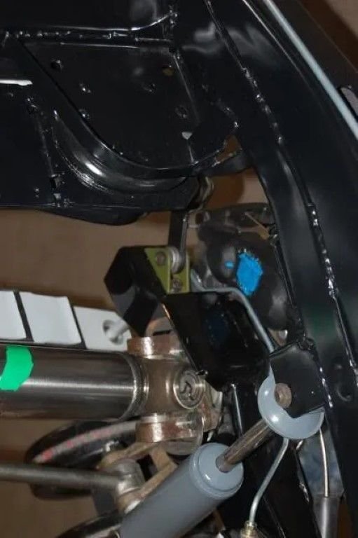

Not sure if this helps or not
Stolen mercilessly from Alan71 archive of pictures

Yes that helps a lot! Thank you

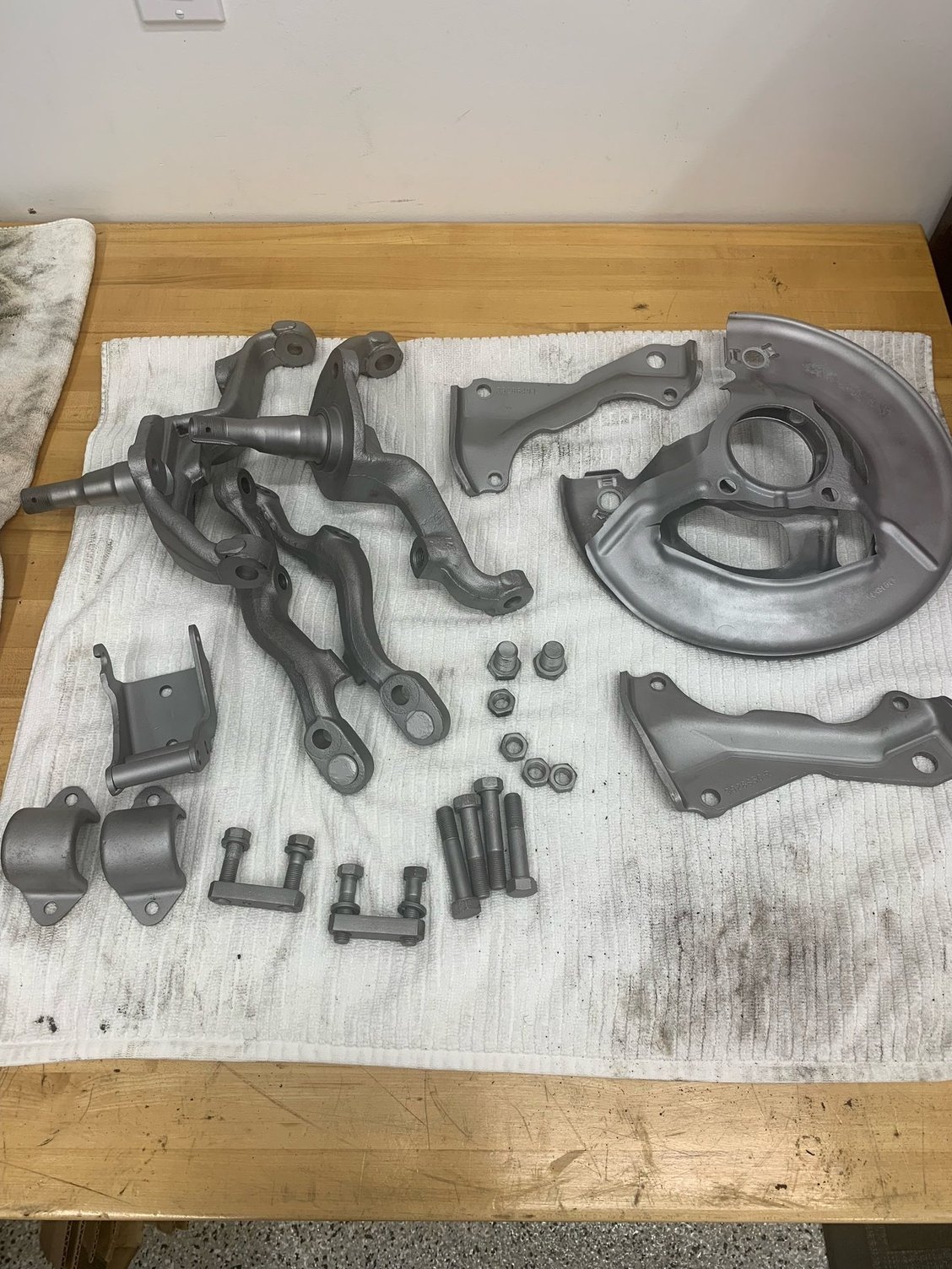

Got my first batch of parts back from media blasting today. I would like to confirm my plan for prepping and painting.
I was told to wash everything is mild soap and water to remove any blasting residue and remaining grease - I was thinking about giving everything a quick dip and brush in Simple Green, rinse with water and dry.
As for paint - looking at the picture in the thread from Alan71 archive
- Dust shields & caliper brackets - Satin Clear
- Spindles, steering arms, lower control arm mounting blocks - Cast Blast Gray
- Upper spindle bolt - satin clear?
- lower spindle bolts - black anodized?
- power steering bracket - semi gloss black
- sway bar brackets - satin black
