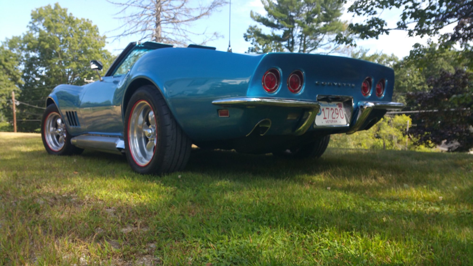

I installed side exhaust on mine in 1972 and have not regretted it yet. At the time I really wanted side exhaust, the work to install was irrelevant. I just did it.
It's mostly a bolt on install anyway.
I glassed in the rear.

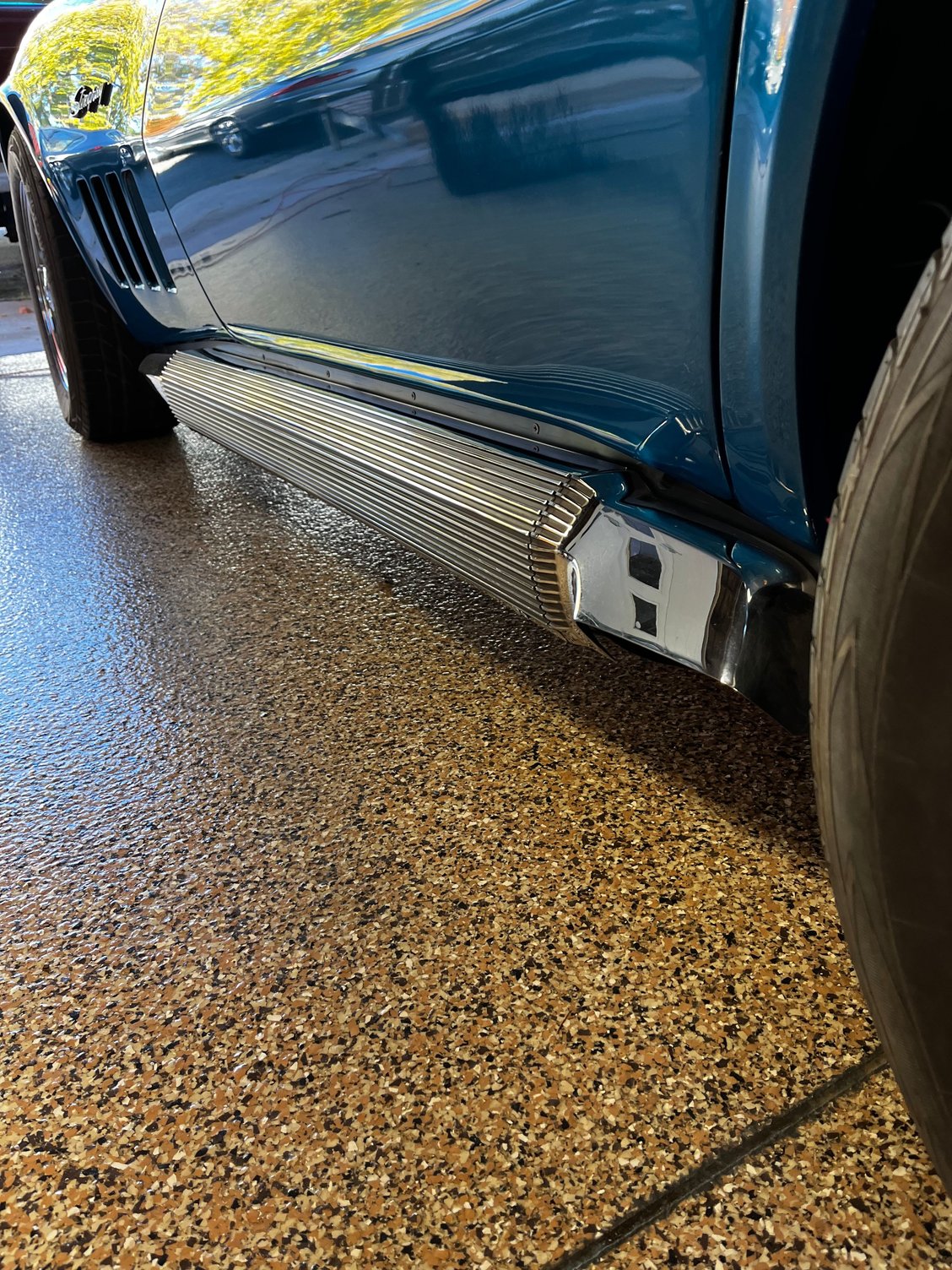

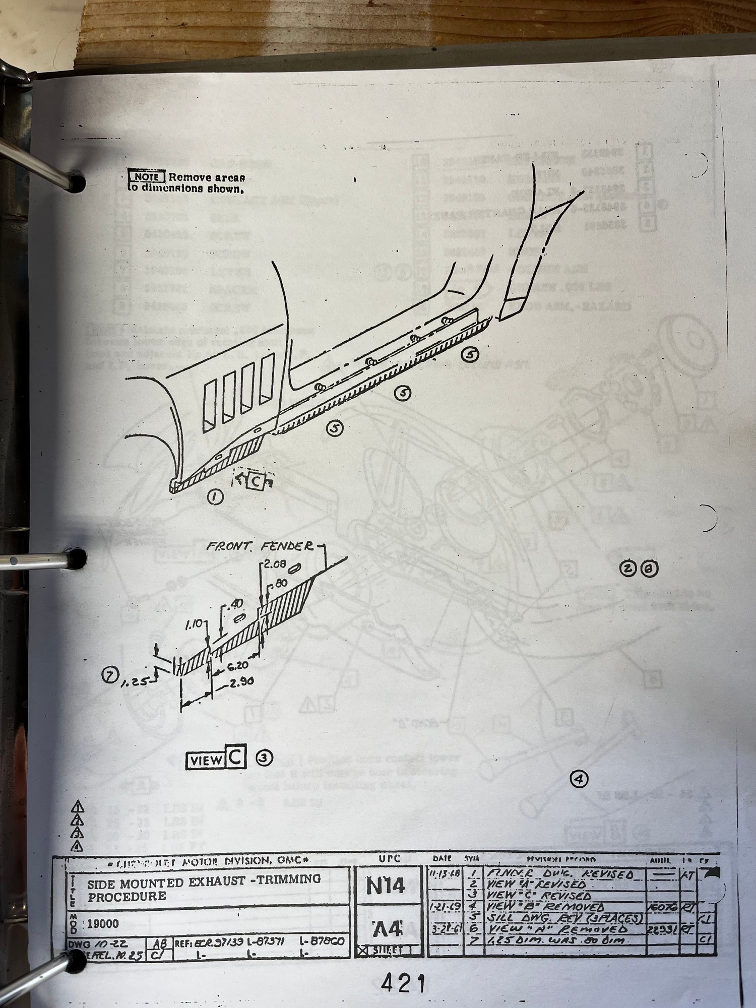

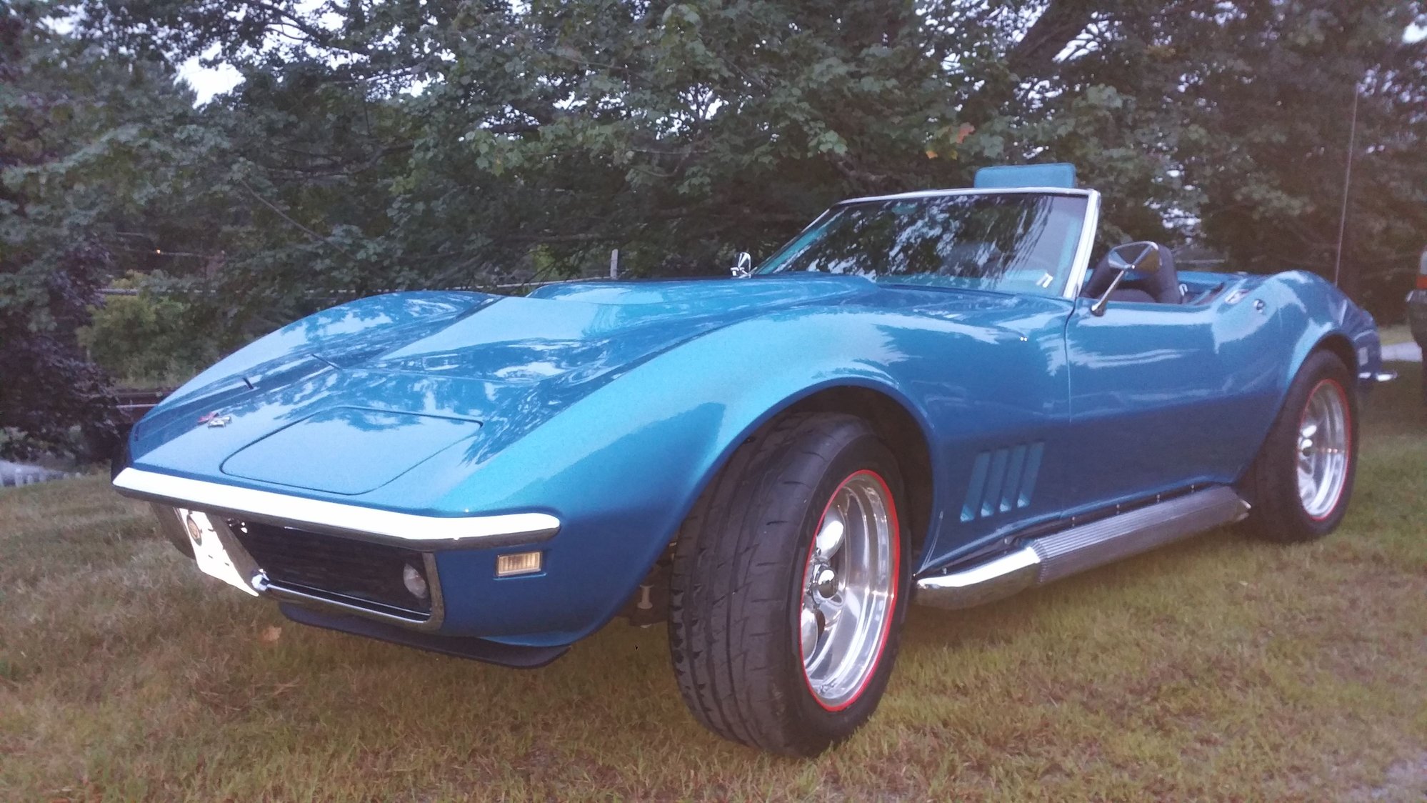

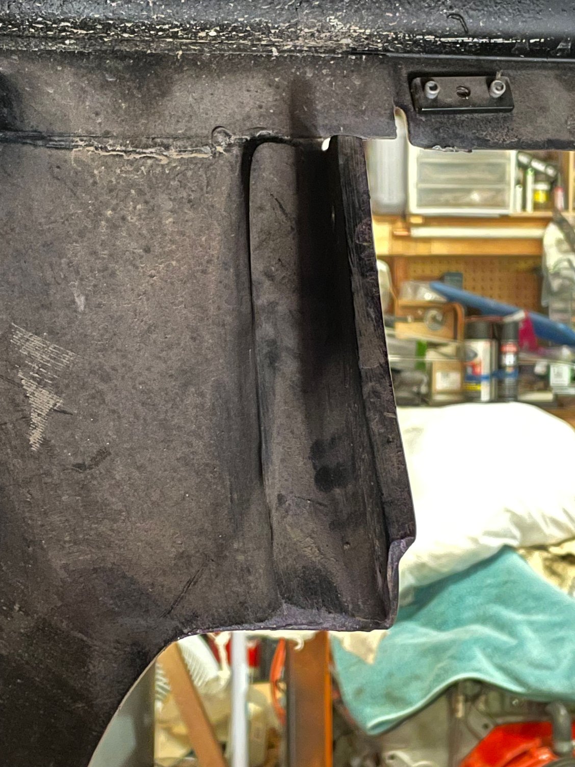

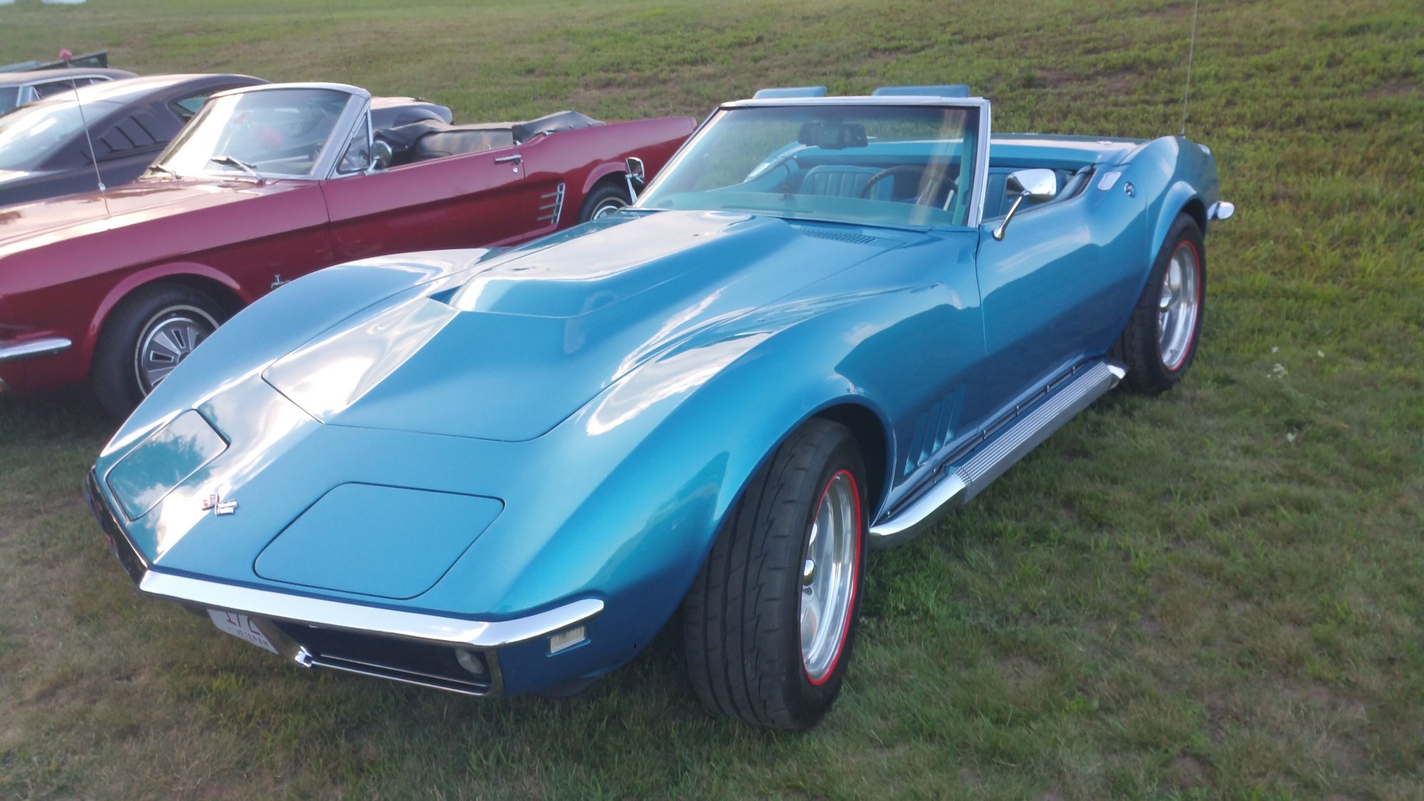

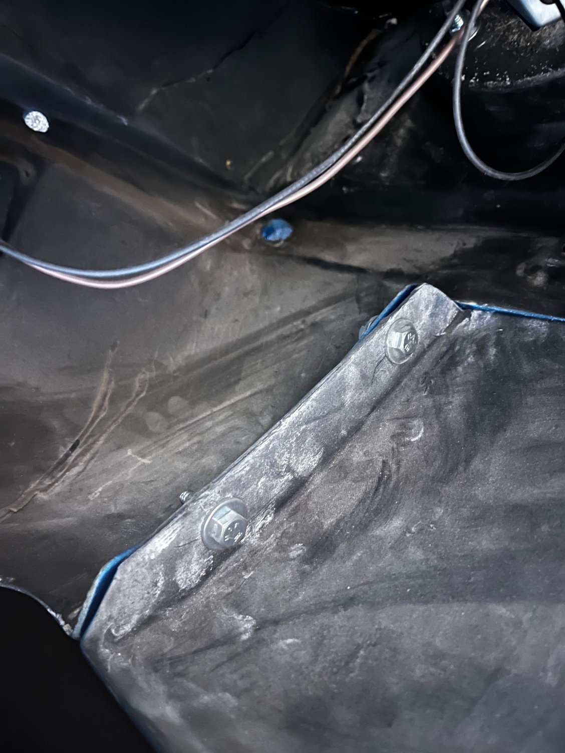

This is my car: 69 L71 coupe, N14 option (Side Pipes)
It was a total mess when I bought it 7 years ago.
Some previous owner converted it to under car exhaust.
I wanted to go back to what the build sheet had on it; option N14
You can see the cut out fenders to allow tail pipe to exit.
You can use the lower valance that PJO has pictured above to fill the cutouts.
I went the other way taking it back to original.
My friend did the glass work.

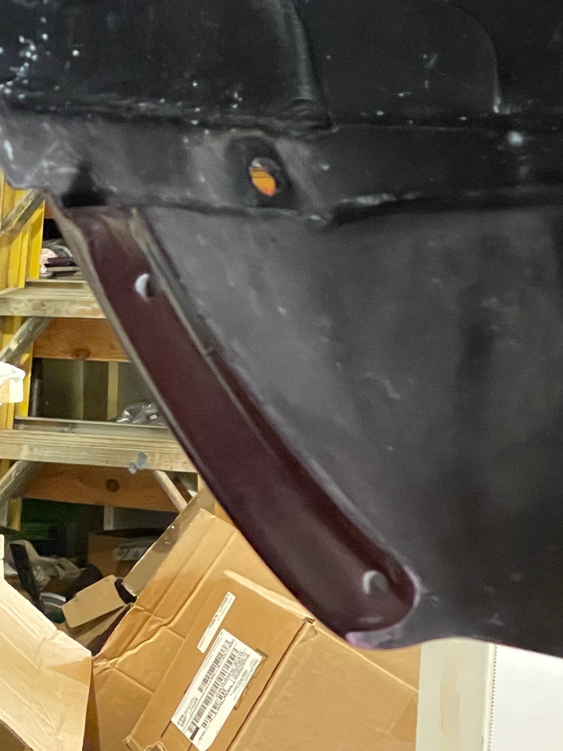

Here are some under car pics.
These are the flanges you have to make.
So that can run into money!

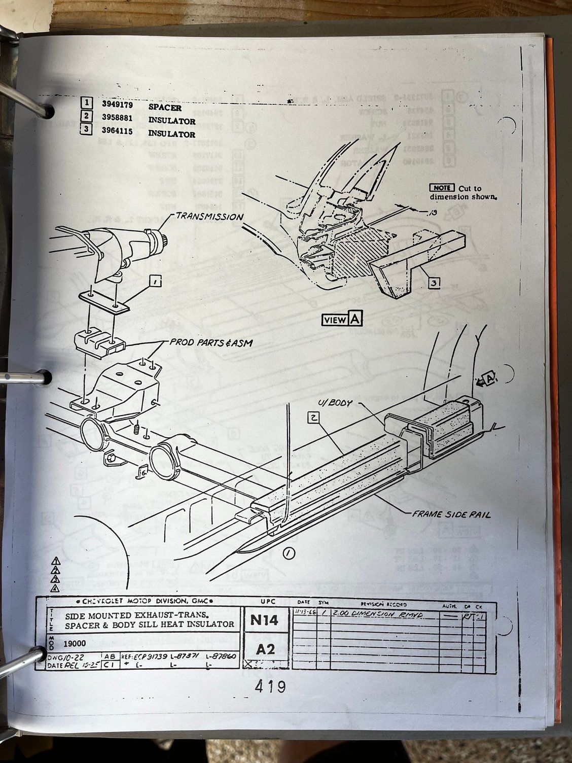

Here is the Assembly manual section on the N14 option.
Notice on page 421 the front fender has to be modified (cutout) a little bit to accommodate the pipes.
My car already had this done at the factory.
But these pipes look wicked !
Ps. I bought the whole system from Paragon.
Long post but I hope it helps you decide. Good Luck!
Mike

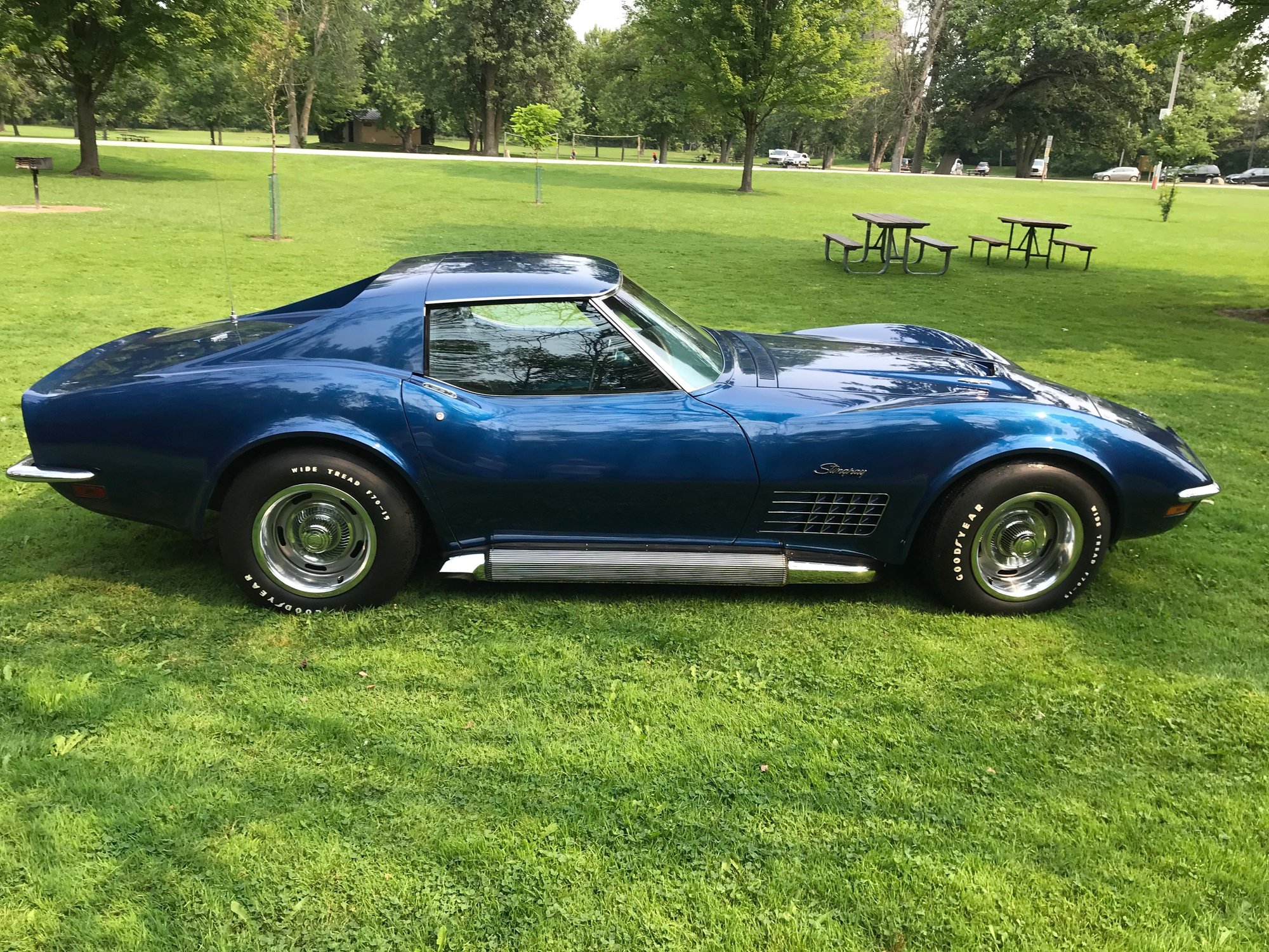

I converted my 72 in 1978. All parts are OEM, straight from GM. As I recall it only took a couple of hours to do. Those pipes are still on the car, so they've lasted 44 years so far. I've never regretted switching for one minute, they get more compliments than anything else about the car. At the time I wasn't sure how long these would last so I bought an extra set just in case. I still have them, they still have the GM part number labels attached.
