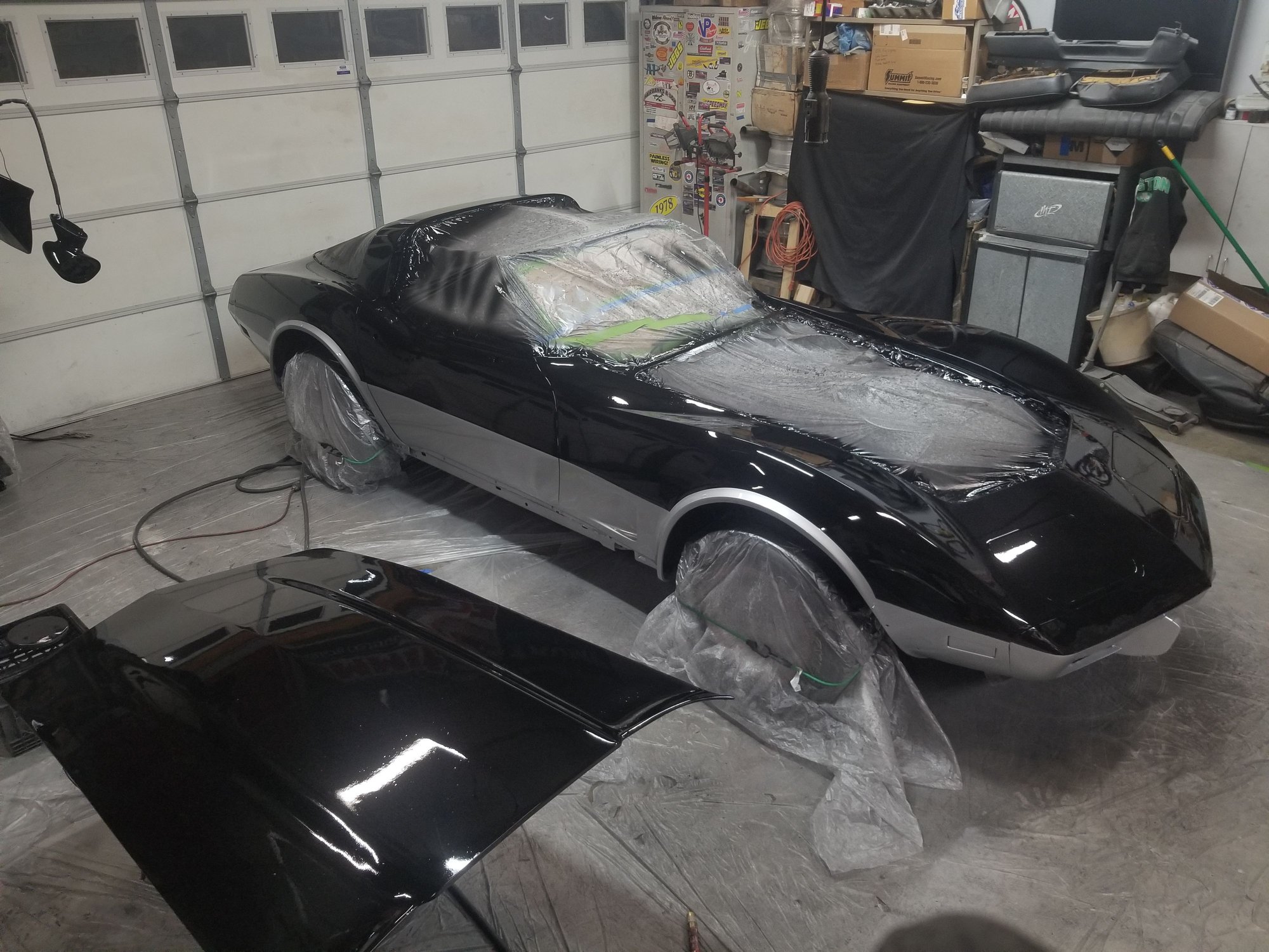

You don't need a paint booth to get a very nice paint job. Just spray a basecoat/clearcoat, and wetsand out any imperfections and machine polish the clear afterwards. You can get a show quality shine. My brother's painted his last several Corvettes (C1's) and mustangs outside. I've painted many vehicles outside over the years. The nice thing about a booth is you're not enslaved to 'good days' or daylight, and you have greater predictability. Of course lots can go wrong in a booth: E.g. a dufus come into the booth while yer spraying and let's the door slam(lots of dust released!). The hose comes unhooked and blows crap on the floor around. A light fixture goes out when yer spraying. That moth you didn't see dive-bombs into the reflection of the paint. I could go on and on. On a still day outside, esp a semi-cloudy day, it's great for painting.
I much prefer to paint outside anyways (when I can). The lighting is way better and no issues breathing fumes (still wear a respirator obviously). And a guy can line his garaage with plastic sheeting too and keep dust away.
Note: I would strip your car first before just spraying polyester filler on it. It's probably got several coats of paint on it. You can't just keep piling on more and more paint. Eventually it's got to be stripped down to bare fiberglass. I stripped mine in less than a day.

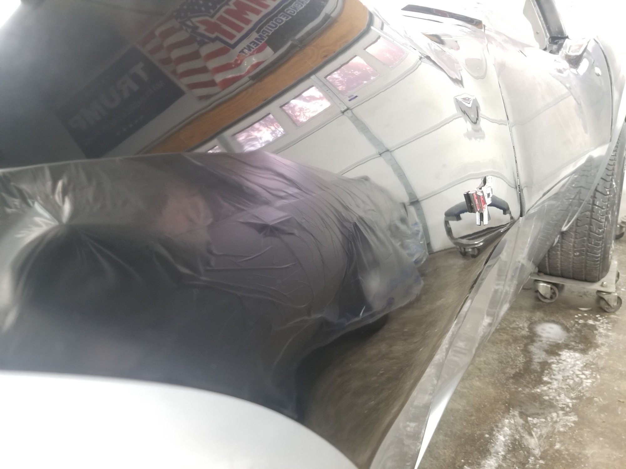

I just painted my car in my garage. Put plastic up along the walls and shut the garage door on a couple box fans to suck air out. Taped plastic around them to keep debris out. You can use big square house filters taped to the box fans to prevent contaminants from getting out into the air. Worked well for me. Didn't get hardly any debris/dust into the paint.

I paint my own cars, and it's amazing what kind of quality paintjob you can lay down for not a lot of money.
Just got done spraying my 78 Pace Car. Materials cost me $750 for quality Omni products. Wetsanded and buffed, and it's an absolute mirror. Most shops around here would charge $7500-10000 for a similar job.

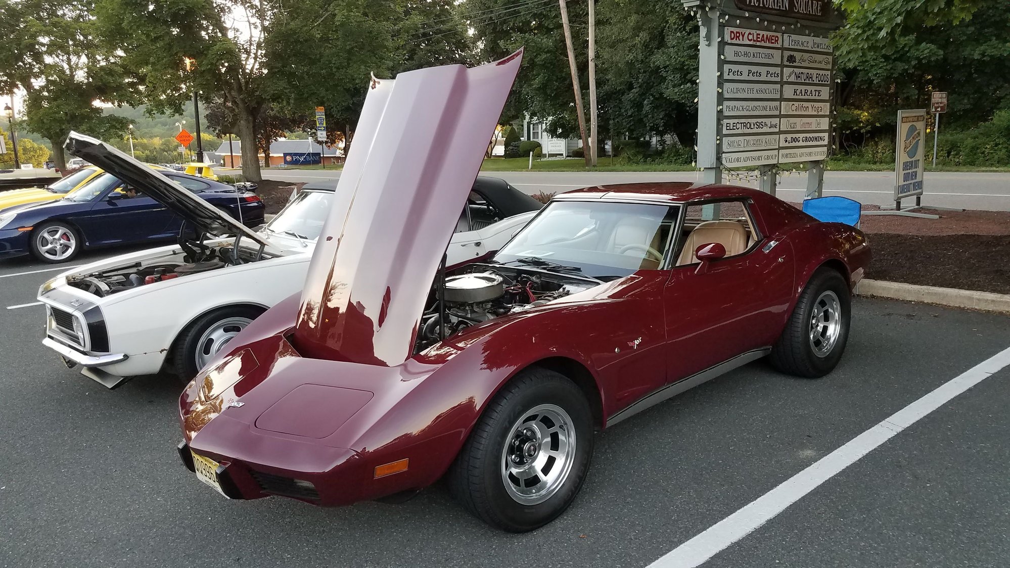

My friend painted my car in his (huge) garage, but still a garage.
Still holding up well after 18 years.

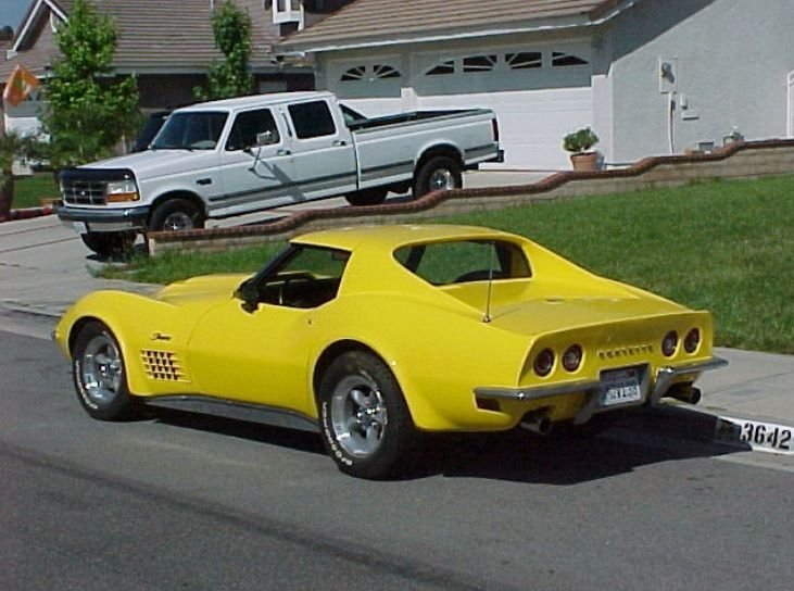

That was 17 years ago, still looks just as good, and it's not garaged either. Though the price of the paint has gone up, about $22 a quart.
