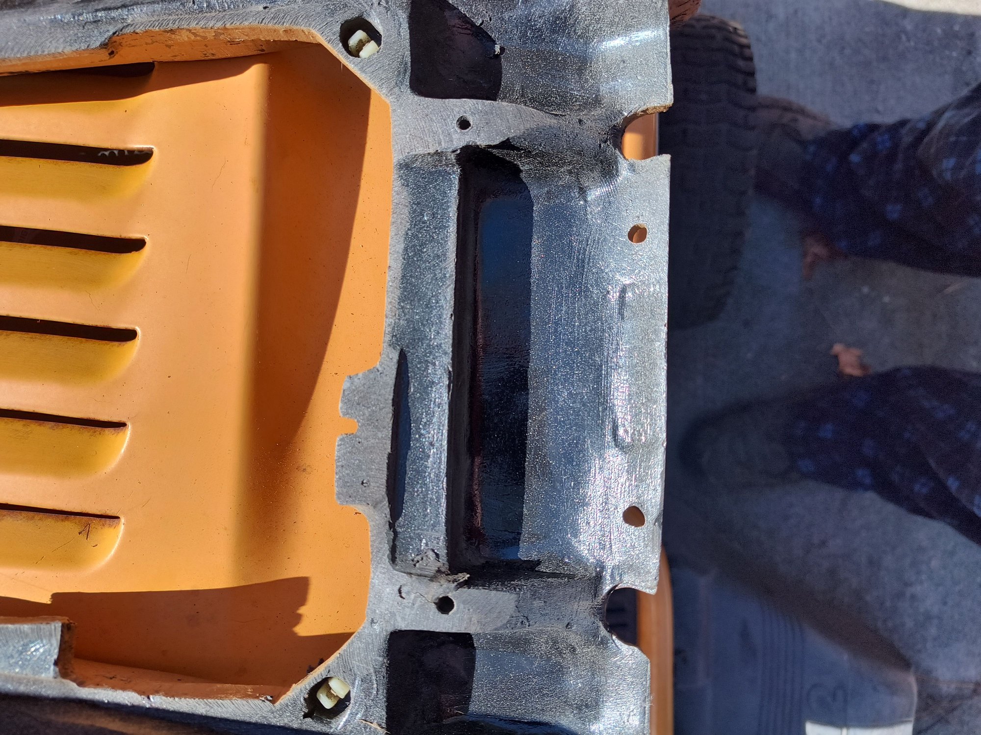

Is this a picture of the underside of a '73 center console? Mine does not have those metal brackets with the insert riveted into the underside of the console. There are two holes there but no evidence on threads in them and they are different sizes?

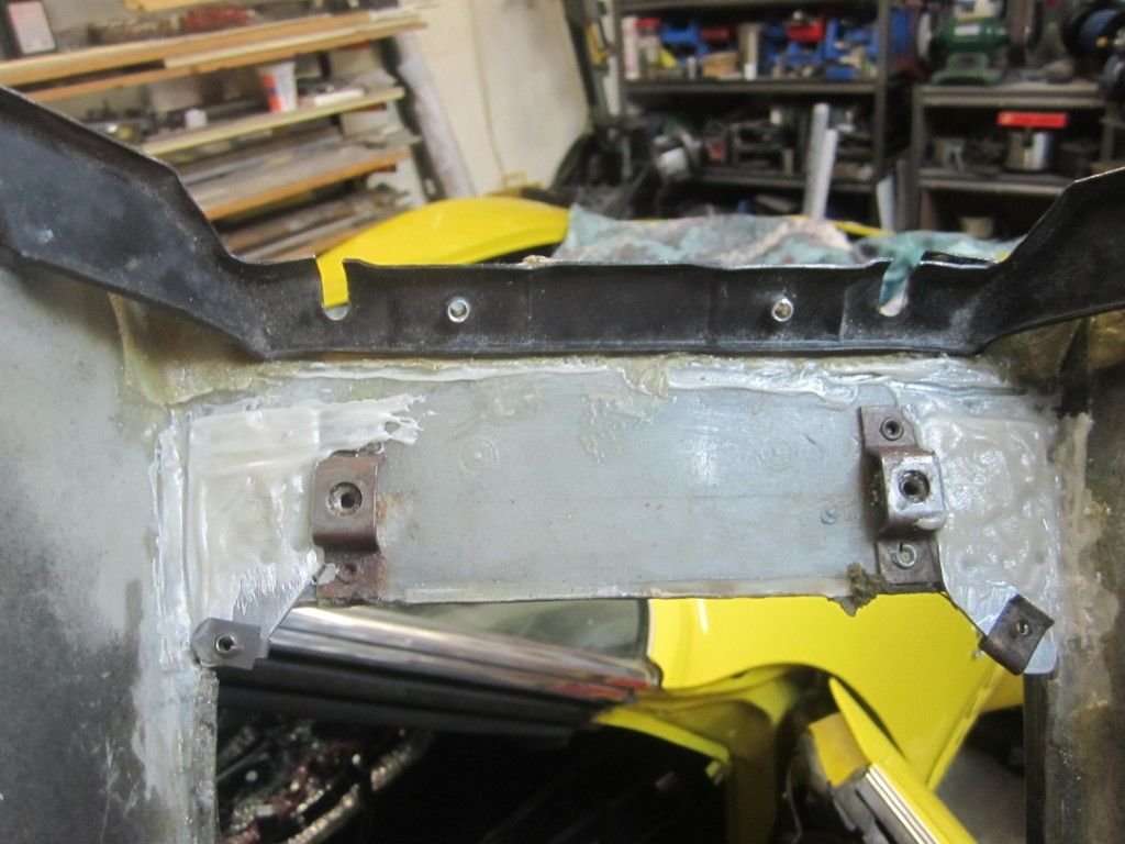

The 72-76 consoles should be all the same, 71 and earlier had the spot for the fiber optics so they are different, 77 was totally different
This was my old 72 console where I repaired the corners for the shifter plate, you can see the brackets on it.
Can you post of picture of your console in that area
M

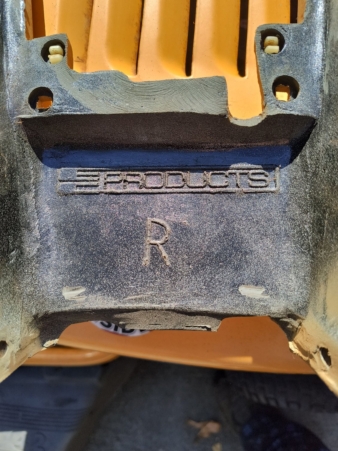

now that i'm looking closely, the second picture may be telling me that this is a reproduction console???? maybe i'm just supposed to use small self tapping screws into those 2 holes?
Old Jan 12, 2023 | 12:33 PM
Mooser's Avatar
Mooser
Joined: Apr 2011
Posts: 11,183
Likes: 3,335
Yeah that's not looking like a stock anything to me.
I'd guess they were using a self tapping screw right into those holes. I'd triple, quadruple check the depth, don't need to find out when you flip it back over

thanks man.............my question is answered , now to just solve the problem. I will use a depth mic on the holes and be sure not to poke through the other side

EC products has a website and I see consoles, maybe if you contact them they have instructions or a hardware available
M
There should also be a metal brace at the front of the console, it's riveted to those two hole what at the front in your picture, that's what actually supports the front of the console, which is what supports the center gauge cluster. Important piece

I do not have the metal bracket, but the console itself is pretty " thick & beefy" so it should hold up the center gauge console pretty well.
