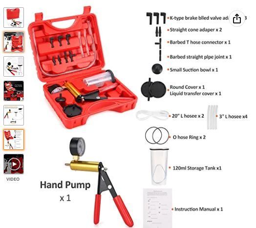

Hey,
I've replaced the front calipers, rotors, and pads. I never opened the master cylinder during the process, so almost no fluid came out of the hoses hanging loose. I didn’t touch the rear calipers at all. The brakes were working perfectly before I removed the front calipers. The reason I replaced the front calipers was because one had a leak between the halves, but other than that, there were no problems. Out of all the C3s I've driven, this one had the best brake functionality.
I just want to check: under these circumstances, would it be enough to just bleed the fronts? Start with the passenger side, then finish with the driver’s side (where the master cylinder is located)?
I plan to use this type of vacuum pump:
Thanks!

That kit is wonderful for one or two calipers.
However.
When you open a bleeder screw, do not open entirely. Open just barely enough to start a flow.
The less you open the bleeder, the less likely you will pull air around the threads.
It can be deceiving. You will have no idea if the bubbles are from a leaky bleeder screw or are truly from the caliper's internals.
If the bubbles continue appearing way longer than normal, remove the bleeder screw and apply anti-seize on the threads. Then continue.

Following up: The front brakes were successfully bled with a fluid change in that circuit. I ended up using all the brake fluid I had; there was no point in saving it. The hand pump was ineffective, as you mentioned—it was pulling air around the threads. So, I opted for gravity bleeding and was pleasantly surprised by how quick and straightforward it was! To ensure there was no air left in the system, I even had my wife assist by pressing the brake pedal, and indeed, there was none. This one was easy...
