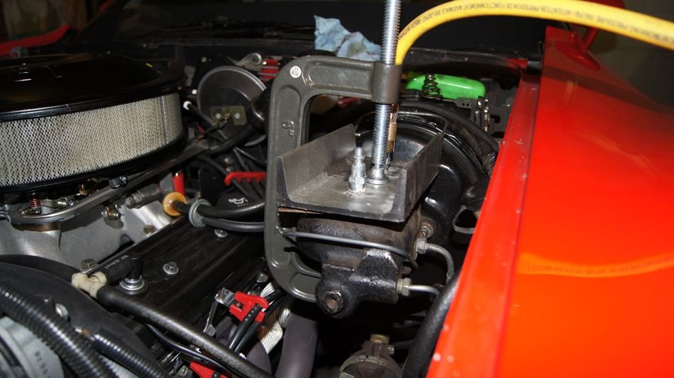

Buy a Motive Power Bleeder and be one and done, easy button. Use a C-Clamp vice the chains in the picture.

from lack of a helper to do a conventional bleed
I created a vacuuming method.
still use it combined with gravity and move a lot of fluid thru the system.
