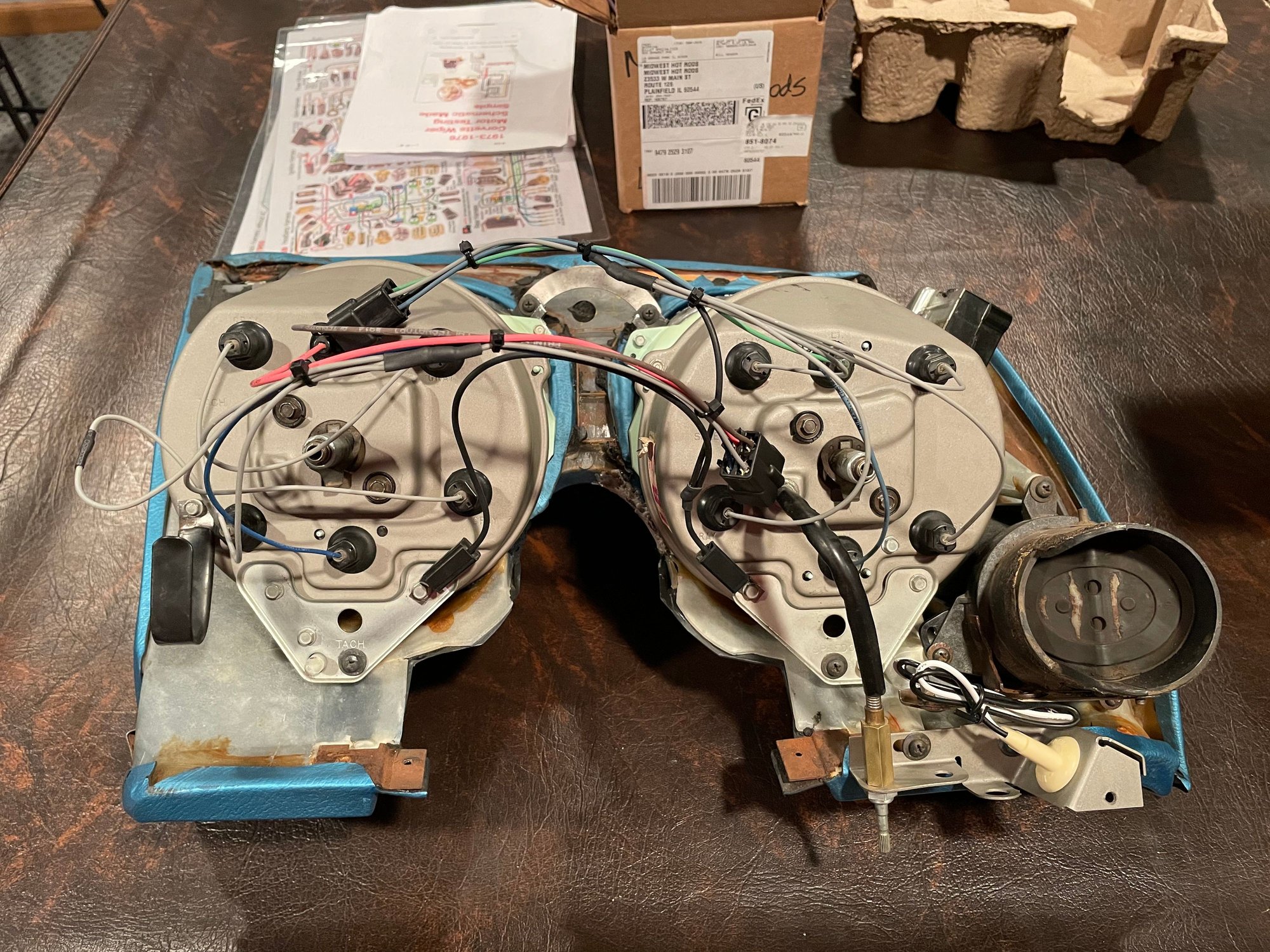

OP here with update. Dropped the steering column and wrapped it in rag. Top dash pad is out.
Went to install panel and wouldn't go in. Some pressure on the panel's sharp points on the column, and just issues with getting it in drove decision to pull out the panel and regroup. Next is removal of the column to avoid possible damage.
BUT, does anyone remember how the odometer reset cable routes in a convertible? Do you mount it to the speedo and the bottom of the panel and have it press into the bracing, or do you install it unmounted from the bottom and route it over the brace (as shown) and then down to the hole where it mounts? Thought it came out routed over the brace, but honestly could be wrong.
The YouTube video (bottom) shows the dash going in with the odometer reset cable mounted top and bottom, but then he has trouble getting it seated, which could be the reset cable hitting the brace.
Video where he mounts it and it looks like the odometer cable is pressing against the convertible bracing.

The odometer reset cable on my '69 was one of the major problems I had. I THINK the verts have a additional brace under there that is right in line with the cable.
options
1 delete the cable
2 delete the additional brace
3 bend the brace
4 keep fighting it
Good luck

Or do like, me and leave the rest cable hanging behind the dash panel, unintentionally. It took me about two seconds to decide not to remove the dash panel once I had the dash panel attached. After some extremely loud cussing I was able to unscrew the reset cable from the back of the speedo with a extra long needle nose pliers. With the
F ing brace, there is no way to get the cable attached and routed correctly, without removing the dash panel. I figure the next owner of my convertible can install the reset cable if he wants to tackle a monumental challenge. My trip odometer never worked so I never had to, or could reset the Dam Thing. Good Luck, and thanks for the video, I will save it in my archival files.
Still hoping someone can confirm if the cable, when installing the panel, goes over the top of the brace indicated in the pic above, or is installed top and bottom on the panel, and just get pressed into the brace and sharply bent down. Anyone recall how it goes?
