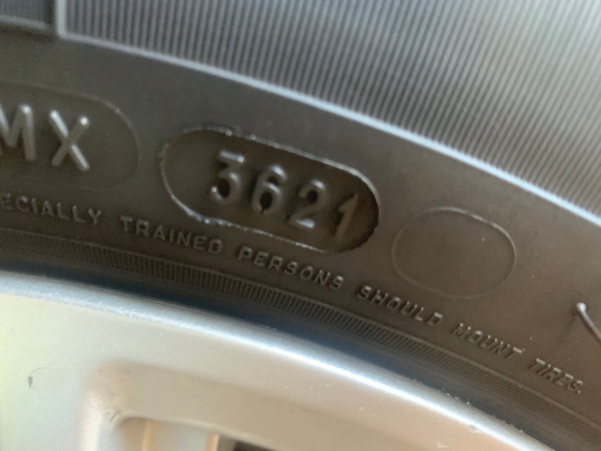

Can someone here tell me where to look for my tire's dates?
I have currently installed Firestone Firehawk Indy's from 4/18/09 and it's driven very little and can be called a Garage Queen which it really is...I probably don't drive more than 500 miles a year on it..
JJ78
This tire on my wife’s Mustang (pictured) is dated the “36th week of 2021” when it was made. They can sometimes sit in a warehouse for months, or in theory even longer for lower sales volume tires like our C5 tires.
When I get new tires, I always tell my tire shop to check the dates. I tell them I will reject any tire older than 3 months if they put that on my rim - especially for my boat trailer.
If you look at your spare, the dating codes were different back then. It took my 30-yrs in the business tire guy and me doing a lot of research to confirm the spare on my 82 was original. Of course I replaced it and kept the original in storage.
