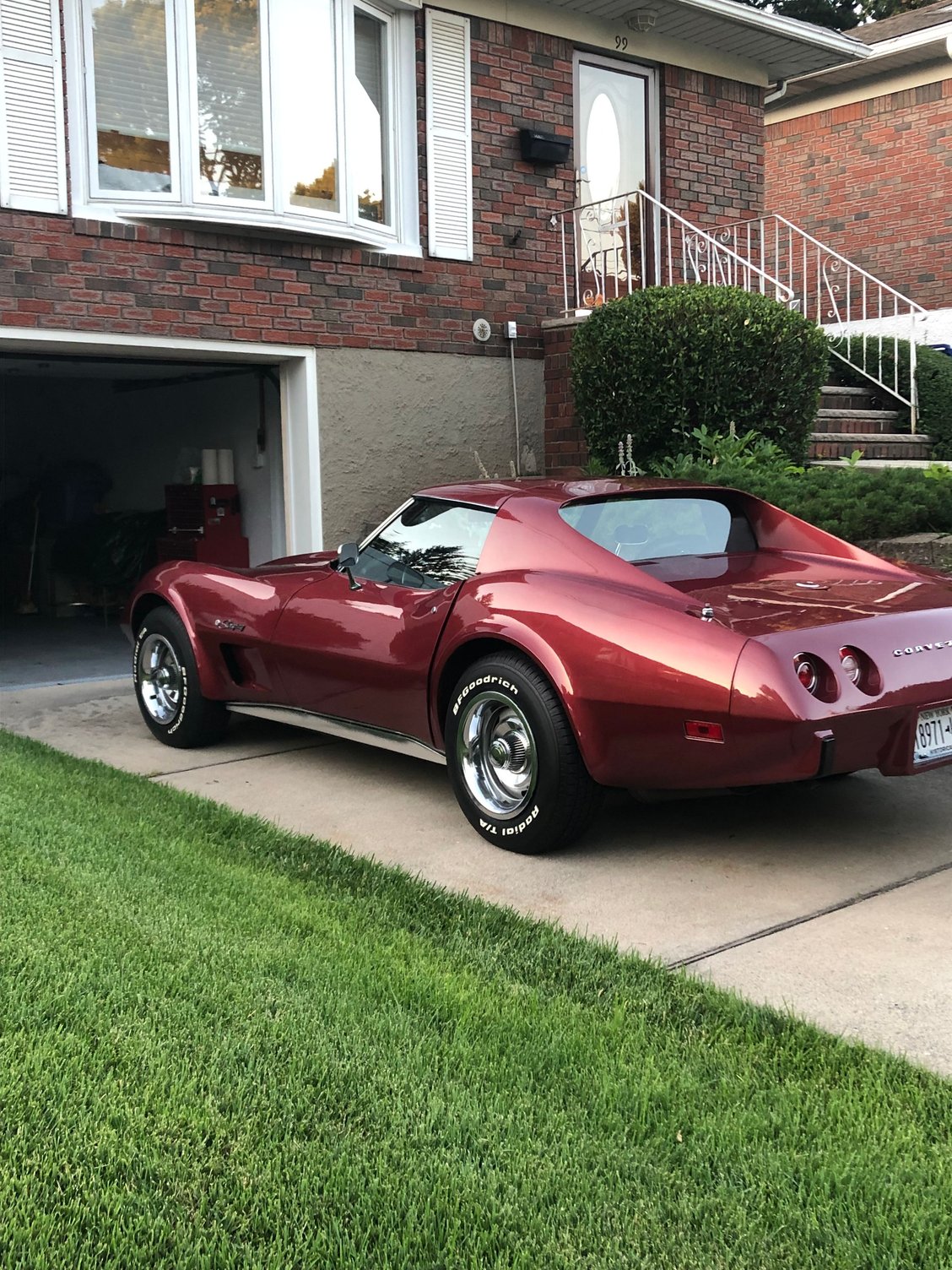

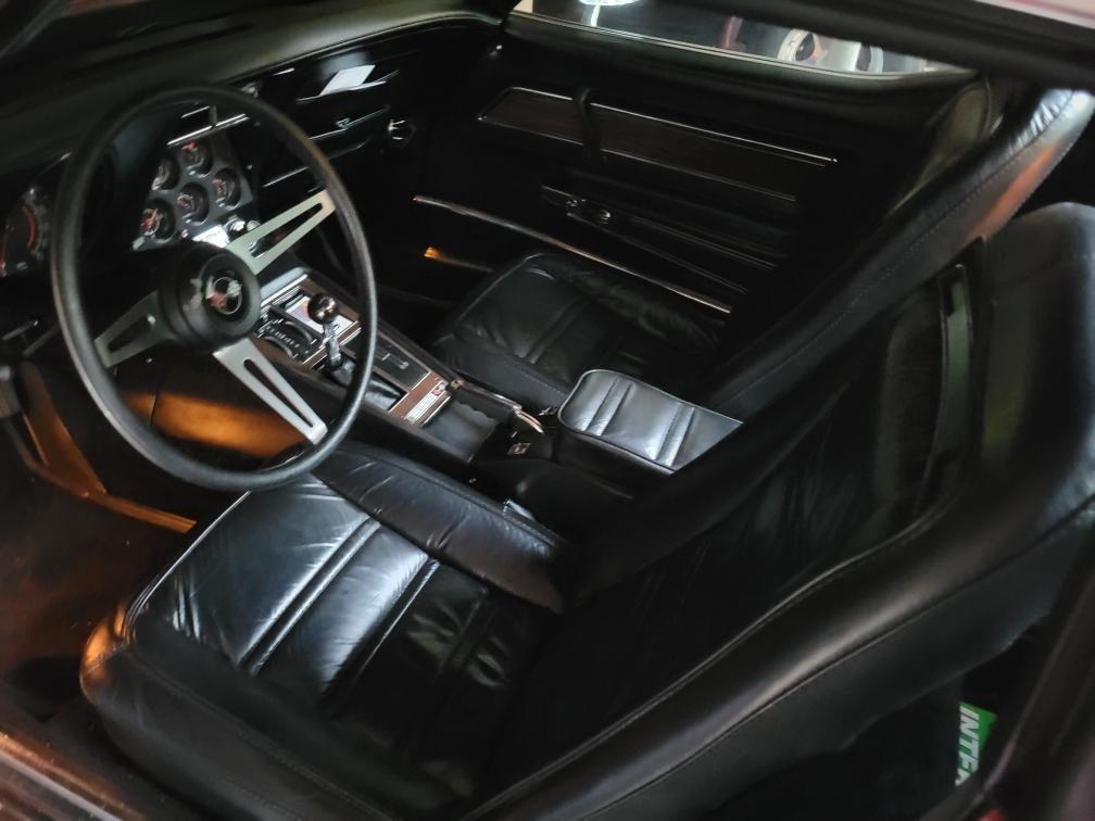

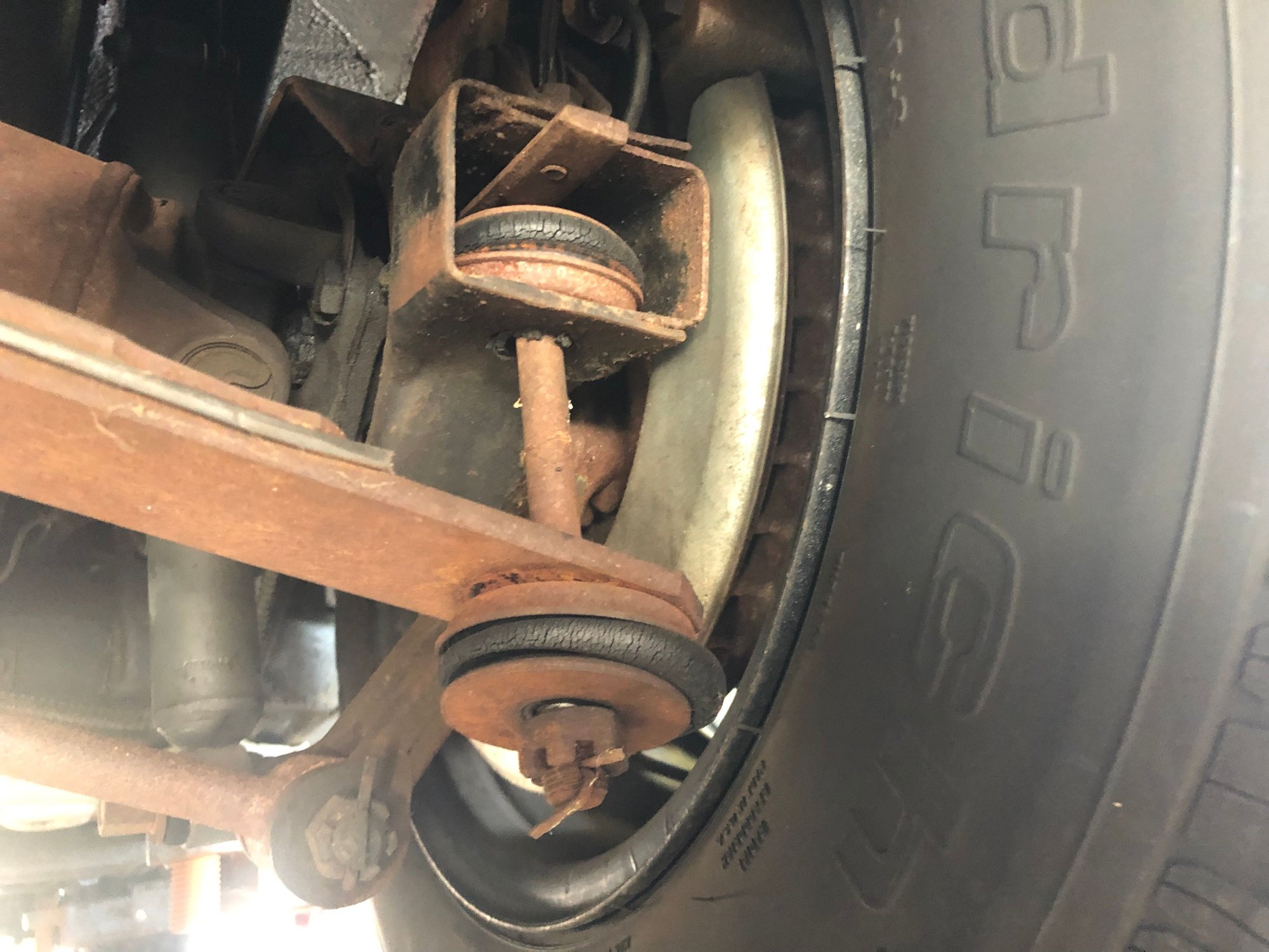

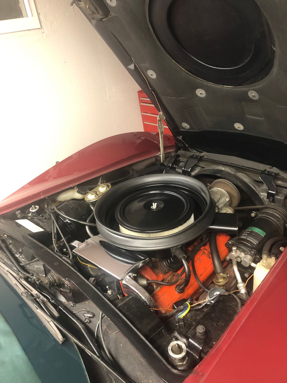

I bought an all original 1 owner 75 with 9k on it .. I now have almost 11k on her .. my advice and experience is don’t fix what is not broke . Heck I still have original wires plugs distributor and cap and she runs great. Don’t start changing part’s because “they’re old “ . If the car was taken care of they are fine . This
is what I did …
Flush radiator
changed thermostat
changed all belts
changed hoses
changed oil and filter
I didn’t changed trans or dif oil check level . With such low miles it doesn’t need it
new tires
my advice if it is a safety issue fix it , but if the car is running well leave it alone and repair parts only as need be ..
