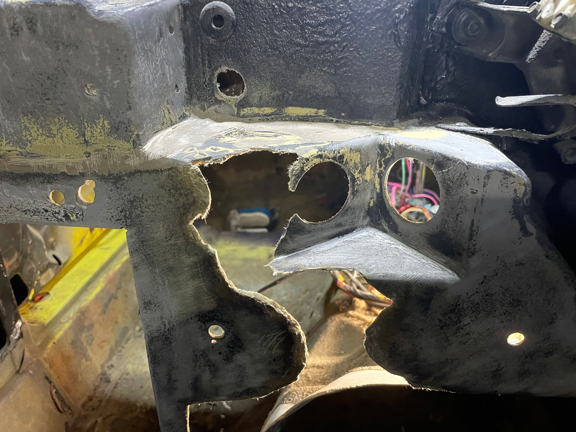

While I’ve been waiting on parts to come in, I finally decided to tackle some firewall Reoairs I’ve been putting off.
Some previous bubba owner obviously had a small engine fire which had burned a good bit of resin on the firewall leaving me with oil soaked fiberglass fibers.
After removing as much of the old fibers and delaminated fiberglass, I ended up with a decent sized hole in the firewall.
Being a newbie at fiberglass work, I did a good bit of research, and ended up ordering West Marine’s SMC epoxy resin and hardener in the pump cans.
After much tedious work, and probably close to 8 layers thick, here’s my repaired firewall.
I still have yet to do some sanding and use body filler to smooth out the repair.
I am doing an AC/heat delete as well, and have ordered a delete panel off flea bay to close in the hole left from the heater core.
If I had been a member of this forum BEFORE jumping into a basket case project, I would have looked more closely at the tell-tale problem areas.
FORTUNATELY, this has always been a Georgia car, and, for the most part, I have been very fortunate to not have any major rust issues besides the core support and one of the #4 body mount reinforcement brackets.
I know my fiberglass work is far from professional looking, but I was not about to replace the entire firewall.

One question I have is the grommet hole marked that I had to glass over for the repair. There was a rubber grommet in the hole with a few wires going through it. Early on, once I decided to replace the whole wiring harness, I ended up cutting those wires since there were bubba splices done to them.
Any help on identifying the wires that go through that grommet would be helpful as well!
If I remember correctly, the tach cable goes thru the other hole to the right of it.
Thanks!

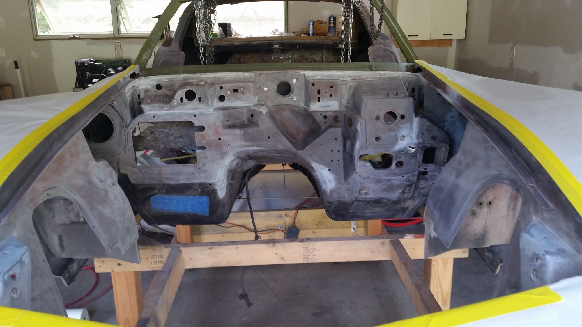

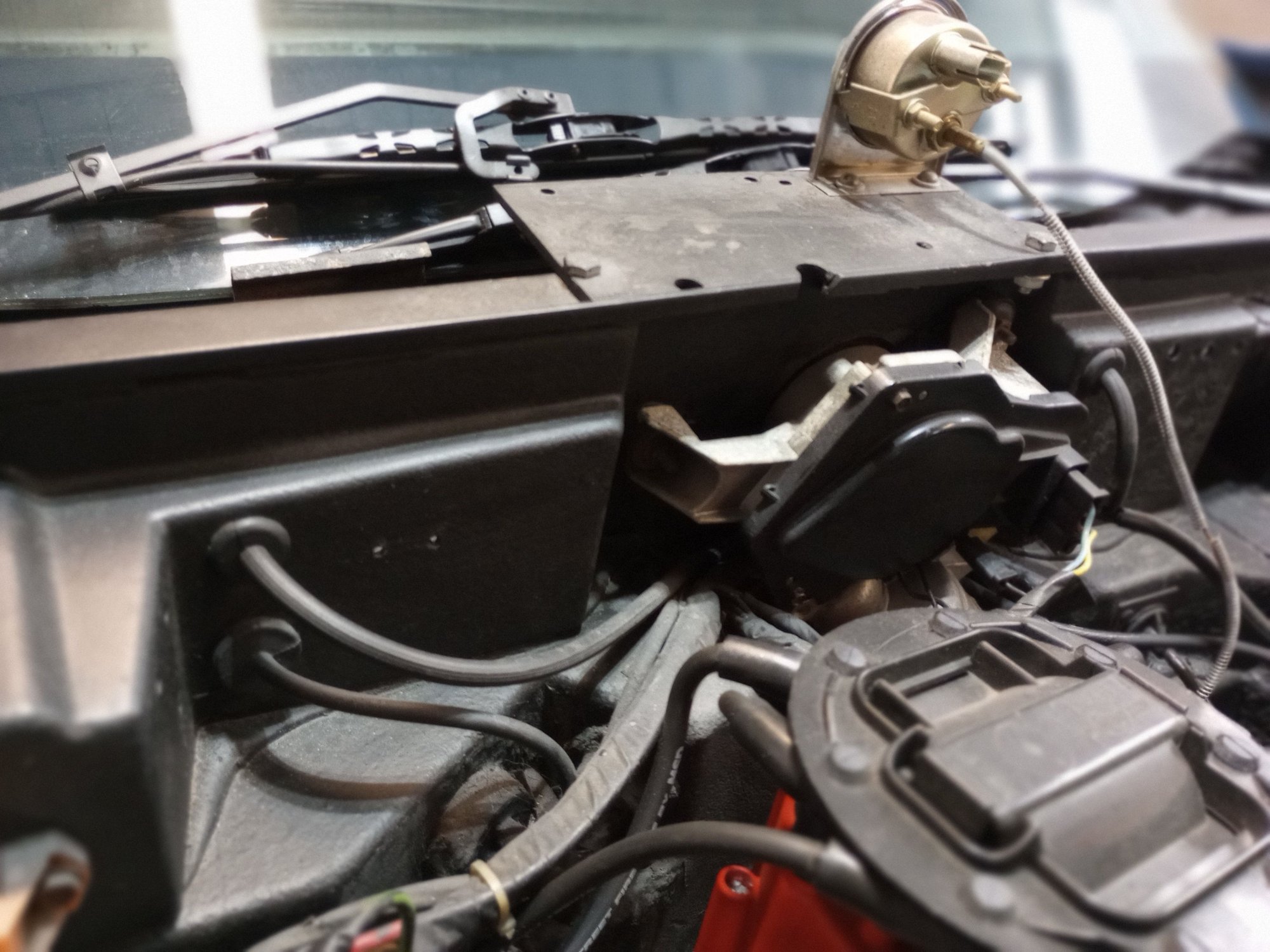

Hard to get some decent pictures of the firewall with all the stuff there, even with the valve covers off, let me know which item to trace out for you.

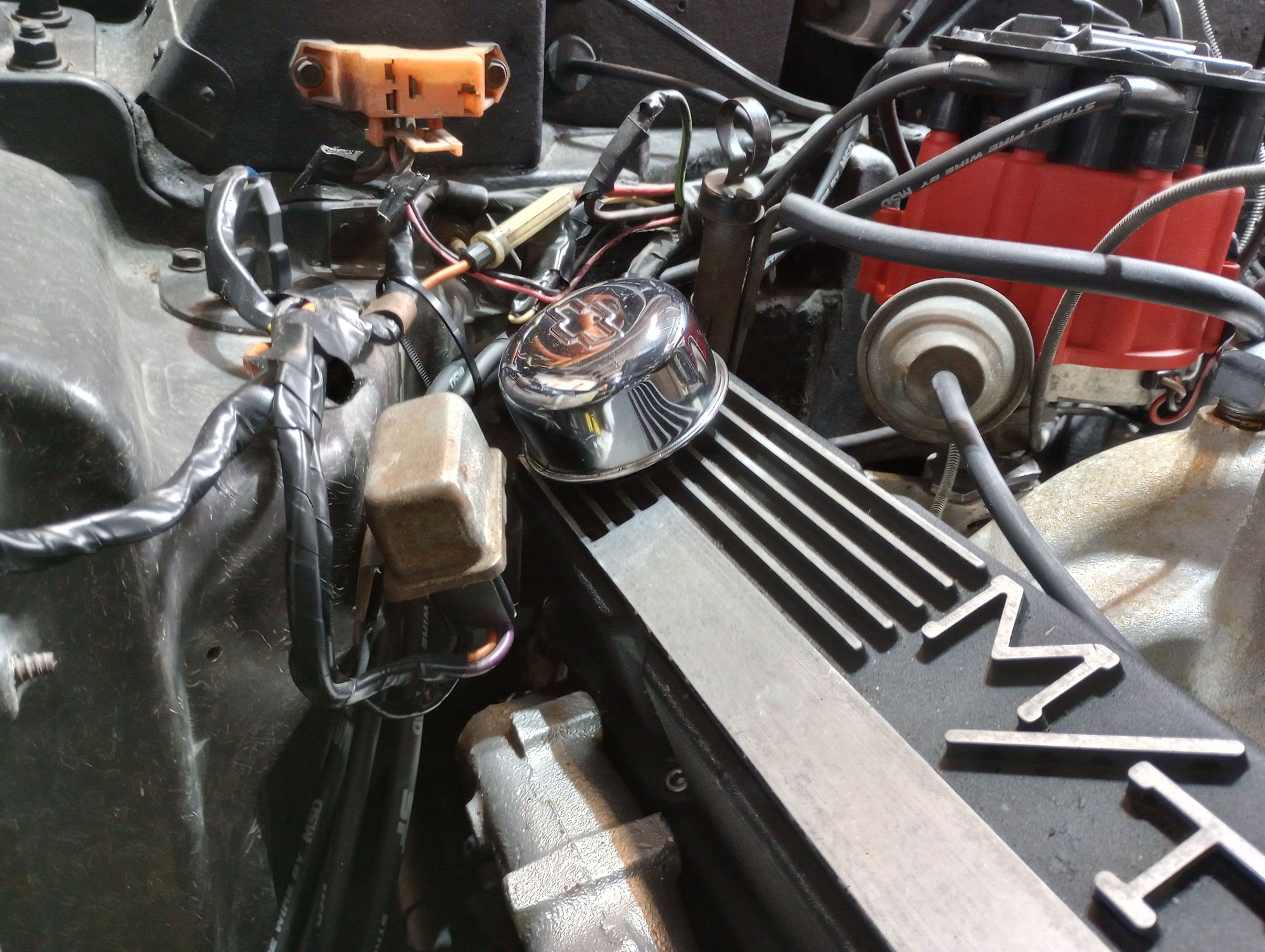

The hole you have circled is a vacuum distribution block i think, i traced the line and it goes into the wiper cowl area and then down on the passenger side to somewhere. You can see where the lower line on the left side goes into the wiper area.

Another member sent me this pic...I hope it helps you........

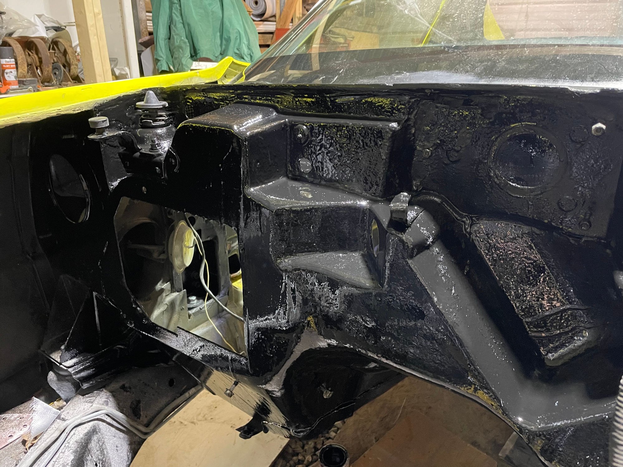

I got the firewall repairs completed, and painted in POR15. Yes, POR15 works on fiberglass too.
Welp, here’s the completed firewall repairs, plus I did a major overhaul on the wiper trough as well.
Why not? While-I’m-at-it…..
Now to install the ac/heater delete panel.
Looks good as new. Waiting for a new(er) wiper transmission setup. What color should I paint the wiper parts?
PS: After zooming in on the pics, I’m not sure I like the glossy firewall. The reflections make the paint job look horrible in the pictures.
Maybe I’ll topcoat in a semi gloss or matte paint? Any recommendations?

IF you drive in the rain ONE time, Mother Nature will put a Satin finish on theGloss paint for you.
Just be sure the new layer of Satin paint will NOT peel off if you go that route.
(cameras never do justice to gloss black "on anything" except the body)

There is another way to not be so bothered by the glossy finish on the firewall. Close the hood. But in truth, that is some very good Glass work. And the glossier it is the less stuff sticks to it.
