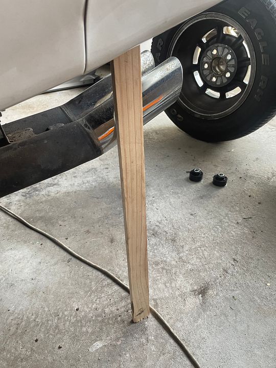

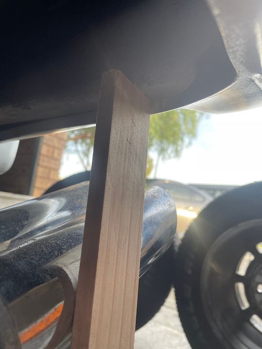

Not really but what I should have done and I eventually did was jack up the back of the car from the bar that runs along the bottom on the rear bumper. I realised that although I’d undone the bumper to the frame as I jacked it up it didn’t move and that’s how I ended up with the stress cracks. I can take a picture tomorrow if you want
Old May 11, 2023 | 07:51 AM
  #143
4-vettes's Avatar
4-vettes
Posts: 13,193
Likes: 7,793
Cruise-In VIII Veteran
Actually that would be greatly appreciated. I was wondering about supporting the nose as well.

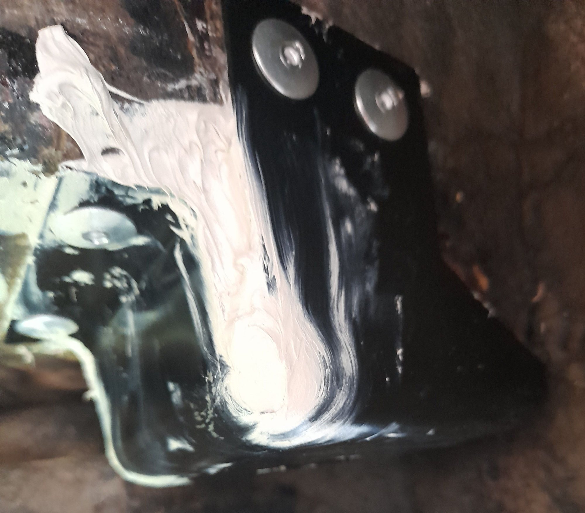

And I have both number 4 reinforcements !
I poured resin into both number 4 mount pockets tonight to level out the floor so my rectangular steel inside supports have a flat surface to sit on and of course fill in the busted out holes. I will install the new reinforcements with a urethane sicaflex and aluminium pop rivets. Should be stronger than new.
I am still working on all the front and rear bumper support bolts. Most everything else is done. Still want to clean out the number 2 mount areas in the bird cage. So a bit to do yet before the lift.

Got both number 4 reinforcements done today. White stuff is a urethane Sicaflex. I didn't care what the colour was. I will be spraying undercoating over the top of them as well. The urethane Sicaflex will not only add strength. But also help keep out water and debris which is what rusts out the originals.
got the drivers side raised up today. Changed out all the mount bushings and set it down. Was a big day. Tomorrow or the next day I'll raise the passengers side. Then I may have to do it a couple more times till I get all the shims just right.
I also cleaned out the number 2 mount areas in the bird cage. Was very pleased with the condition of my birdcage. I sprayed some rust converter in there as well, mostly just because. But they looked great.

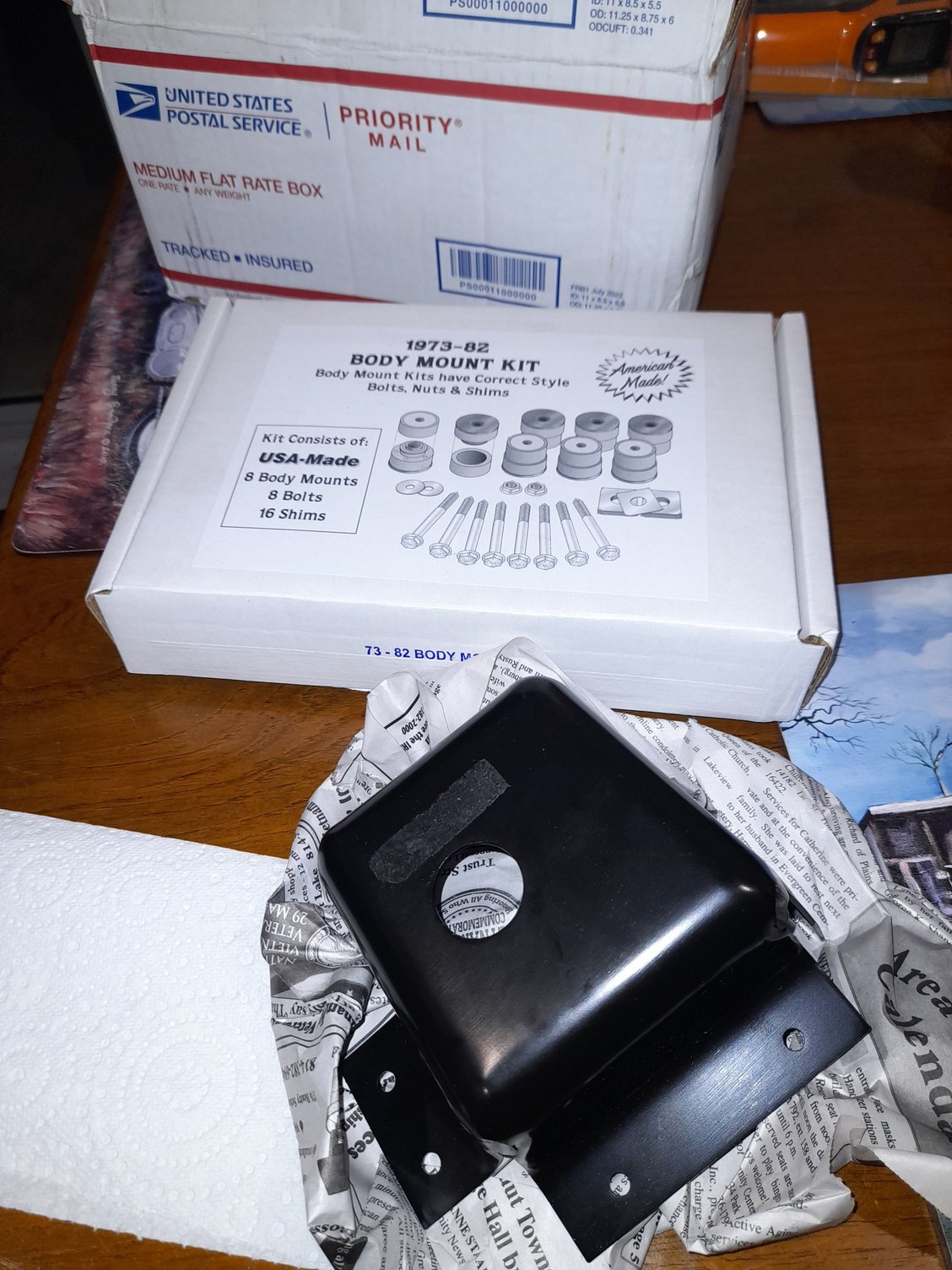

Sooooo I called the place I’d order the parts from and they told me it was going to be another 2 weeks so I cancelled the order and ordered if from another supplier and had it in my hand in 2 days.
When I looked at it I realised it was a right and not a left!!!!!!! I called the shop and he did I could come over to his house on Sat morning and swap it.

No cracks Mate. A floor jack on the rear bumper, a floor jack on the front bumper. A scissors jack on the side. Raised the side a 1/4 inch. The rear 1/2 inch. The front just supported. Did that in increments. Passengers side number 3 was a bugger to get out and new one in. But otherwise went smoothly. Not removing the 4th bolt up front meant lifting the body not just side to side, but the rear up and the front pivoting on the one remaining bolt.
last night when I put it down I had a large gap at the number 4 mount drivers side. Today the gap was gone. This afternoon I did the passengers side. Large gap at number 4 again and small gap at drivers number 4. So I'm letting it rest and will start tightening bolts tomorrow. If I need to reshim, back up again
They say to count your shims. But the new shims are thinner than the originals. So I went on thickness not count.
As of right now, door gaps look good. Doors open and close perfect. Yes door bushings are in great shape.
Time will tell. I'm not rushing this. Not a job I want to do again so I will let it rest. Tighten down 1 and 2. Check my gaps and fitness. Then if good. Tighten down 3. Then 4. If any door gaps are out or rear bumper alignment is out. Back apart to reshim.

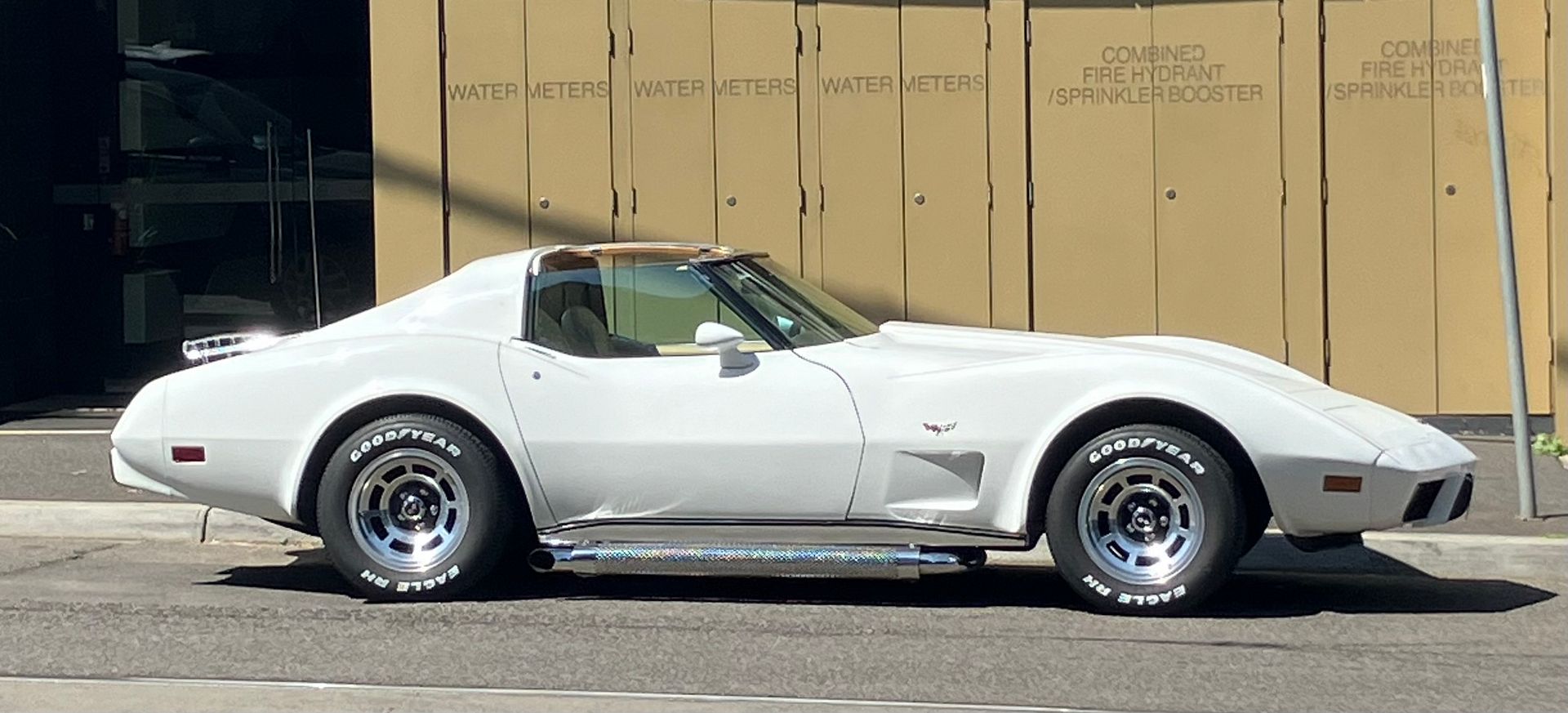

Been a while since I’ve posted which probably means I haven’t had any problems for a while. Thought I’d post an updated picture on how it looks now.
I love this car
