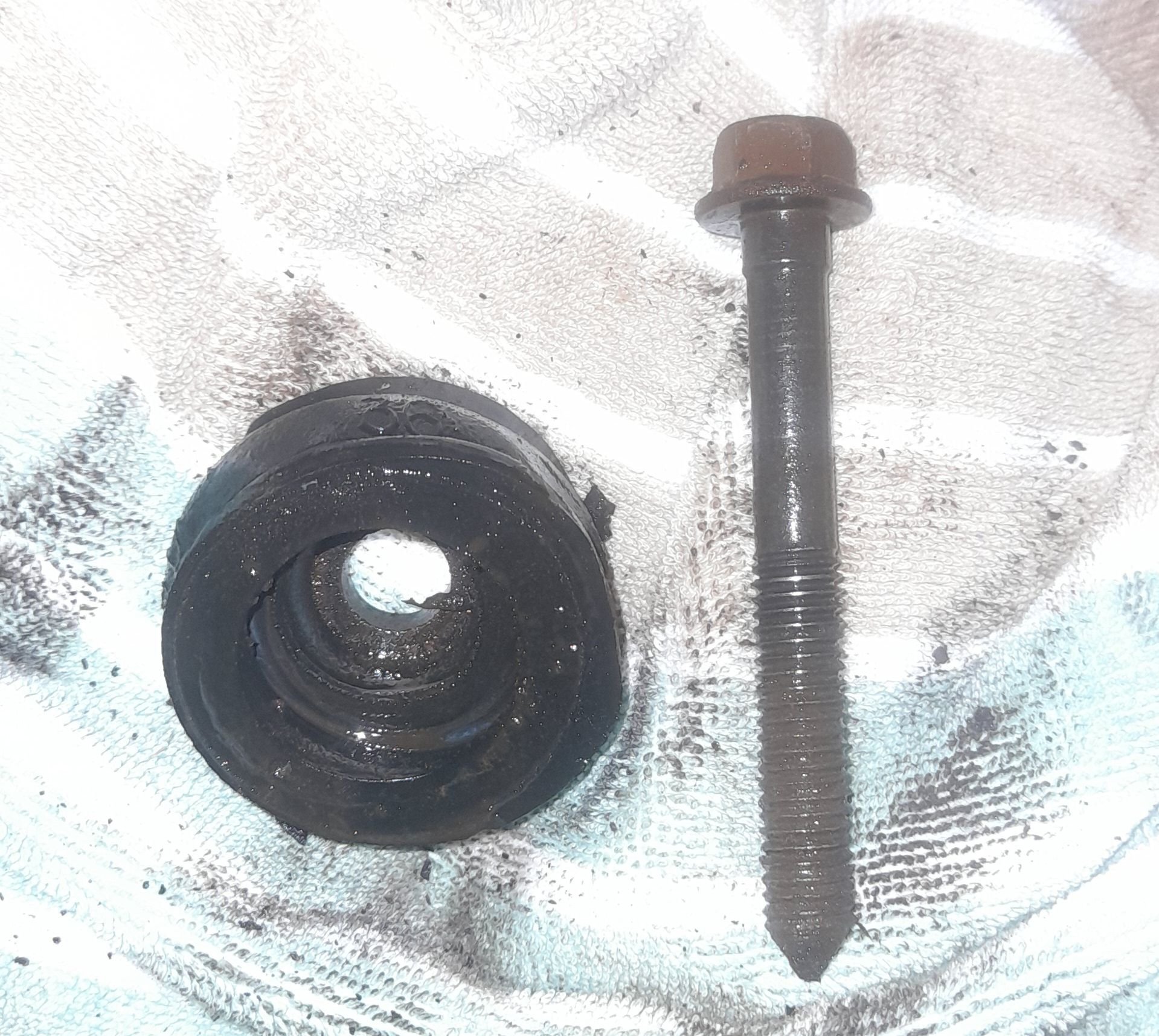

Tonight I got that number 1 passengers side bolt out that I snapped off the other day.
Just look at it! Boy did I ever have to wail on it!

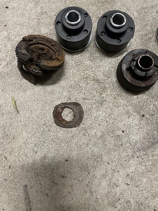

UPDATE - one side is all back in with new bushes. Not bolted up yet.
Second side is jacked up and the bushes are now out. Tomorrow night I will clean up the mounts and paint them with fish oil.
Im still waiting on the body protector mount for the drivers side but I can continue with the other bits.
4 Vettes the little plate I cut is 6cm x 6cm with the edges cut off. Not perfect but it fits in there.
Old mounts and new

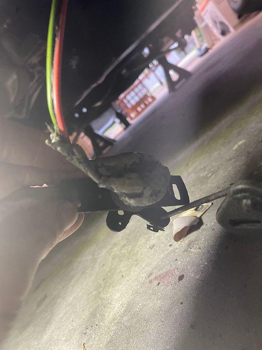

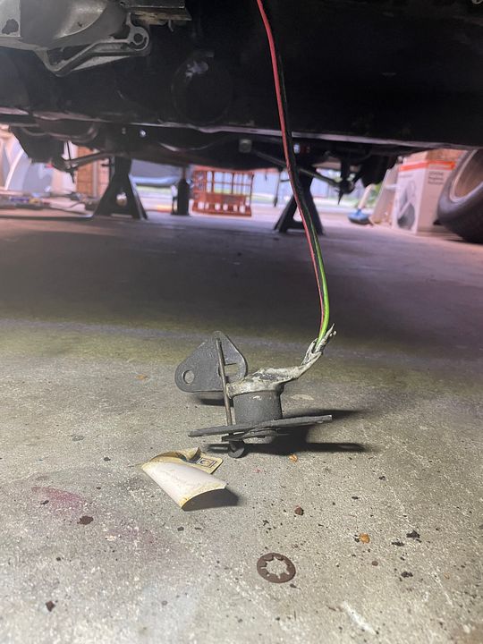

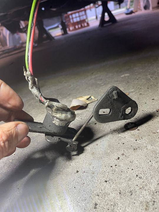

can anyone tell me what this is? I found it up on the chassis rail.

I'll google it and figure out what 6cm ×6cm means.
as per the switch. I've owned a 77 for 35 years and I am not recognising it. Where on the car? Photos are unclear as per location. Left hand front behind front wheel alarm switch, but doesn't look like my alarm switch. Sort of looks like backup switch but not really.

You could be right. It’s on the drivers side and was sitting up on the chassis rail behind the wheel.
I found it as I was removing the steering box to get the rag joint out

I just searched corvette central for switch which is what that thing is and nothing that even looks like it comes up

So whatever that thing is the wires run up the back of the engine and join this connector which has one green and one red with white tracer wire on the other end that run back into the wiring loom.
I’m intrigued. It’s going to keep me awake tonight now

So I’ve worked out it’s the reversing light switch.
Now to find out where it goes and how it works!

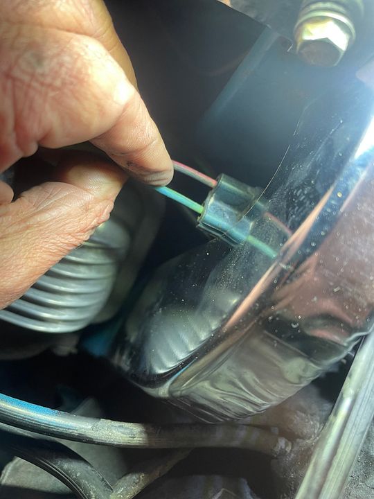

4 speed? Left side of trans. I'll take a picture tonight after work as mine is up on jackstands at the moment.

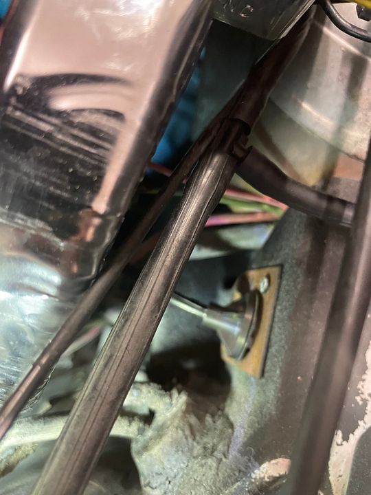

OK, tryed to get some photos but some idiot put an exhaust pipe right in the way. These are the best I could do.
From directly underneath.
Looking between the floor pan and the pipe.
I know there not great.

That answers two questions.
My reverse gear shift link was home made and what I found was the reverse light switch which was attached to the shift lever.
I’ve connected it all back up now and once the car is back together I’m sure I’ll find out what they disconnected it and made a home made shifter!
