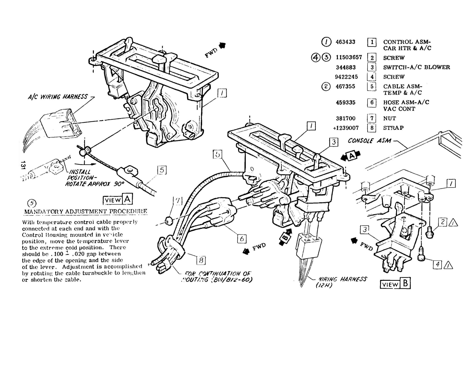

Replaced the heater control unit in the console and the cable and after pulling it backwards and forwards 3 times the cable pulled out of the plastic again. Any bright ideas on how to keep it in there. Seems like unless the cable is straight it doesn’t want to comply!

Are you installing the cable correctly?
Disconnect the cable from both ends.
Insert ball end of cable into slider lever cavity just like the assembly manual says.
Then rotate the cable approx 90*.
Secure cable at both ends...
Adjust cable.
You can see both sides of the lever at post #60
That's how the ball end locks into the lever.
I had the complete shift center consul out for other reasons when I learned how it was installed.
And then saw the assembly manual instructions much later....

Yep got the manual and installed it as per the manual and when the cable is laid out straight it sits in perfectly.
As I start to bend the cable into place it turns the ball slightly and it pops out
