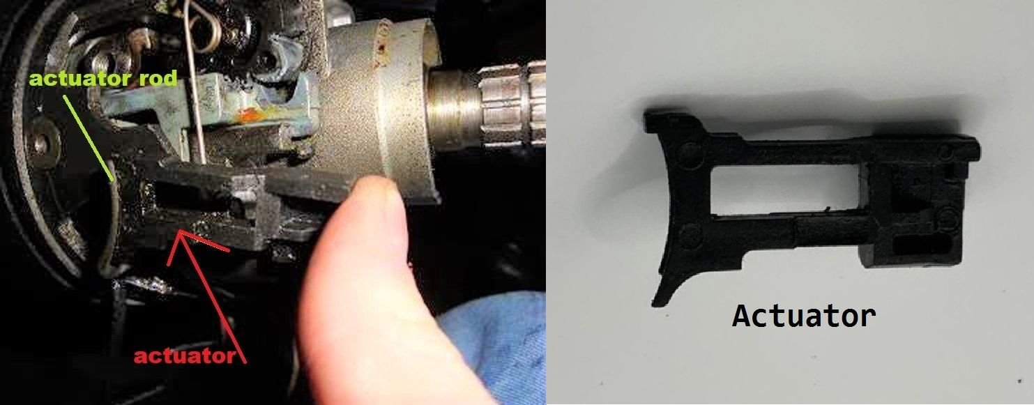

Here is a photo of a later Corvette dimmer rod end and where it presses on the actuator.
It is labeled actuator rod in the photo.
This should give you an idea of some of the parts involved.
The foot operated dimmer switch was used up until 1976.
77 was the first year for this, thus GM called it the "Smart Switch"... Wiper/Washer/Dimmer Actuator bla...bla...bla...

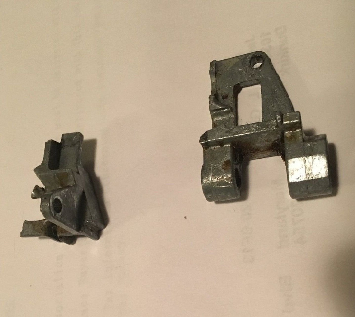

Got it, something is clearly broken. What goes on the other end to the plastic piece?
Here's some pics Greg and we could become best friends 4-Vettes

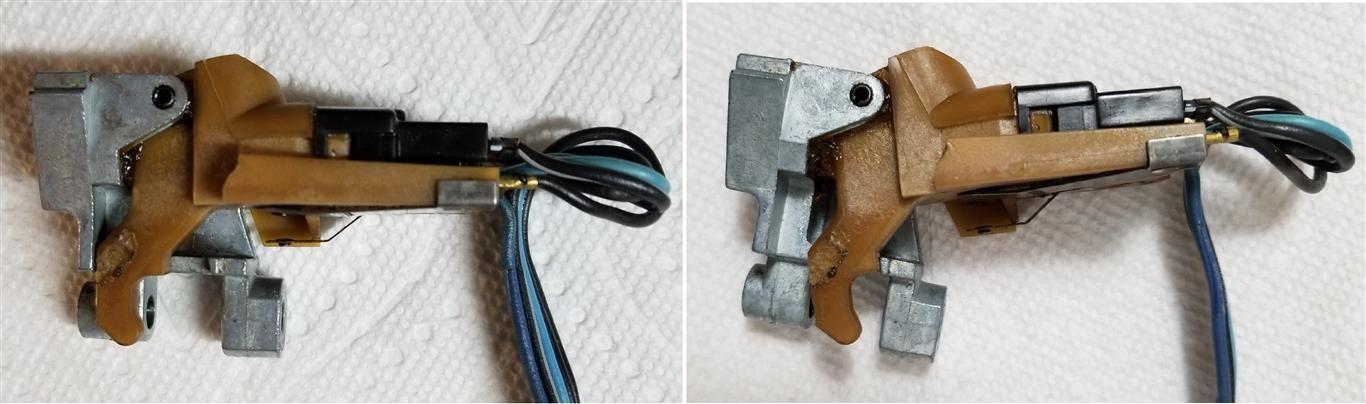

There is a, I will call it the finger that is part of the "Smart Switch" that is in contact with the black plastic actuator.
The actuator is in contact with the dimmer rod.
When you pullback on the turn signal lever the finger changes positions, the switch just pivots some in the pivot bracket.
Photo on left is of the finger in the home or normal position.
Photo on right is finger pushing on actuator, rod, dimmer switch.

Does your turn signal lever feel like it is not connected to anything secured?
I will go out on a limb, worst case scenario broken pivot bracket.

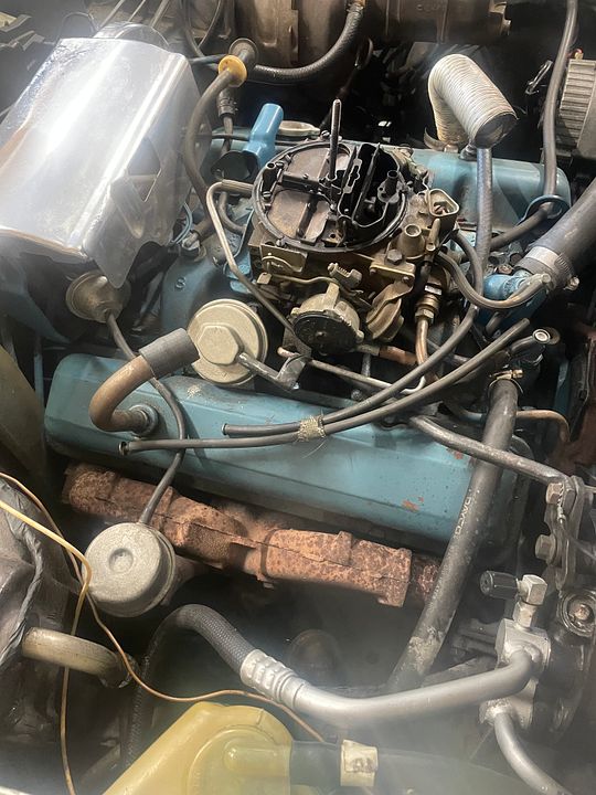

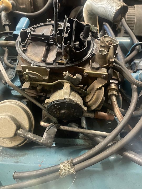

Took the air cleaner off last night to find hoses blanked off all over the place and the choke on the carb is no good. Some has glued on the little plastic cover that fits over the spring. More photos for viewing pleasure.

Yes I see someone has disconnected unneeded emissions stuff and EGR. But didn't bother removing said unwanted parts leaving behind a less than tidy engine compartment.
Mine, Also a 77.
None unused vacuum lines and no choke. (No Quadrajet). Among my many threads on here is my how to thread on fuel injection. (77 EFI Conversion) if your interested.

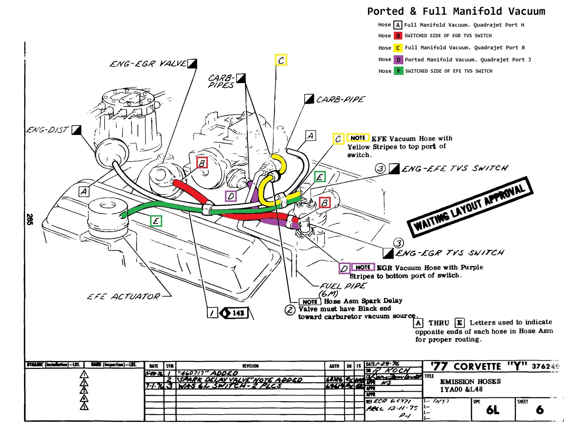

Here is a colored diagram with ledger in top right hand corner of the hose routing for your 77 L48 when needed.
I can tell you right now the vacuum advance hose connected to the EFE actuator is doing nothing...

A few tips; Line A in diagram above should be vacuum advance to manifold vacuum on
back-saver
front of carburetor. Currently attached to EFE.

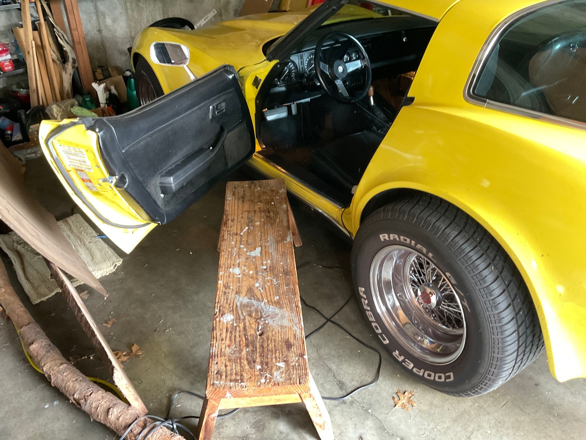

Slow pop-up for headlight. originally all self-lube plastic bits, but they get sticky eventually. Try spraying all the pivot points with the newer plastic-safe WD-40 type spray lube. if still sticky, check vacuum.
Place a bench at floor level outside the door to lie on while working under the dash.
