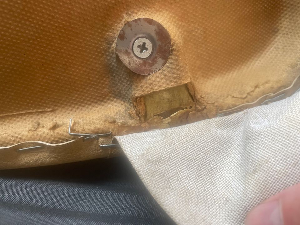

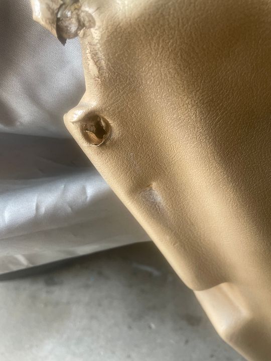

I'm just waiting on the lock pin tool to arrive before I continue with that so I thought I'd do an easy job.
The door trim has had a rough life.
The hole in the top left hand corner has seen better days and I know why the bottom right hand corner was floating around.

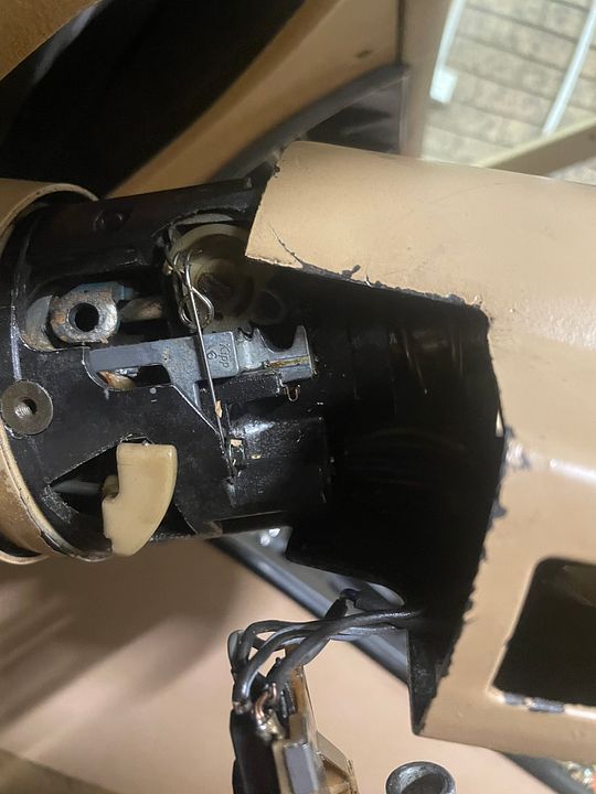

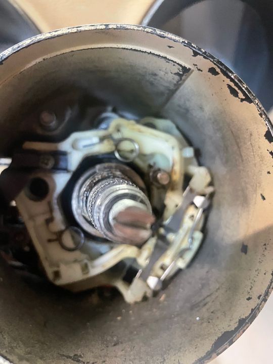

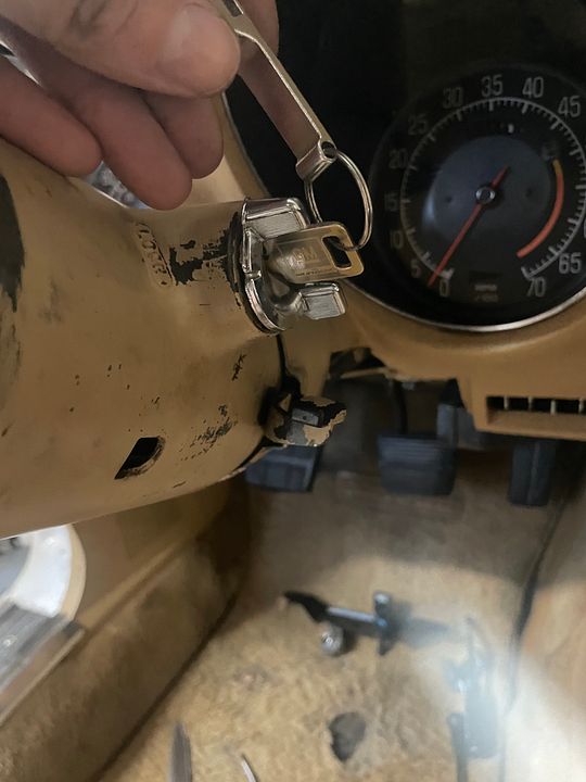

Ok I give up.
Got everything off and I’m trying to get the switch out.
it seems like I need to get the ignition switch out to get the cover off and despite watch 18 You Tube videos it won’t budge
None of the videos I watch have this lever at the back. I’d is that my issue?
Heres what the turn signal looks like. When I took the metal arm off the top it went all the way to lock the indicators on

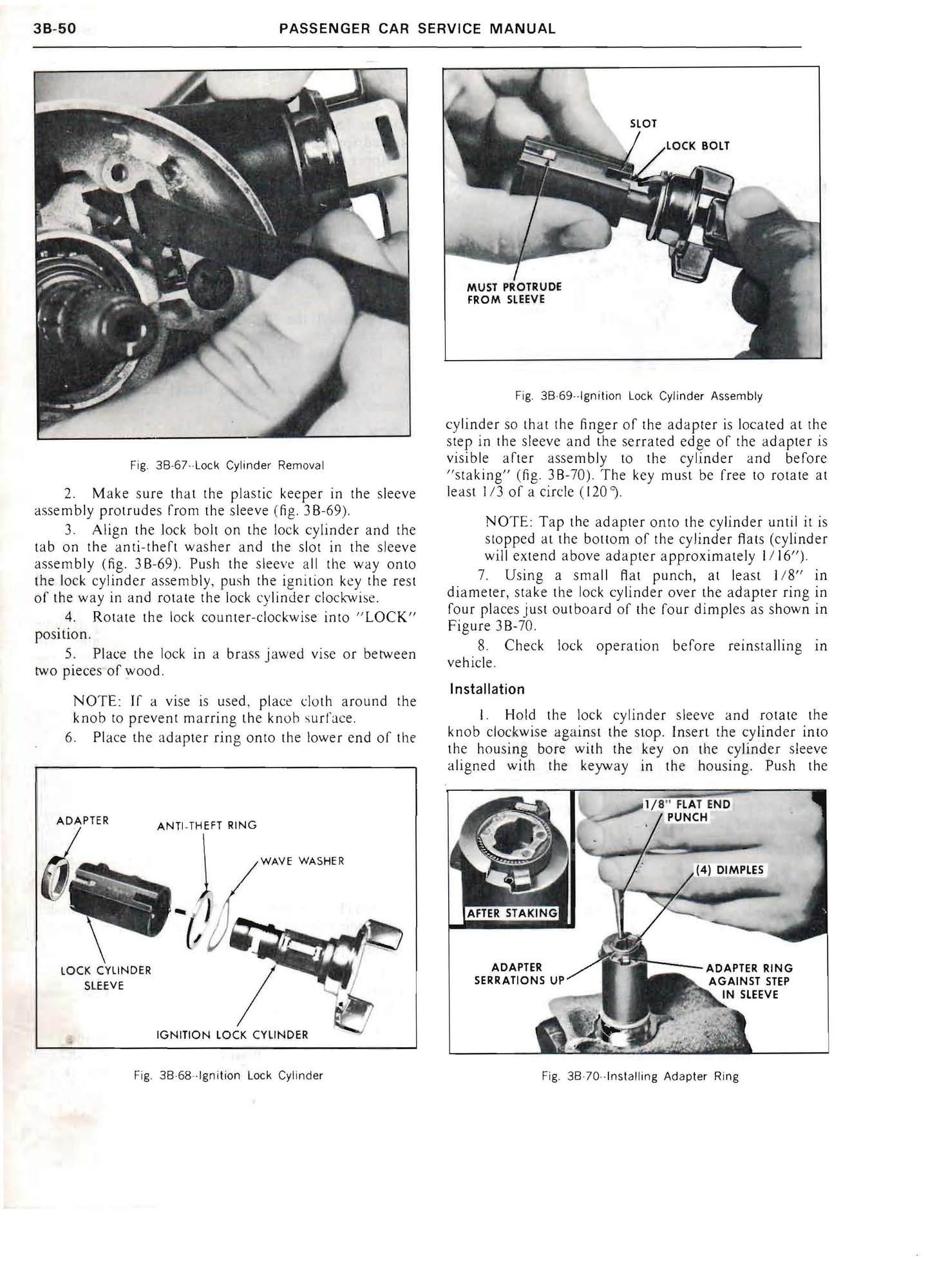

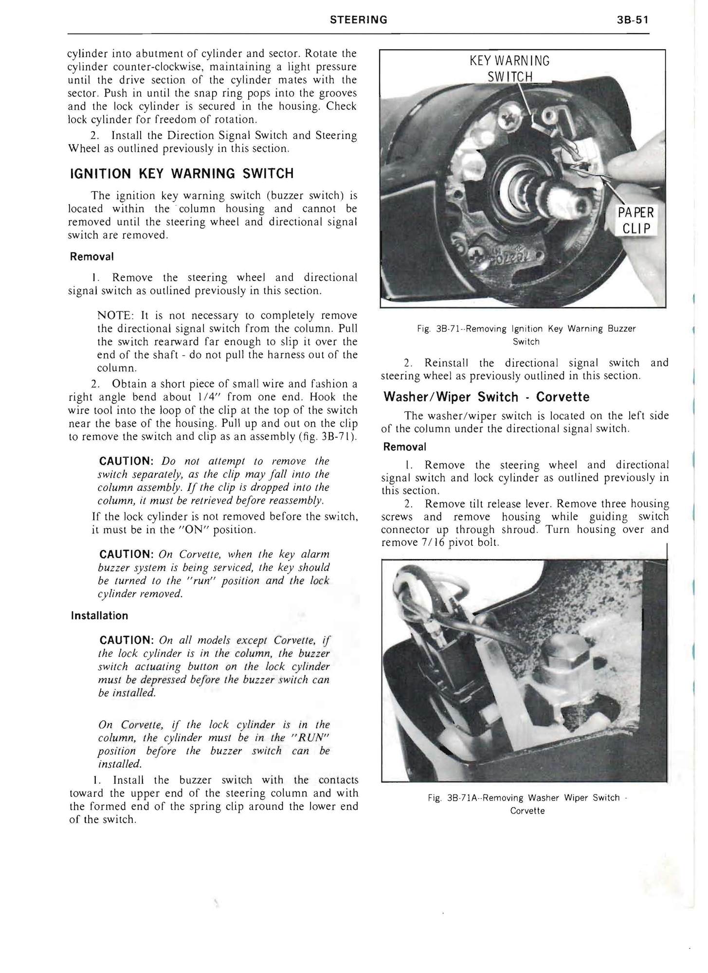

Give me a minute, I will try to get that section of the service manual posted...
Old Feb 17, 2023 | 05:40 AM
  #33
bmotojoe's Avatar
bmotojoe
Joined: Oct 2007
Posts: 4,364
Likes: 1,724
From: Seattle Area Washington
Page 49, 50 & 51 from the 77 service manual,
Let me know if you need others...

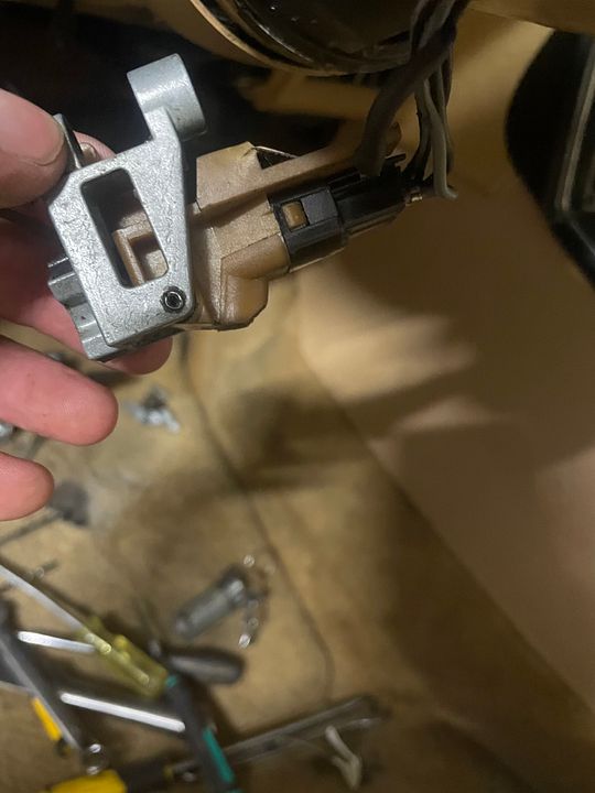

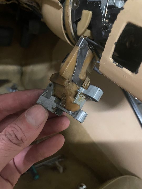

Thanks bmototjoe - Its out. Note to self, put on your glasses when you're working out on the shed. I'm use to my vintage Harley's and I don't need my glasses!
Here's what it all looks like
The cream coloured thing in the middle if the picture isn't attached to anything. That's the little rod that runs down the middle of the steering column
So I think I know why the blinkers wouldn't hold. The pin on the end of the little arm that's supposed to slide as you lift the lever is all gummed up and doesnt run smoothly in the channel
We have 2 speeds for the wipers which is good.
Still no washer bottle action despite power at the motor so I'll try and earth it out.
High beams are still a mystery until I read the manual

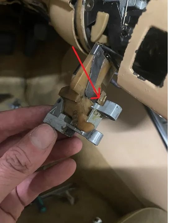

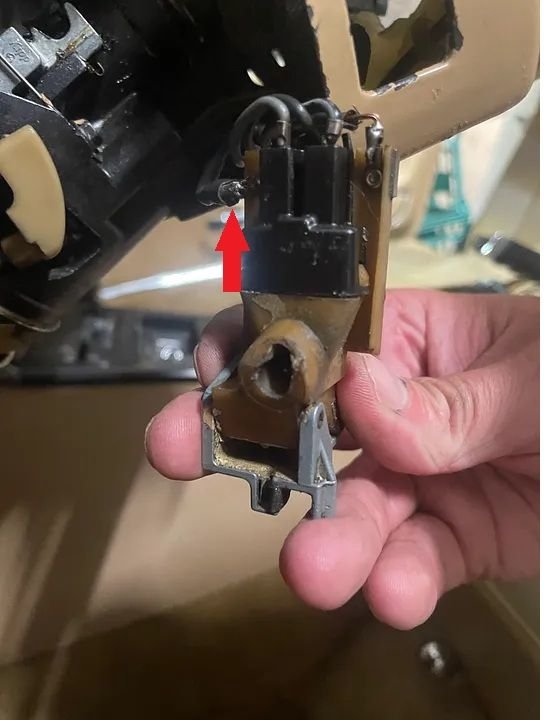

Your pivot bracket is intact so that is a positive!
The ground wire eyelet for the washer pump circuit has been repaired.
I have seen several that are completely broken at the eyelet or have attempted repair.
The set of contacts the red arrow is pointing to is your ground circuit to the washer pump...
When you press your turn signal lever in, it presses these contacts closed.
If those contacts are misaligned or dirty the washer pump will NOT get a ground signal to turn on.

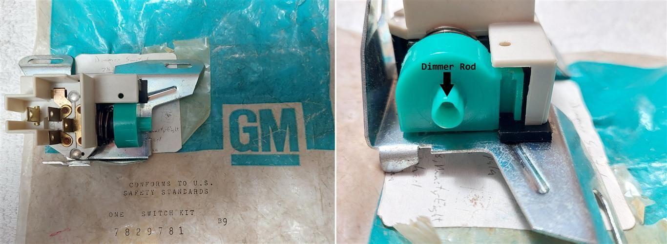

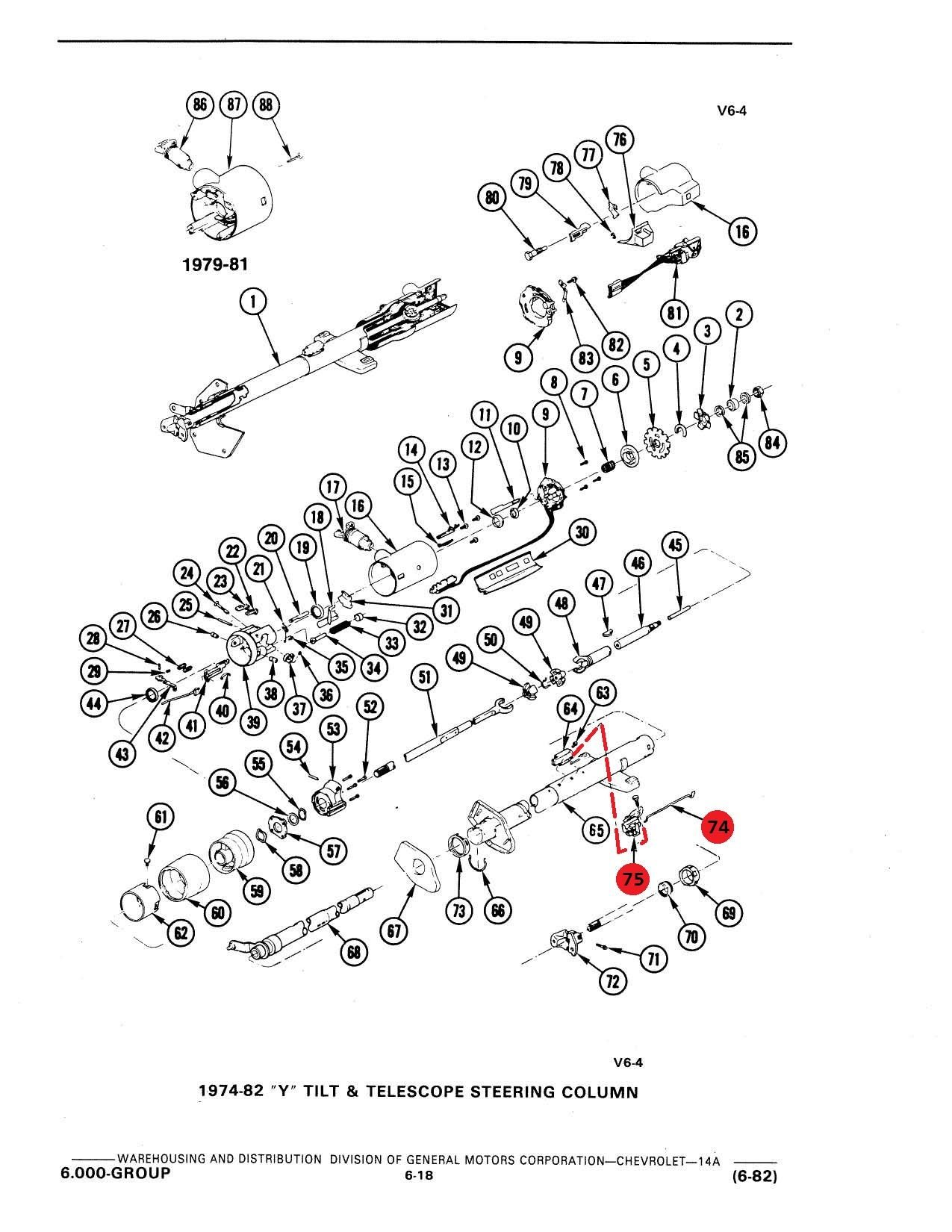

Dave, To answer your PM question...
Here are a few photos, 1st is the T&T column diagram 74-82
Item #75 is the Dimmer Switch Item #74 is the Dimmer Rod.
About half way down the column there are 2 switches, the left side of column is the Dimmer, right side is Ignition switch.
Dimmer Switch is GM #7829781 for the T&T Column
2nd photo is the Simmer switch and where the dimmer rod end fits...
Also, item #79 is the actuator you may be missing...

Thanks for the pictures
Found the hole in the switch and manually turned the high beams on and off.
