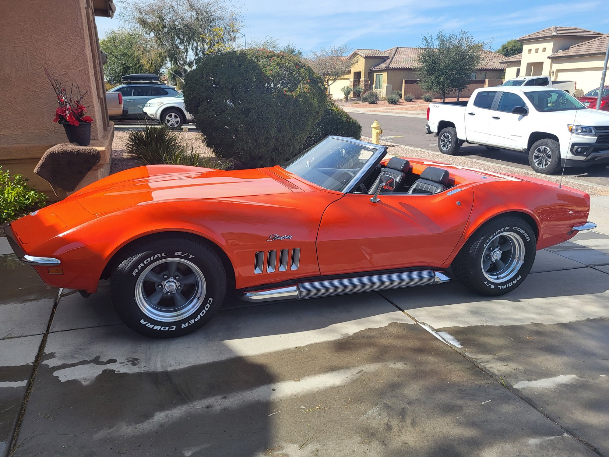

Done, based on prior spring replacements and feedback from this group I knew the replacement springs would sit a bit higher than I wanted and didn't want to keep installing and measuring if possible... I took just about 1/2 coil off (maybe just shy of a half coil) and split the difference between top and bottom of the spring to start with and sits where I want it... would have been too high for sure for me.

I did consider that but didn't want to modify too much as the car is pretty original. There is a rule of thumb when cutting springs... free height spring cut gives twice the drop so 1/2" spring height cut gives 1" drop and worked perfect first time, took about a 1/4 coil off each end of the spring before installing, sits exactly where I want it, matches the rear and no difference in the ride at all... took it out for a while and measures 27.5" on all four corners, I got lucky.
I purchased two sets of springs (I have a friend who works for an auto parts house so wasnt expensive) just in case I went too far.

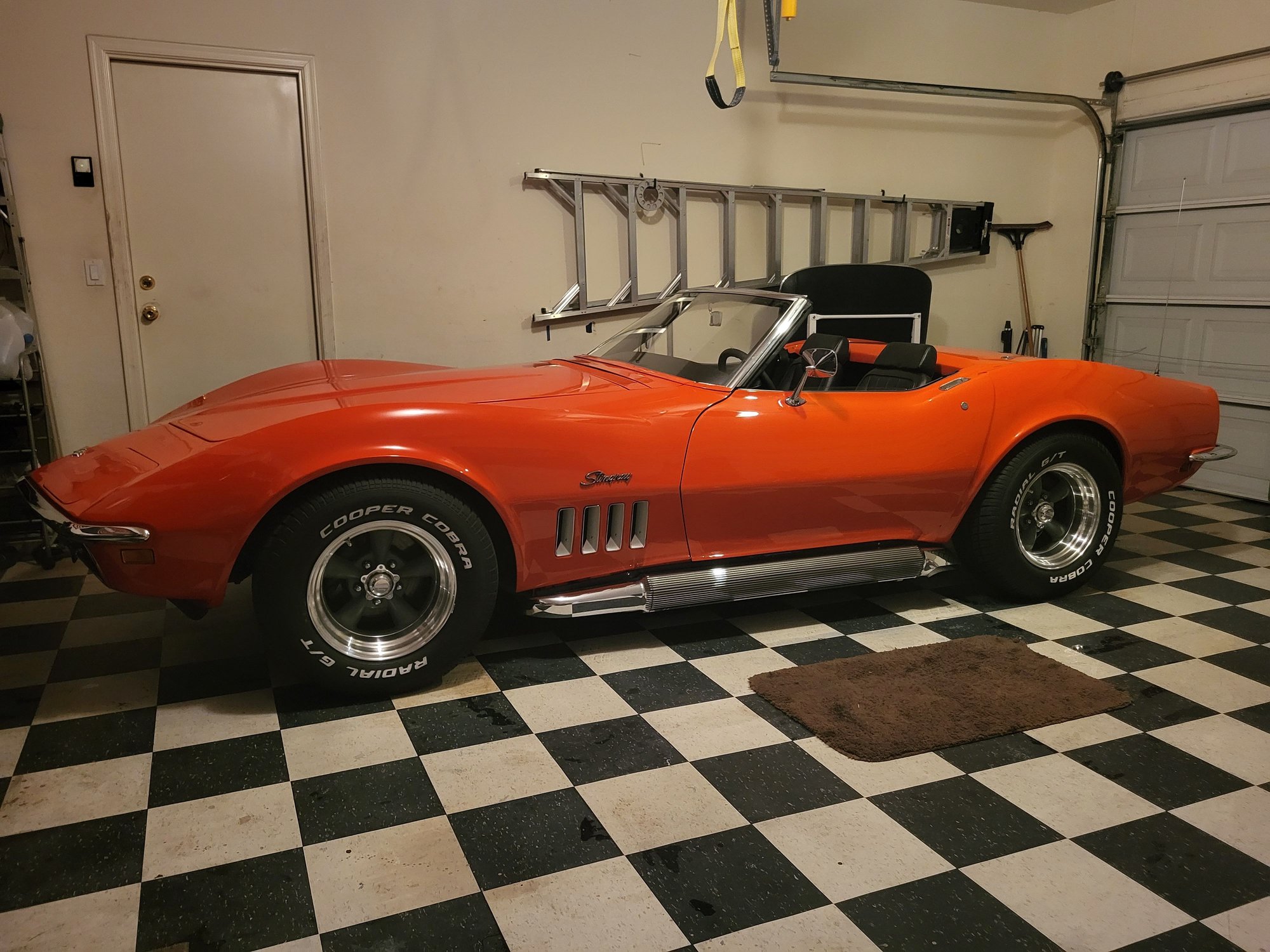

I didn't really take notice of the rear height and gas tank level... the above pics are with about 5/8ths of a tank, pretty even all around, standing at a side profile there is about the same wheel well gap all around.
