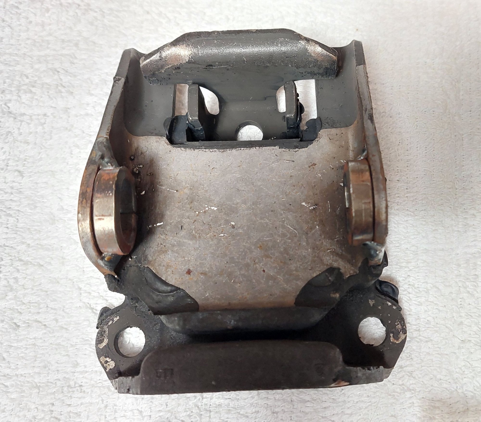

Those appear to be standard non-locking mounts.
I think you have a 77, if your current mounts are the originals, when new they would have looked like this locking style mount.
On a locking style mount even if the rubber breaks away the 2 sections of the frame are still joined together.

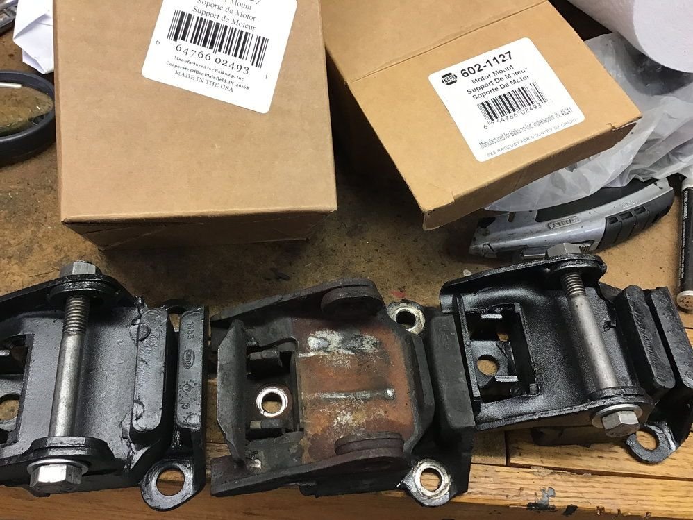

I replaced originals here
https://www.corvetteforum.com/forums...ce-79-l82.html
the two mounts i got were usa and unknown. I reused original bolt as the ones that came were all different.

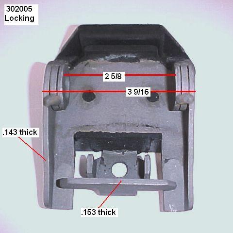

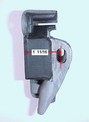

Here are the measurements to see if what you have will fit or not.
You can use the bolts that you have.
