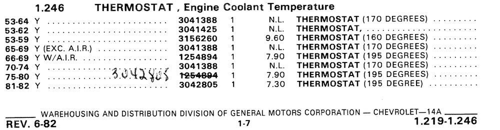

Hello can anyone tell me why my 75 L48 is running cool (165 degrees) after after it’s at operating temperature..radiator gaskets are all good, changed thermostat (180) as per owner’s manual although someone told me 195 is correct 🤷‍♂️ .. installed new hoses and flush out rad also checked temp at housing with IR gun still running cool .. thanks

Interesting your owners manual states what thermostat you should run.
195f is 75 unless yours very early?
it would be helpful to know what emissions your car has because some of those vacuum switches may not switch on or off until it reaches a minimal say 180° and 195° thermostat. If you don’t have any emissions concerns or vacuum switches in regards if too cool, I would stick with the 180. Here’s a thread about thermostats that I learned.

It's not unusual for the temperature gauge to read high or low (as in your case), Willcox used to sell a potentiometer to fix this. Where exactly are you measuring with the IR gun? They are usually set up to measure a high emissivity surface, if you are measuring on a reflective (or partly so) surface then the gun will read low. I've just fitted a 180F thermostat in my car, my temp gauge reads 155F but an infrared gun on the painted intake manifold says 180F and quite a bit less on the thermostat housing (which isn't chrome but is somewhat shiny).

I shot IR gun at the thermostat housing , 167, than at the top hoses 165, last the bottom hose 115

I wouuld check the thermostat you put in in a pan of water with a thermometer to see when it is opeinning. I usually run a 160 thermostat in the summer and a 180 in the fall. With th ecold fall temps my big block will stay cold and I dont get much heat out of it. The 180 thermostat is the fix for that.
What are your outside temps that you are driving in...go with the 195 t-stat and check again....you are one in a million not having a hot vette
