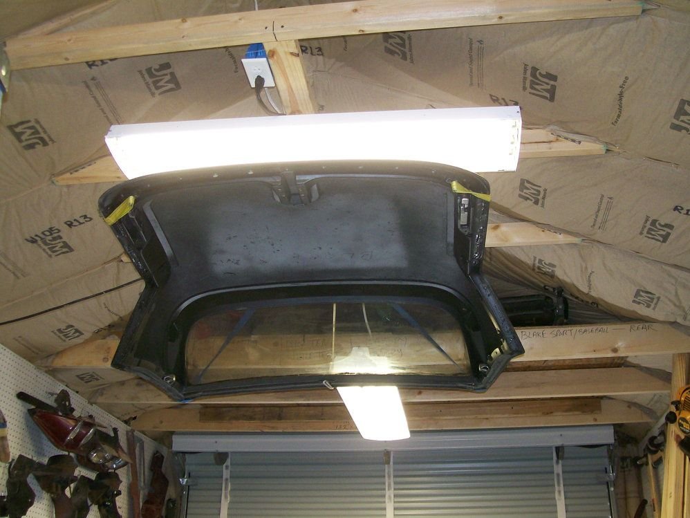

$100 for the setup....500 lb./120V winch and cargo straps cut to fit the hardtop.
If you insttall the winch on the wall....add $30 for two pulleys and a 3/8" threaded 8" long eyebolt to screw into the ceiling joist after drilling a 3/16" pilot hole 8" deep for the eyebolt to screw into.
(The winch wooden support was originally on the wall at another house)
