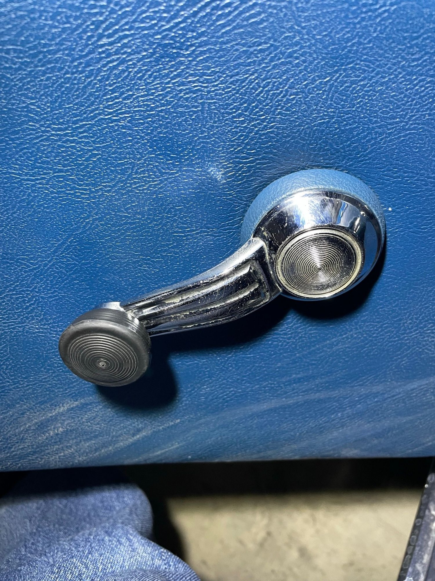

Ok, so how does the hand crack for the window come off…? Bought a tool to get it off but still can’t figure it out…

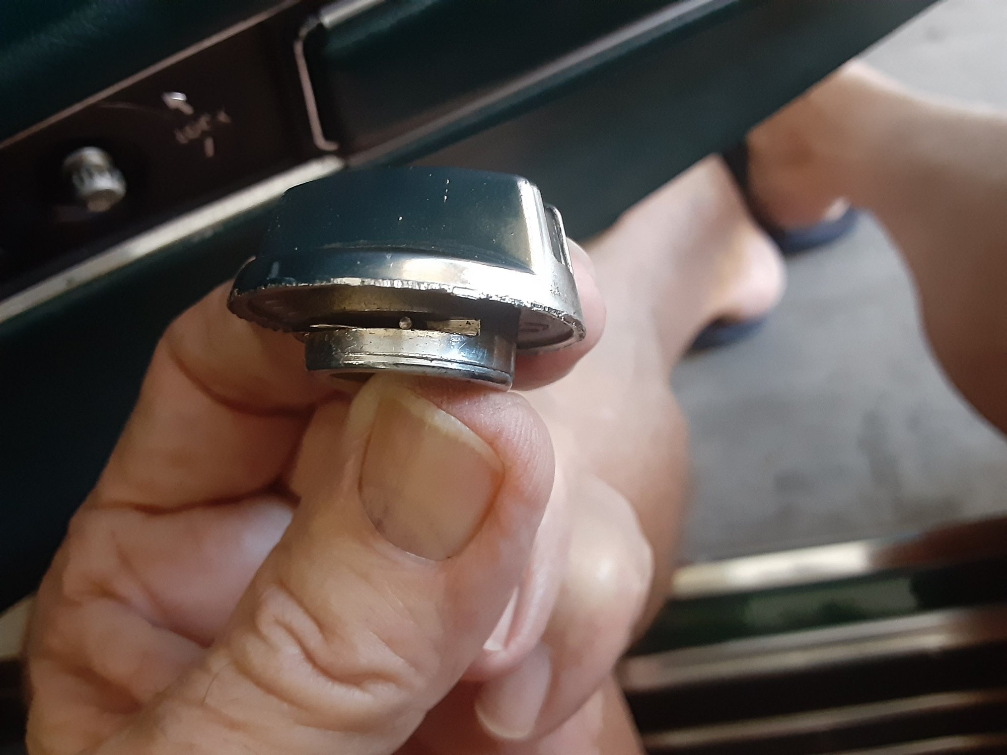

Mooser posted this last year which is easy to make.

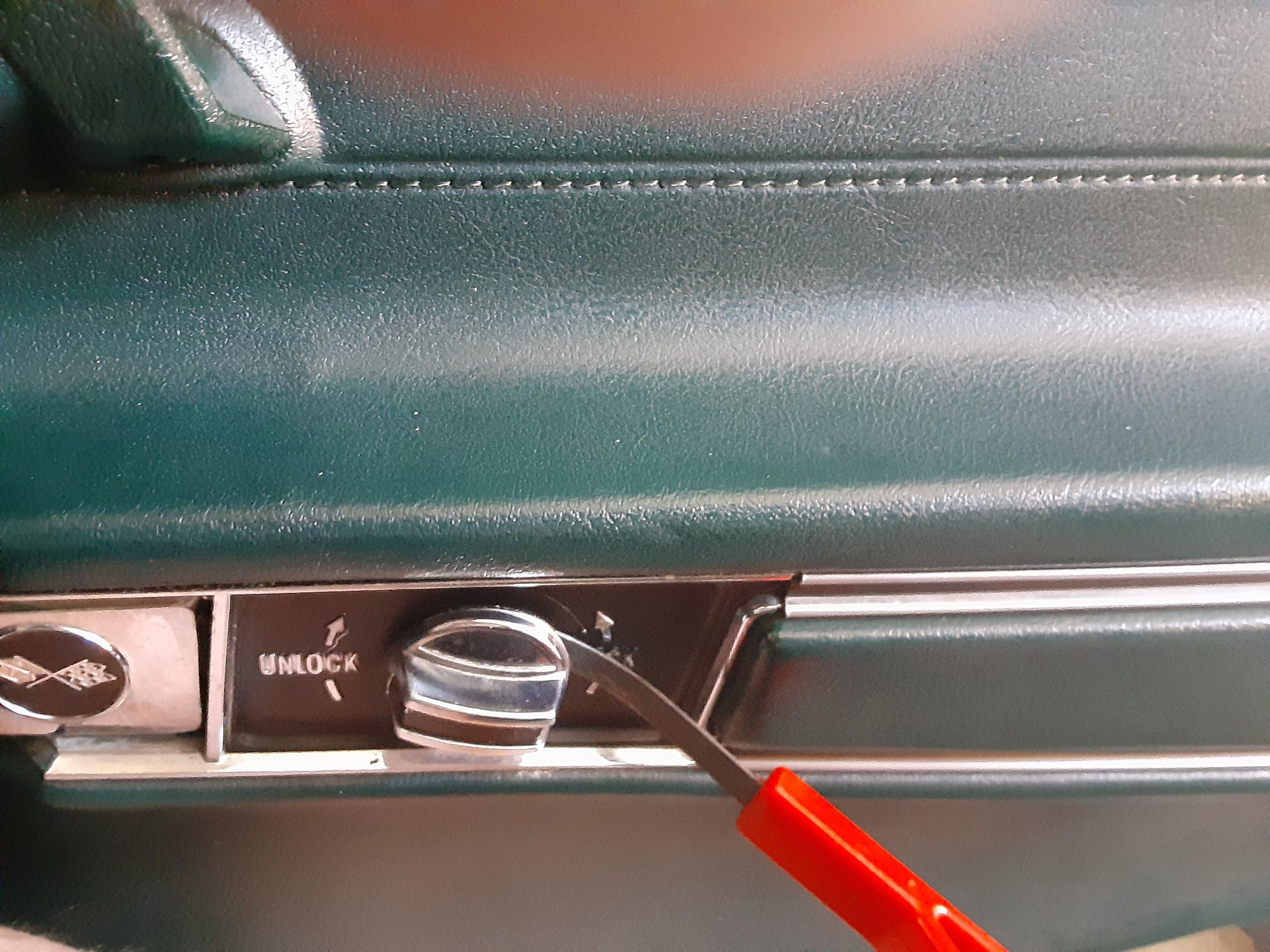

You go in from the **** side with the tool......you will have to push the door panel and collar in a bit to line up the blades on the tool with the slot where the clip is inside.......

You don’t need the tool, just a rag. See this YouTube video. How to Remove and Replace a Car Window Crank Handle

When you are ready to install the handles / *****, do a test fit w/o the clips first so you know exactly where they need to go. Then install the clips, line up the handle and one good whack with the palm of hand sends it home.

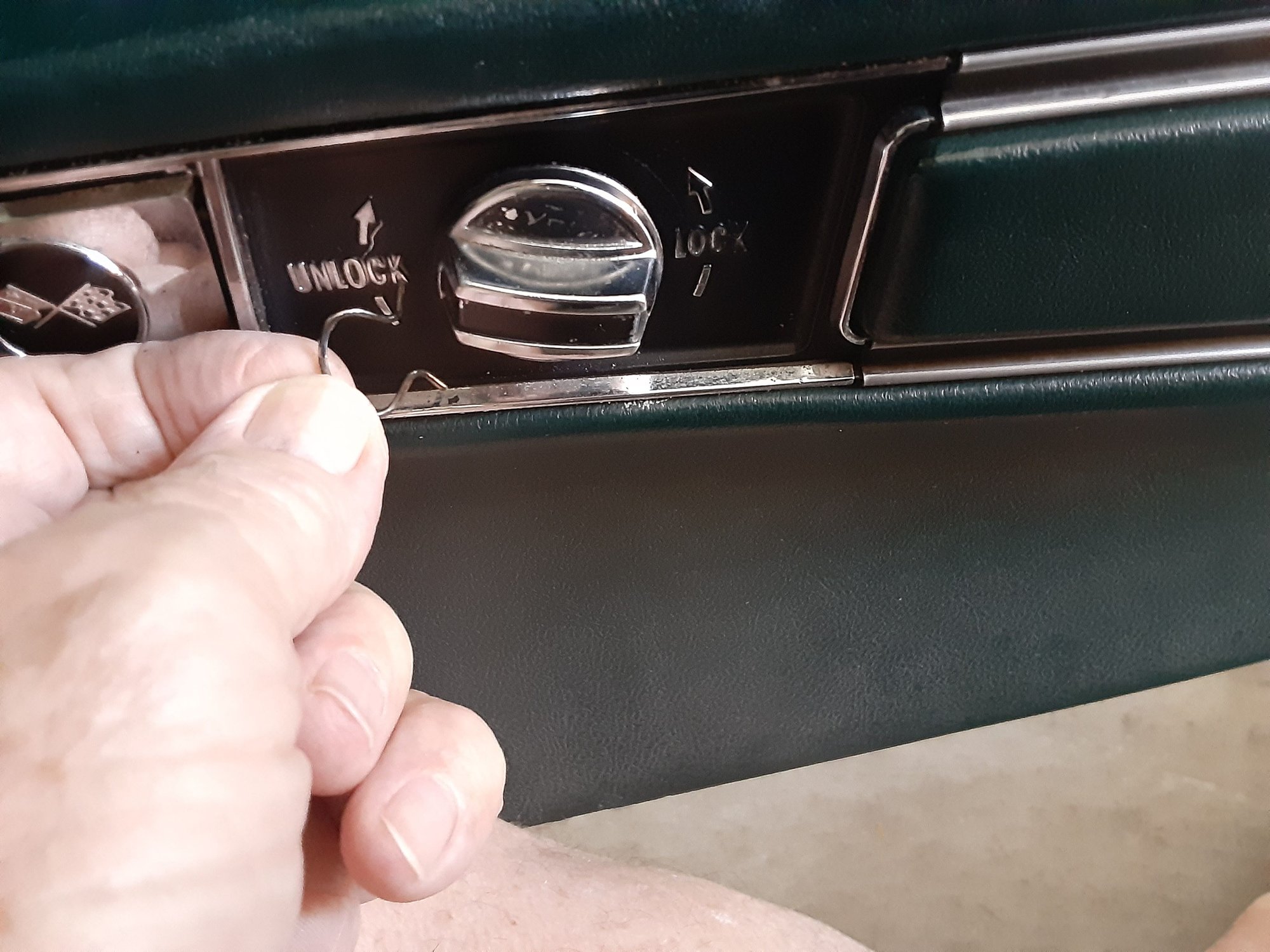

Dental floss works really good too. The weird fork tool will work but you have to line it up almost perfect

Upholstery fork…
