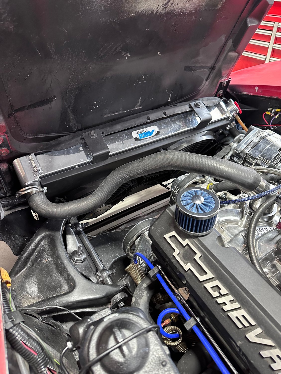

I don’t believe I have one, when I bought the car I never saw anything like that and this is the bumper that it has from when I bought it.

Nice looking engine! Thanks for posting photos. It looks like you are missing the stock light/louver combo for the front, and the lower valance as @MattoonVette pointed out.

What @Jebbysan posted was the most important part. You may be dead-on, if the vac advance is consistent (perhaps it is limited to 6 degrees?) You want 36 degrees of mechanical advance at the "all in" RPM. That means vac advance disconnected and plugged. You change the springs in the dist to dial in the "all in" point, such that mechanical advance stops advancing at higher RPM. The vac advance should be 10-12 additional degrees. The Look for posts by @lars and email him for his timing and HEI papers. He may have a Holley carb paper, too.
Good news on the lower radiator hose. Sounds like the stock spring is intact, so unlikely to be the issue.
Please take some measurements with the IR gun (Lots of choices in the $20-30 range at Amazon). Between a possibly hot-reading sender, and fixing the lower valance, you should be all set!

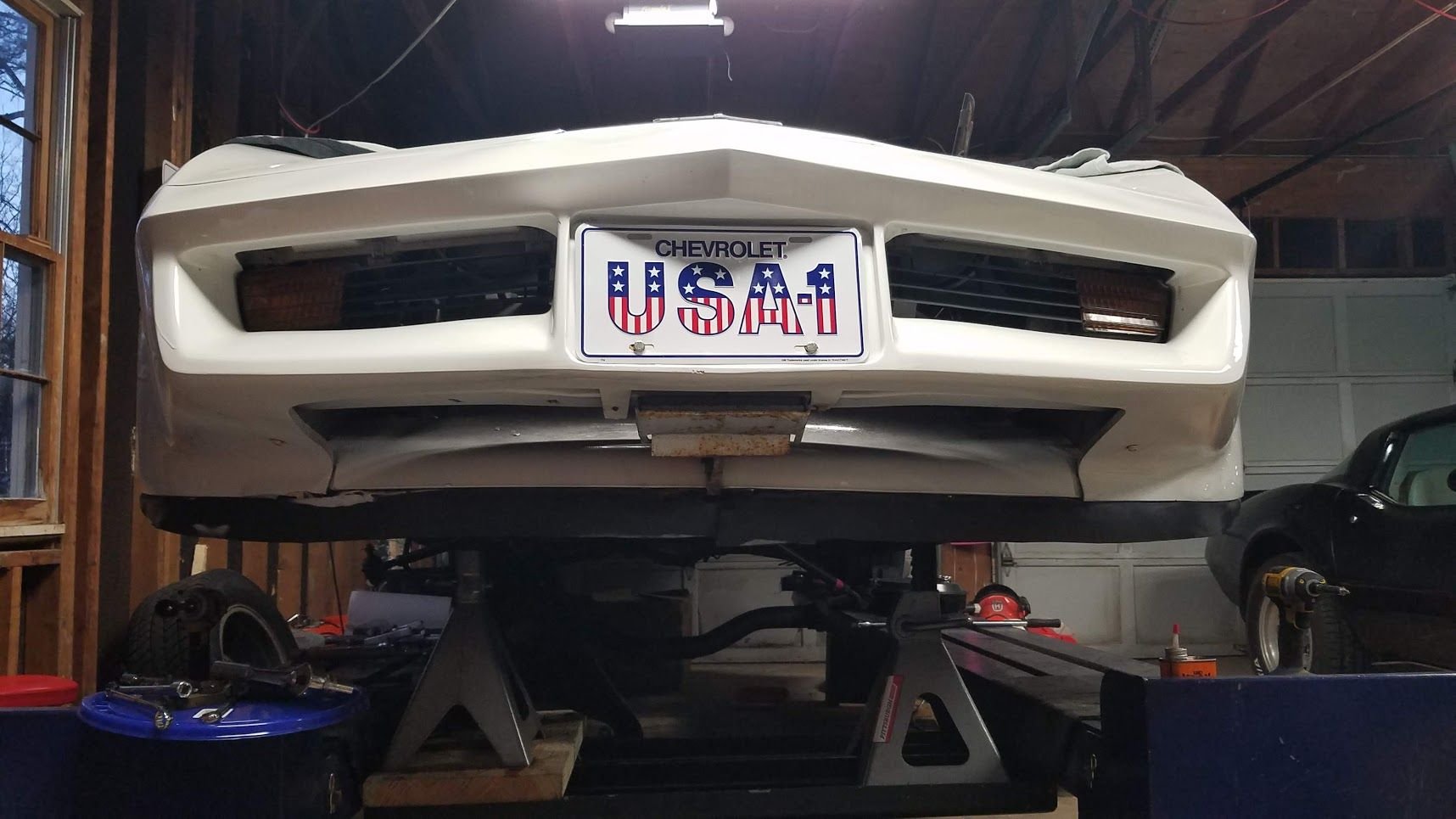

Bonus photos of my 80 with an intact (but replaced) lower valance (in the first photo, the block drain is open)

The lack of the valance and the two lower air dams can most definitely cause your overheating issues when you are at speed. Get those parts I showed you in the picture earlier. It will never stay cool when you are running it down the road without those parts installed.
