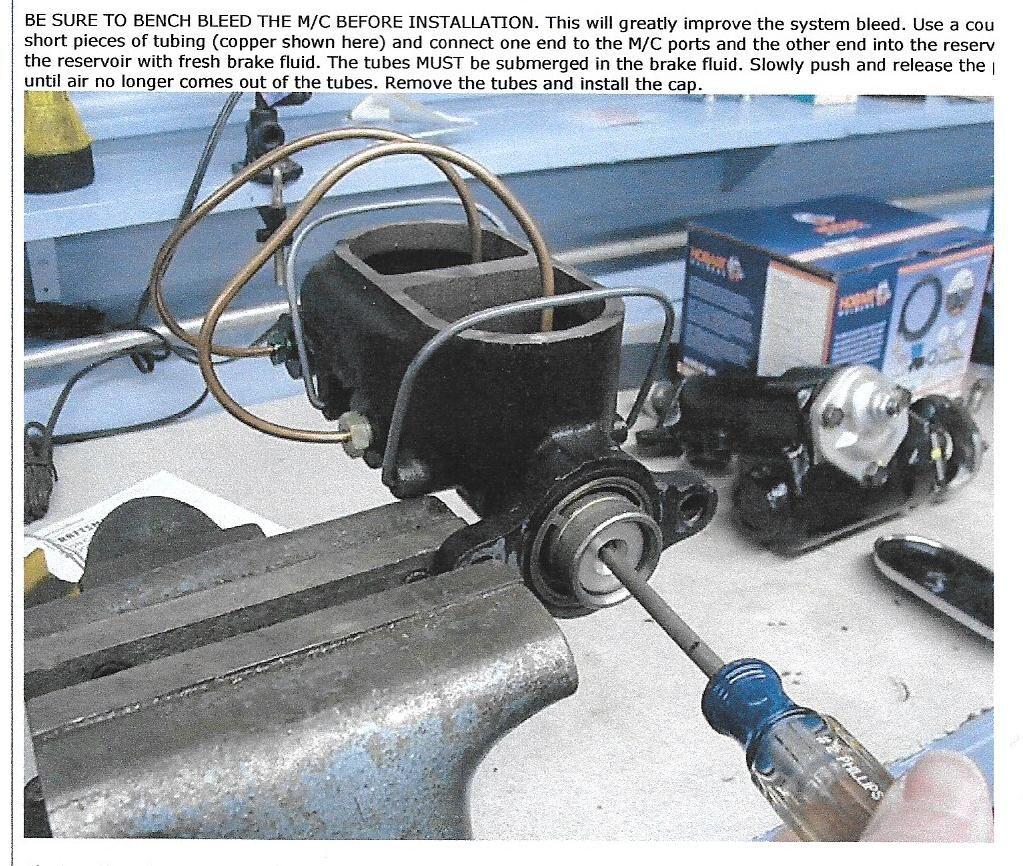

HI-guys its been a long time since I benched bleed the master cylinder I have the 2 tubes that attached to the master do you put the tubes in the fluid while I pump the master or keep them out and how long do I pump it for and will I need to bleed the 4. wheels again.THANK YOU for the help bob. 70. small block

Yes. Tubes in the fluid. It'll come out as bubbles but suck in fluid. Eventually after some number of pumps, the bubbles will go away.
Hot tip: Don't push the piston in all the way. That can ...and probably will damage the seals.
Best of luck on your brake job!

Yes, submerge the tube ends in the fluid. That way they don't suck air backwards. Yes, again, to having to bleed all 4 brakes afterwards. Any time the system is open at any junction between the fluid reservoir(s) and the caliper bleed screws, it's necessary to bleed the system.

It should look something like this:

You can screw a clean nut onto the end of each tube to hold them down in the master cylinder.

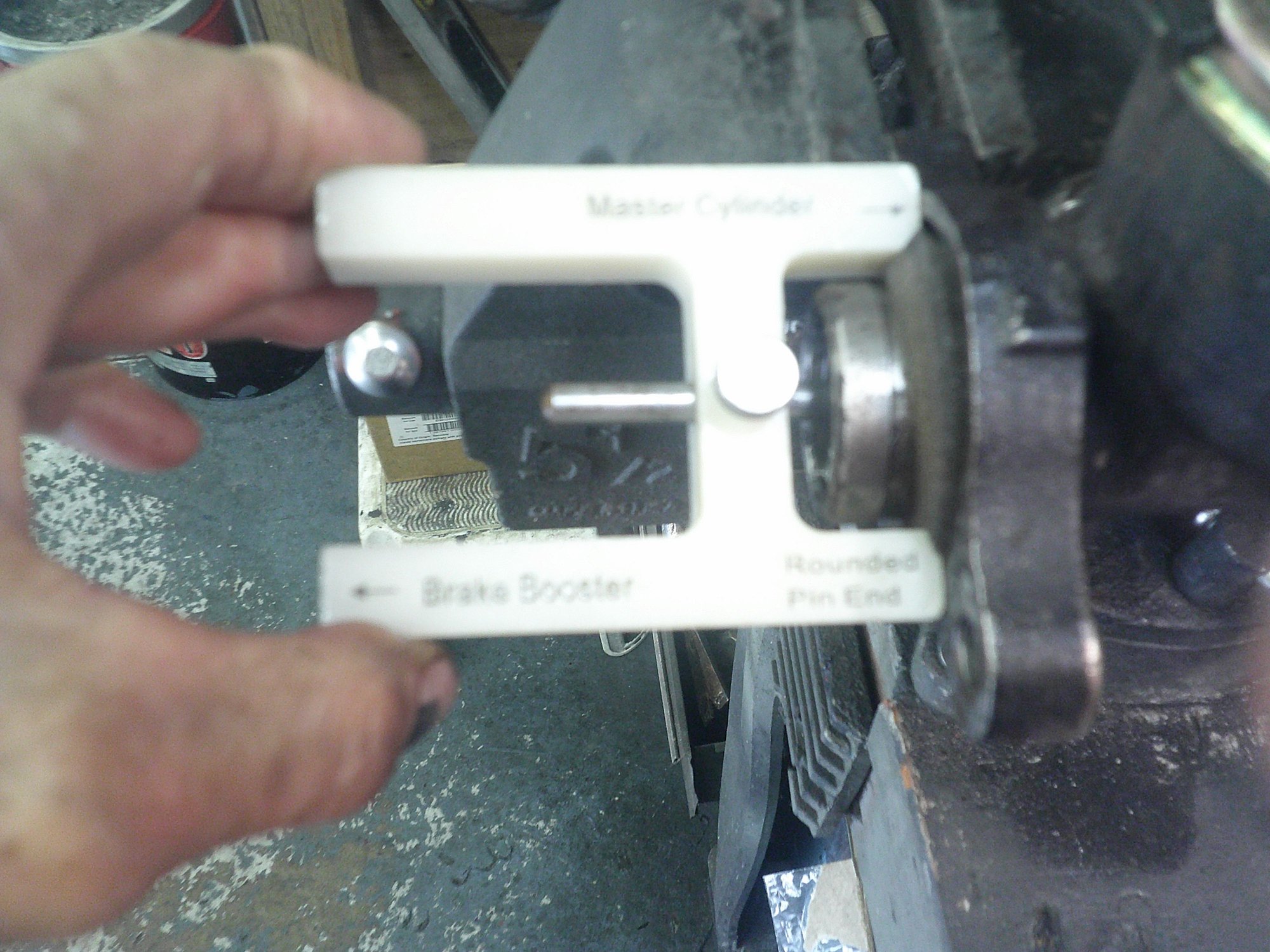

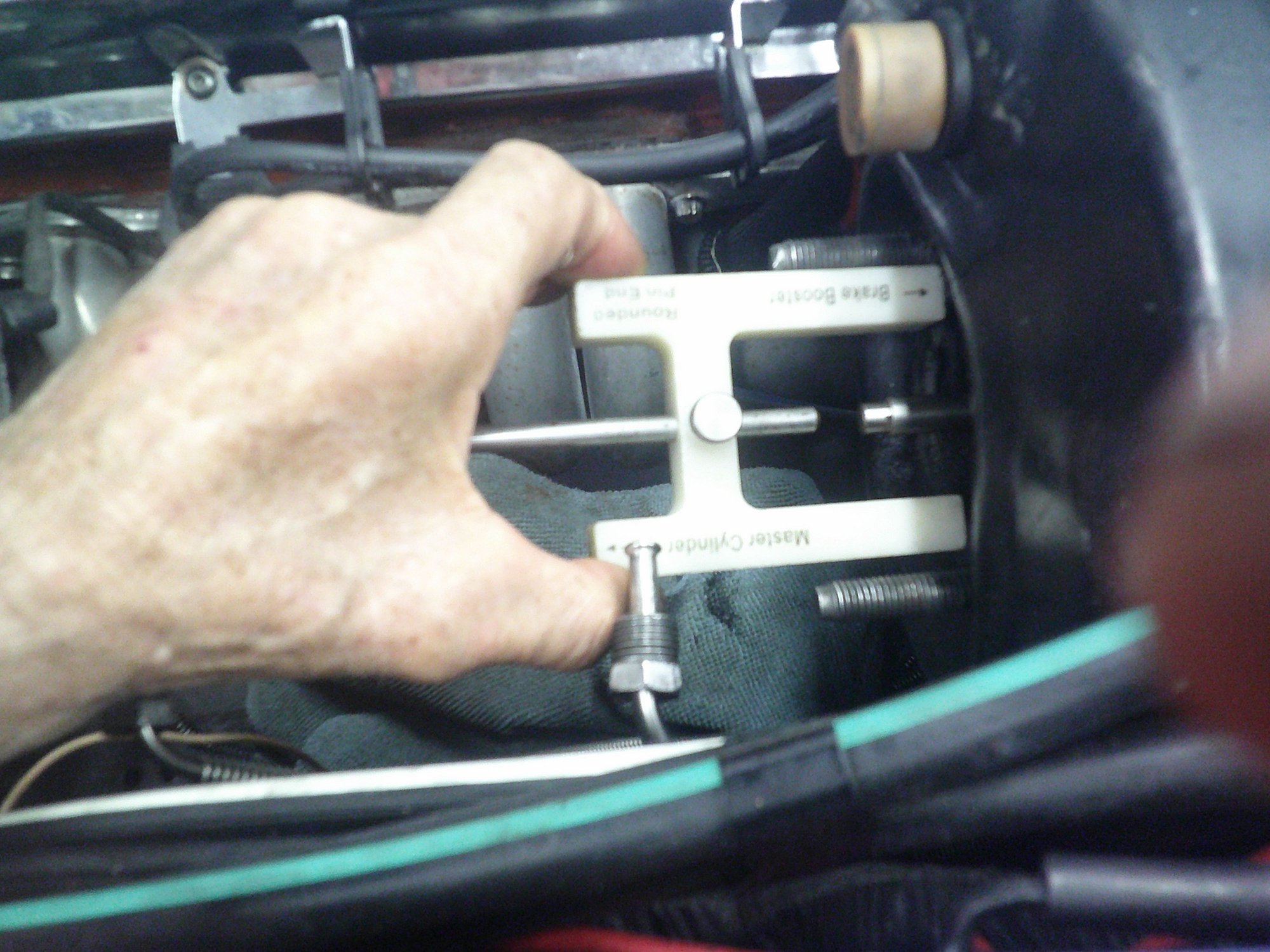

HI GUYS I think I found the problems I bleed the master put it on the car and bleed the car did not changed anything so took it. off then to my tool to test the fit and came up a little short.i think this is the problem but I don't know how this happened because I had good brakes before what do you think thanks bob
