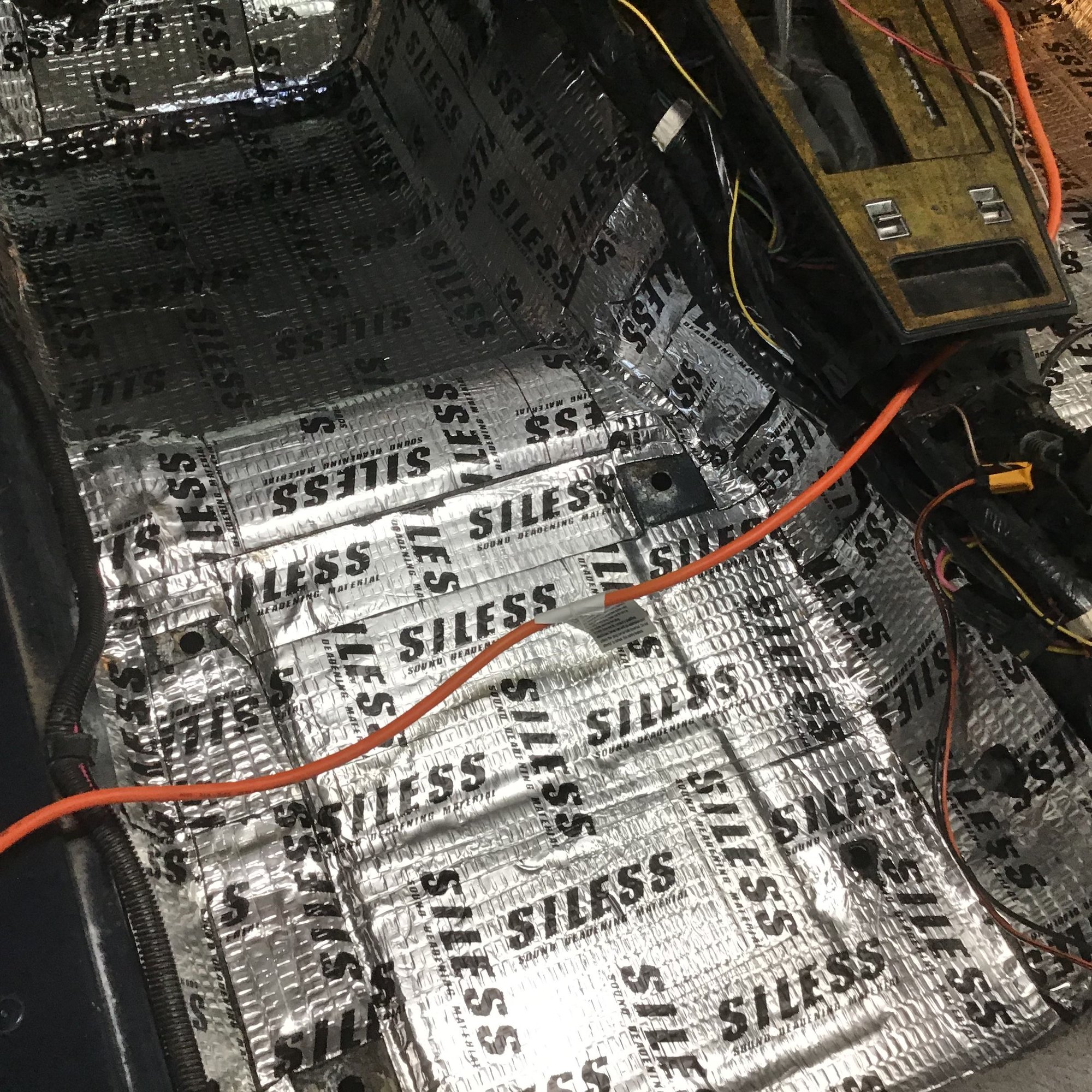

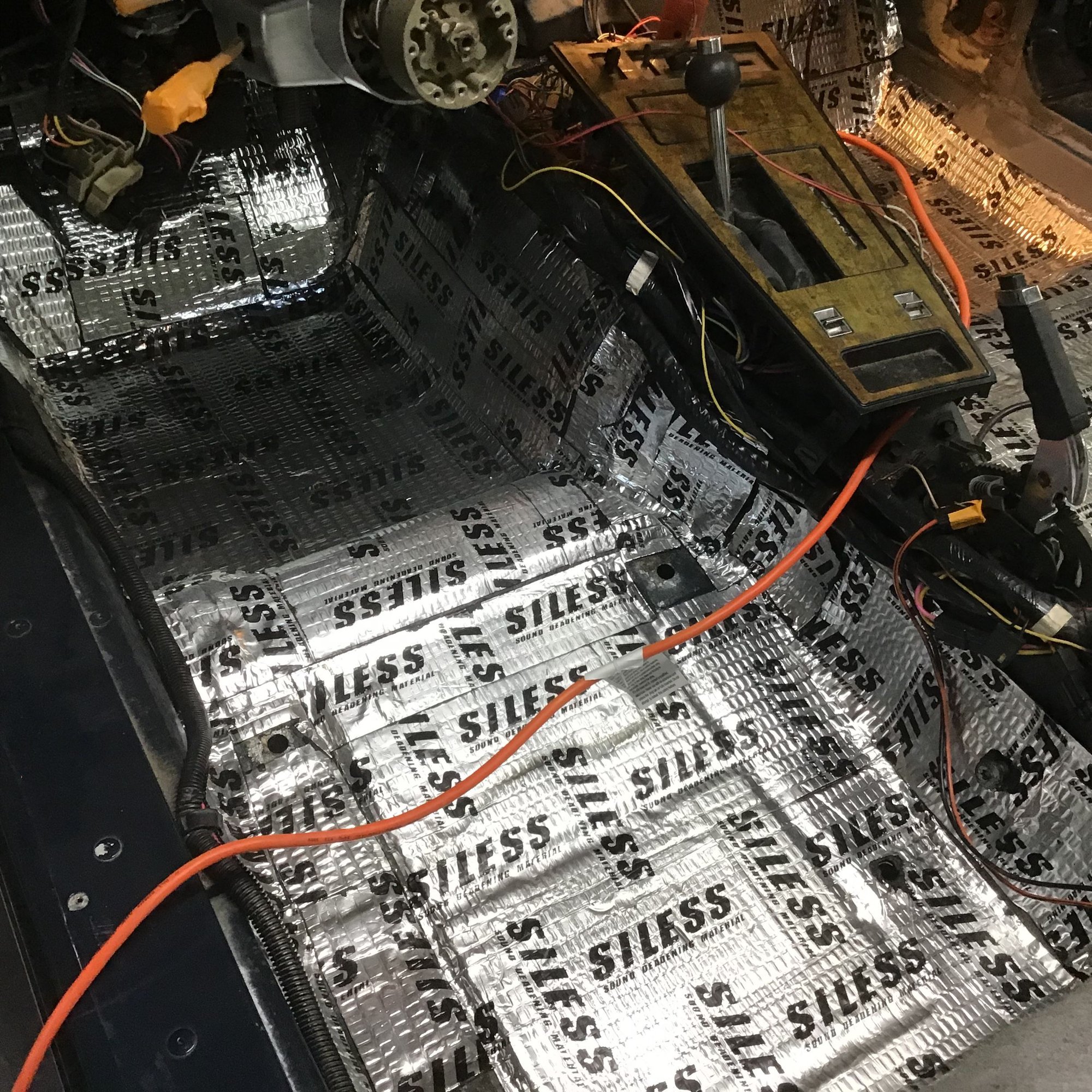

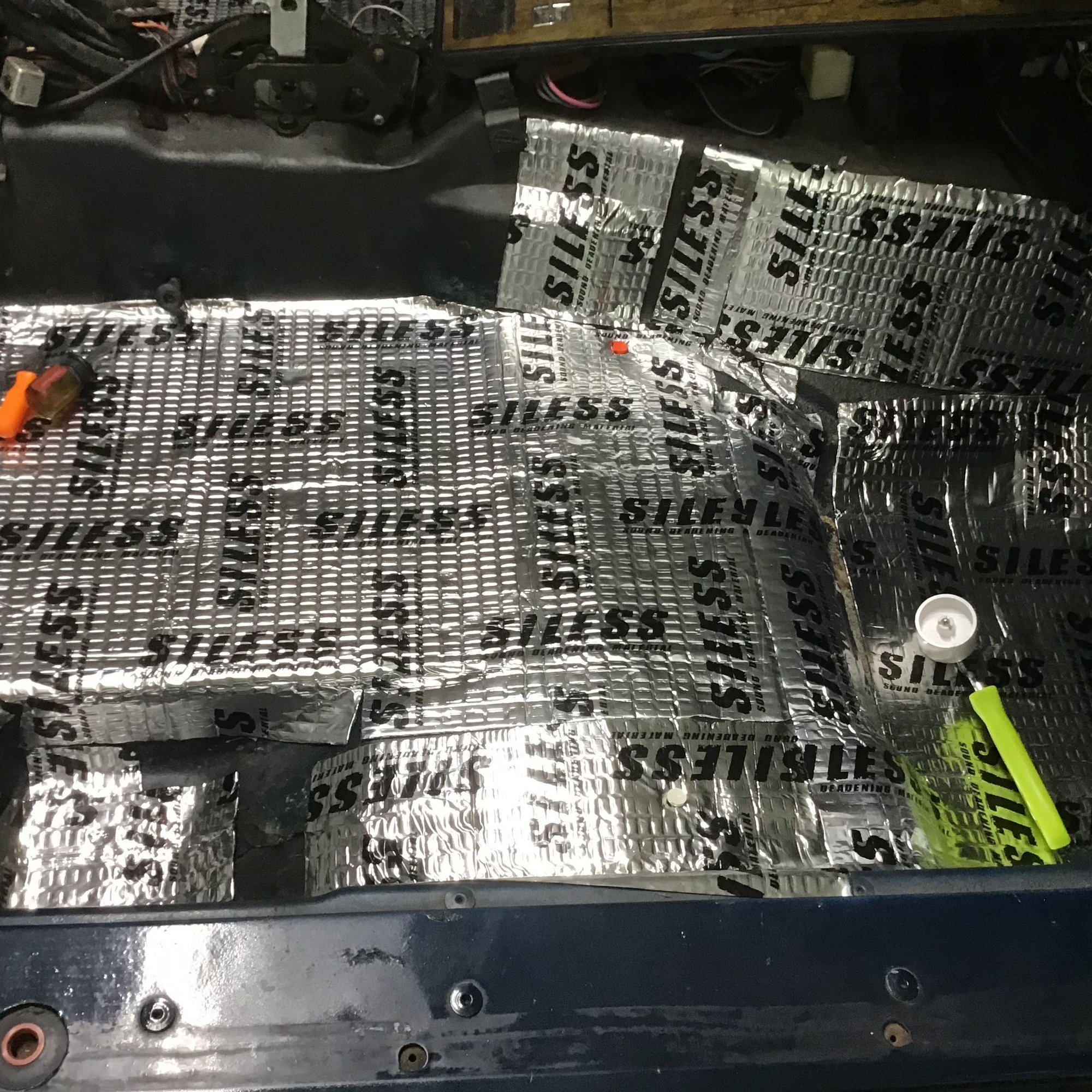

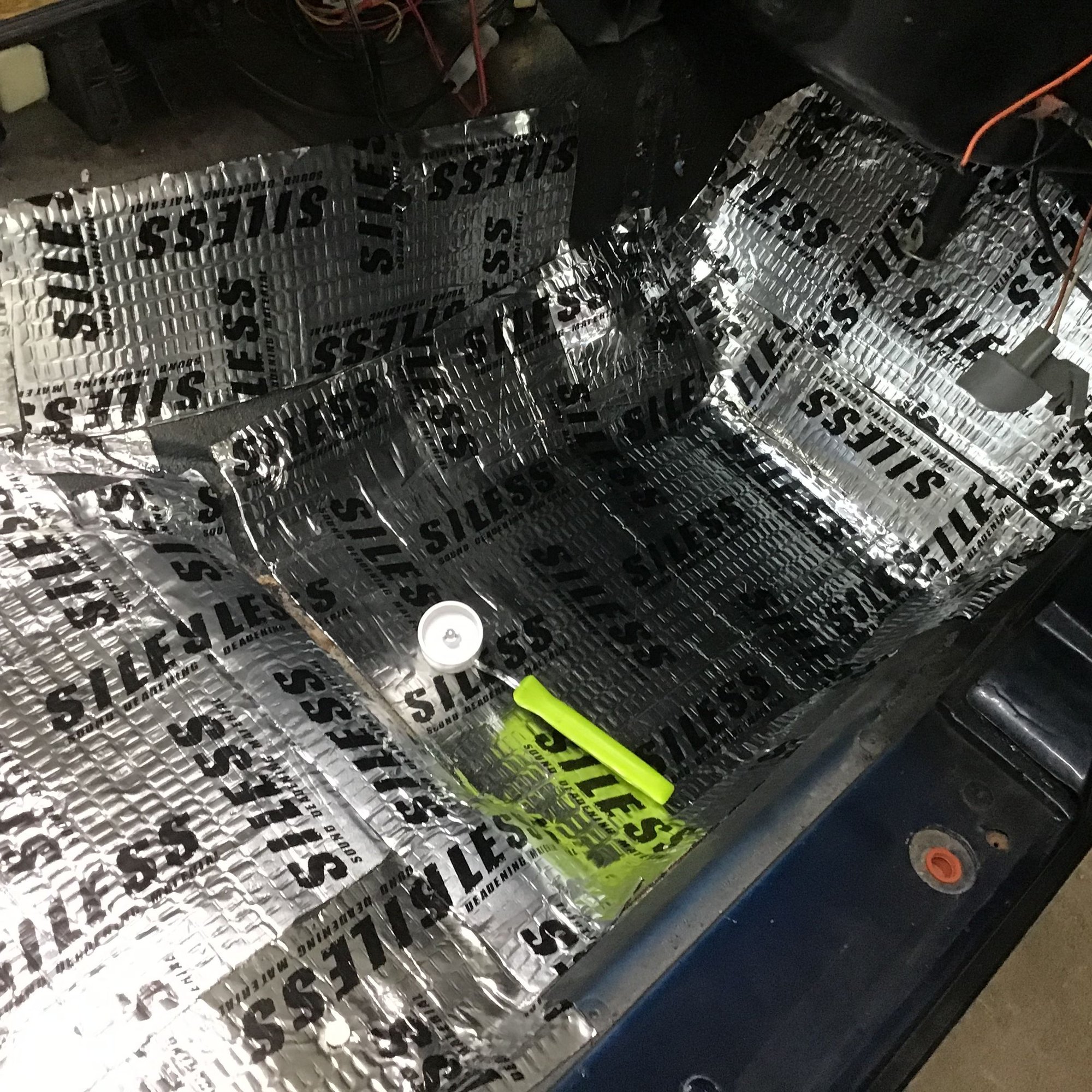

Boy this stuff,and a heat gun makes this so easy.

You are going to be GLAD you took the time!

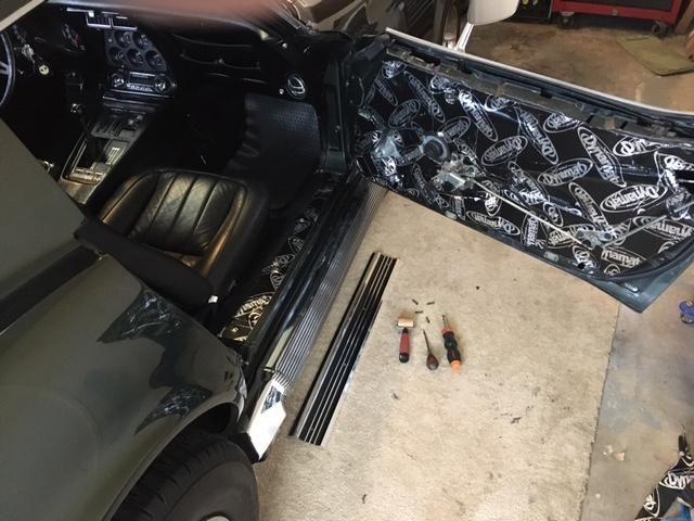

Yea,think I will try to pur some on the doors now.

Now,I have some left over so where are you installing it on the doors,I’m assuming between the door panel and door.and working around all the holes.
On the door and as you mentioned, leave an opening for the hardware, linkage, drain holes and the lower access panel. A roller makes the job a whole lot easier.

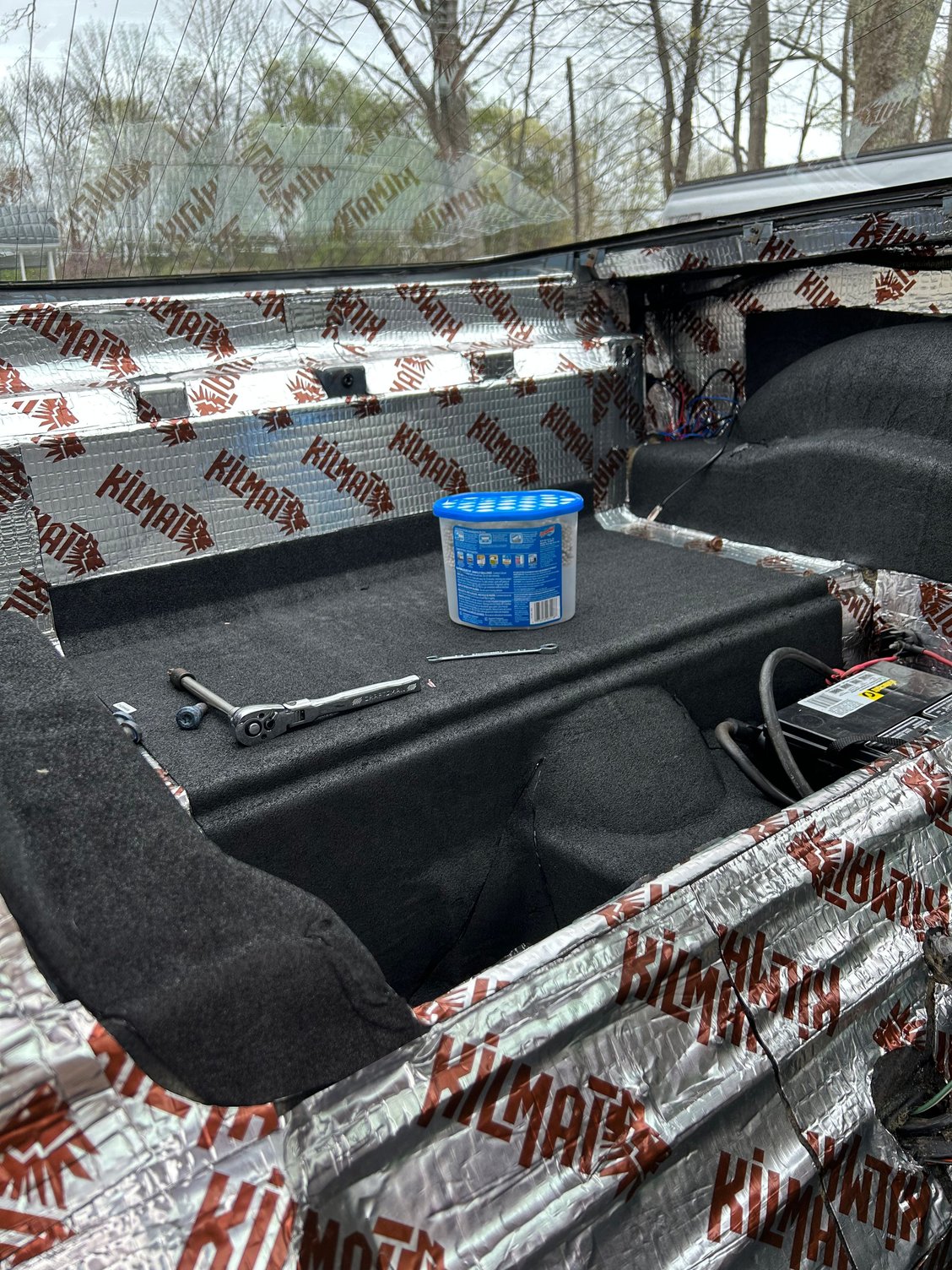

i did the whole interior from top to bottom an front to back with kilmat and xmat from eastwood it has a added layer of closed cell foam. when i did the dual exhaust inside the car was like an echo chamber. now it’s nice an quiet. and a roller is recommended for proper insulation and was a huge help for me.
