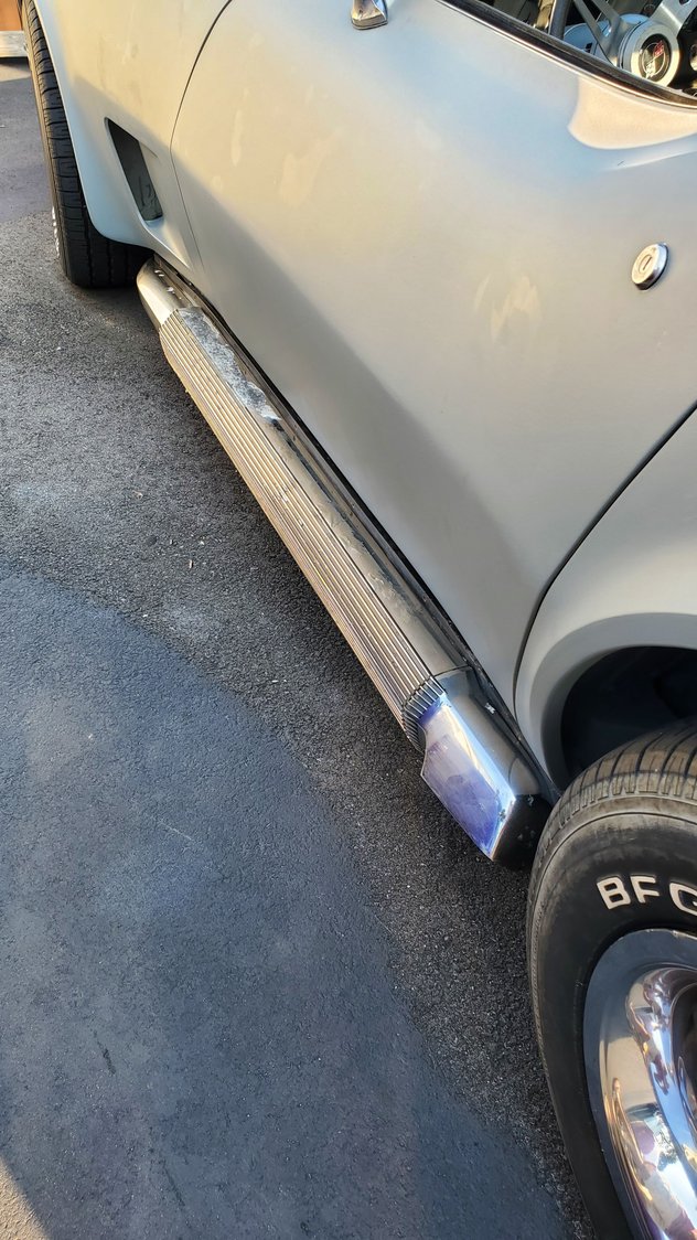

The pipes look like this. There are three pot metal pieces bolted to a plastic/ fiberglass insulator

Looks nice!

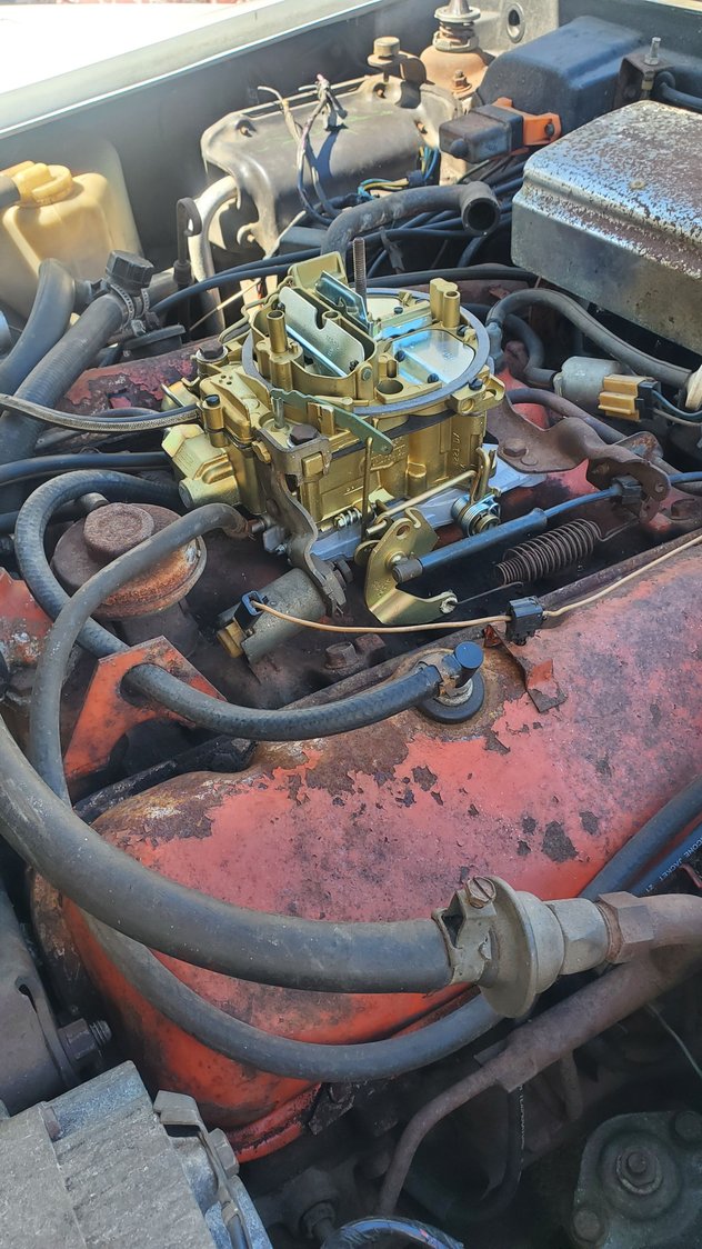

Im fairly experienced with Q-Jets and performance tuning. It's getting a "Jason" style tune!
Timing is right on the money. Carb is freshly restored. Just have to fix the exhaust so I get get an accurate AFR. The plugs are new and still have no color on them which leads me to believe it's way lean.
