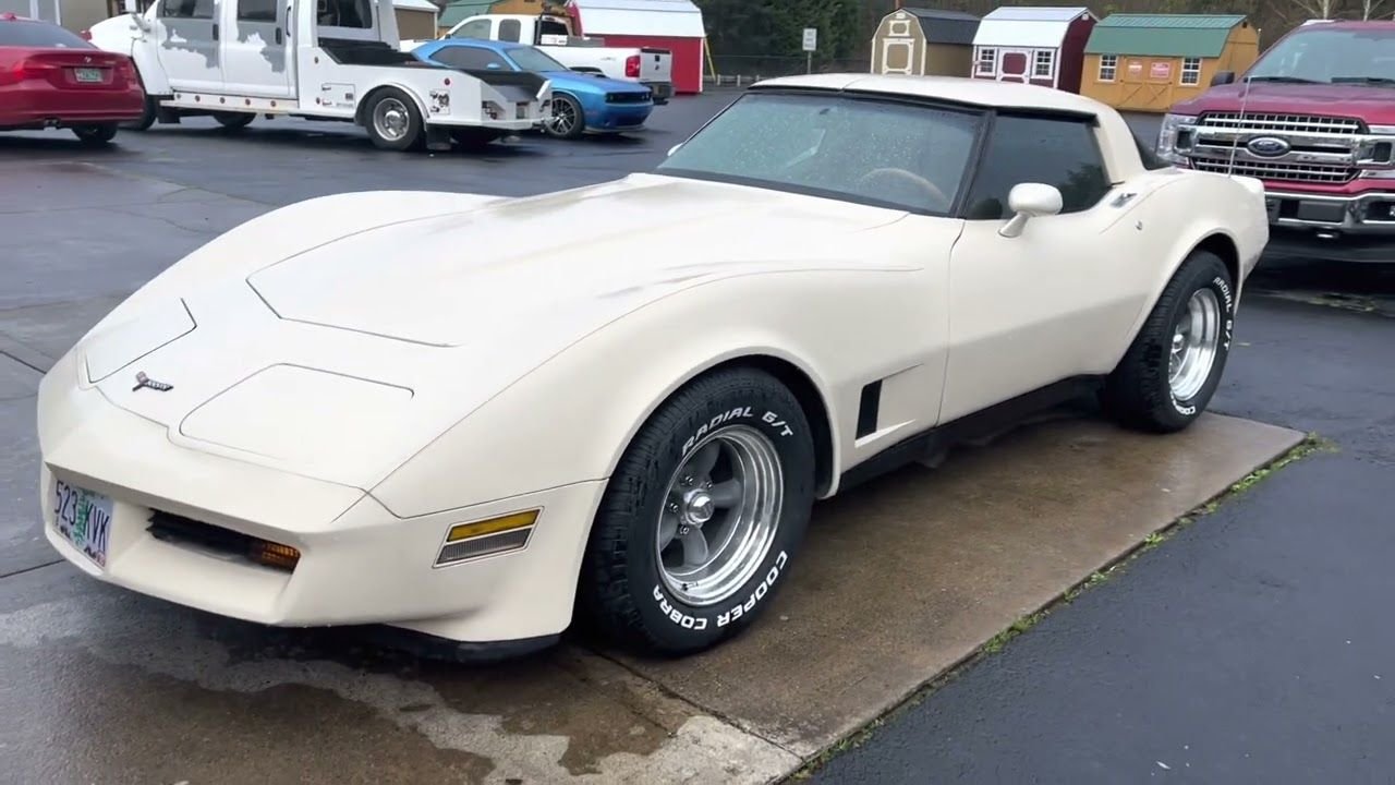

Not sure what year your C3 is and again I know they fit/clear no problems earlier C3s and see no reason why they won't work for later C3s, according to wheels4less they will fit up to 82 and here is an 81 with the same 15x8.5 wheels

Yes,mine is a 1981 also,and yes I found some,just a little hesitant,scared they want fit.lol...

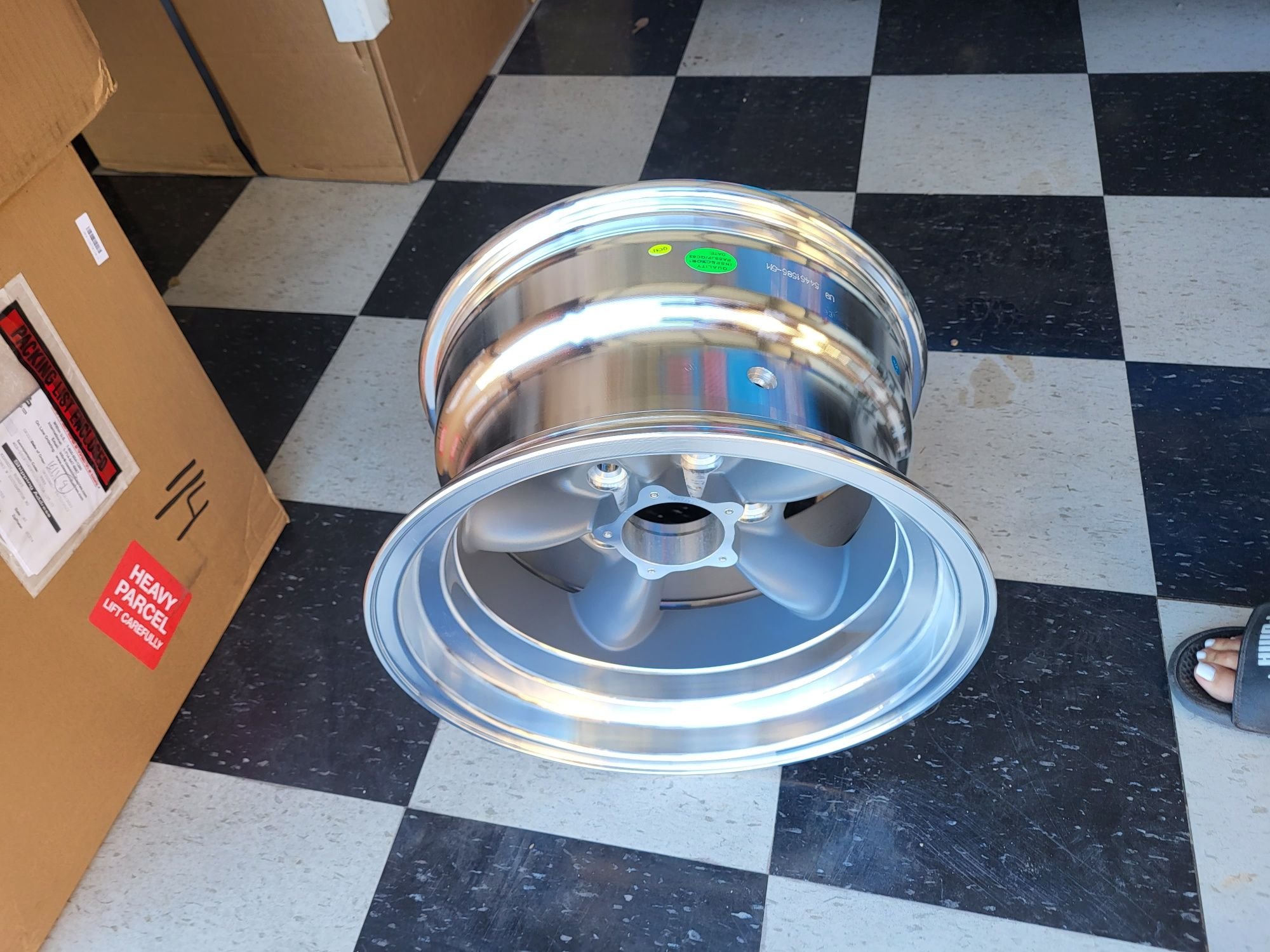

I personally am not aware of a narrower caliper, the contact with the wheel is the outer most area of the calipers (face side) the "D" wheels have a slight curve on the back of the spokes to allow for that.
My wife just sent me a pic of one of the wheels that arrived today... you can see the slight bend to allow for the caliper.

Gorgeous! Are the lips cleared over, or are they uncoated allowing you to polish them to an almost chrome like finish?

They are machine finished and not sure of clear, I will know better when I get home tomorrow, i think the only "non cleared" polished are polished fully with no painted center though the machine finish could be sanded smooth and polished.
