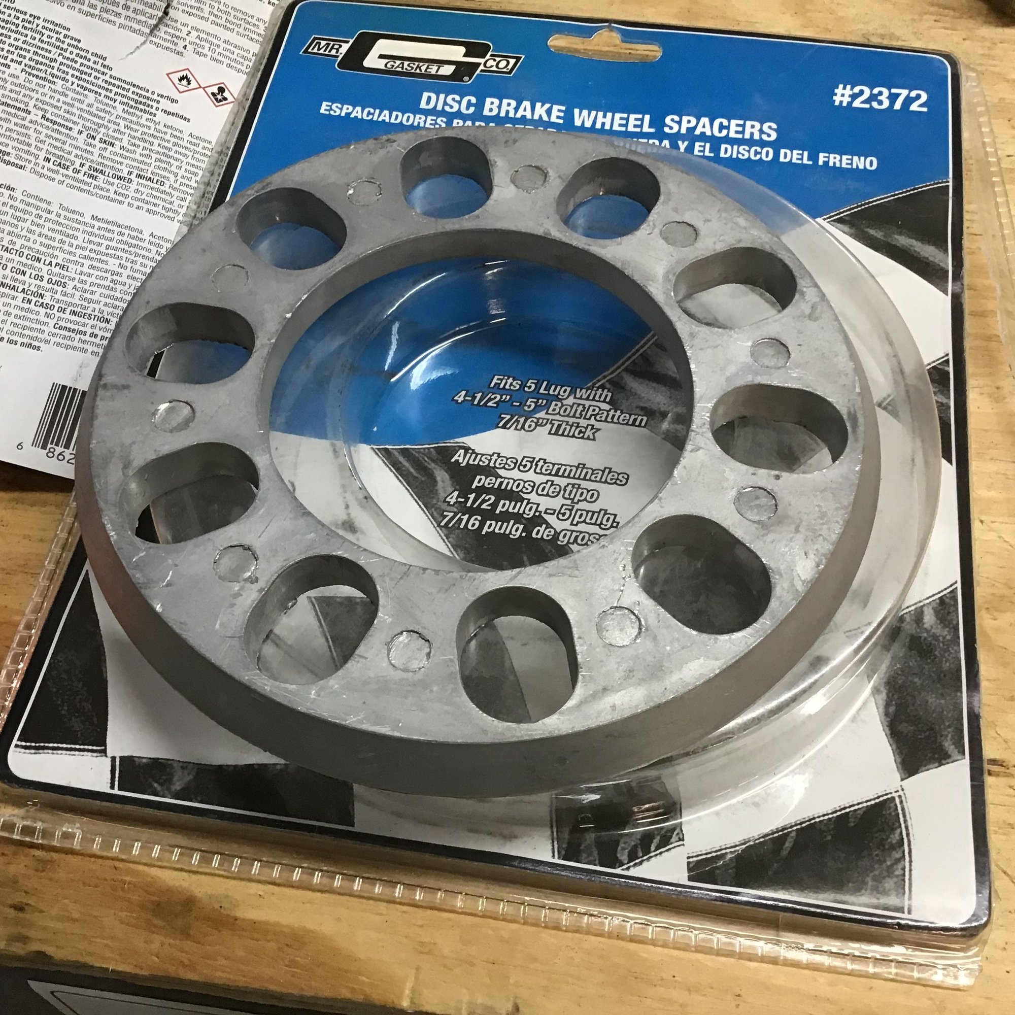

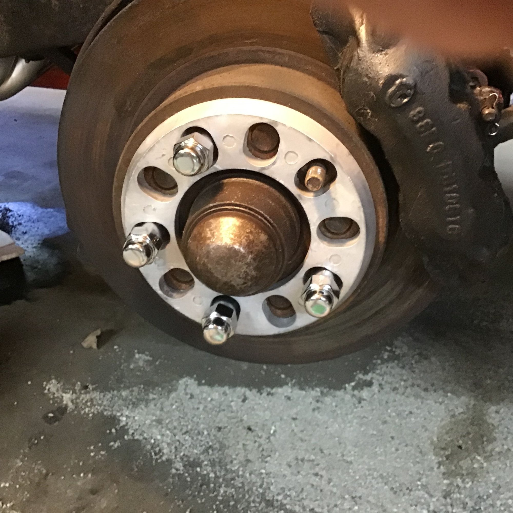

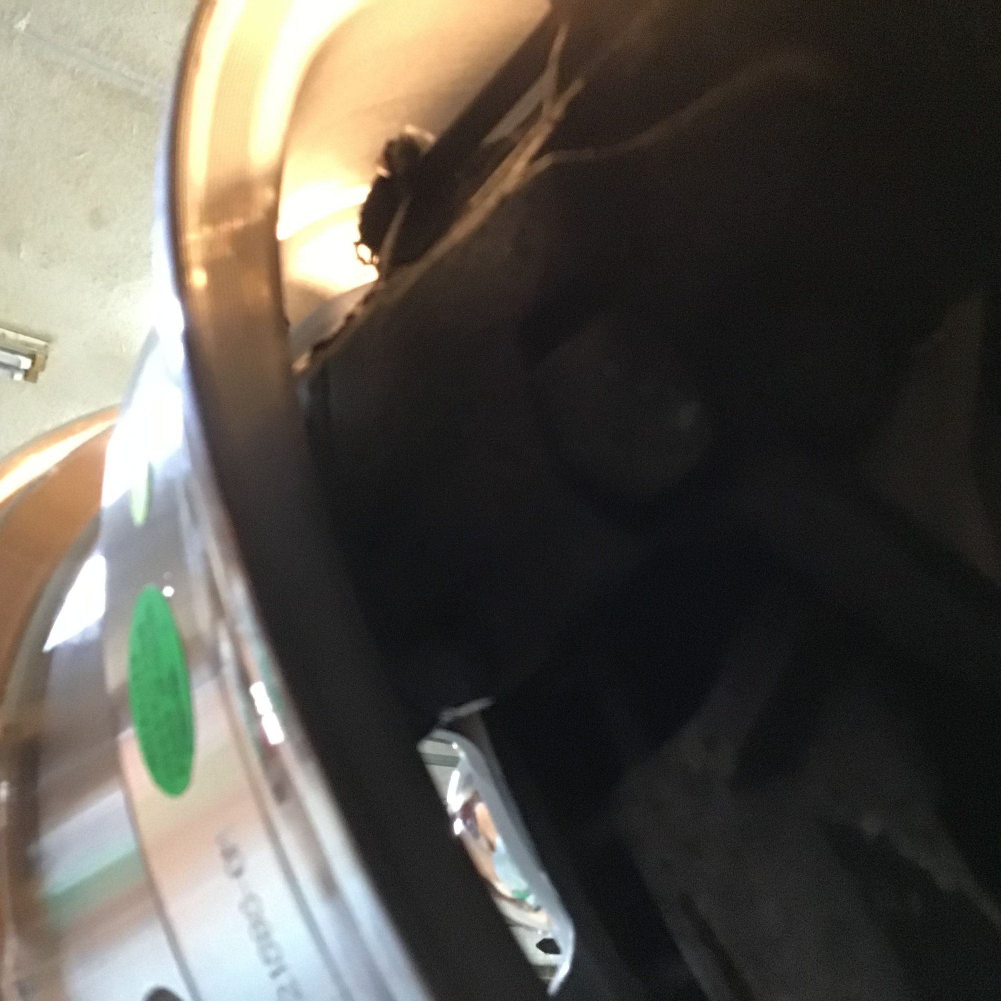

Thanks gjohnson,I found some spacers,I had in my garage,and they are 7/16 thick,and just do clear,the only problem now is getting correct lug nuts that will fit in the holes for the wheels.heres some pictures.

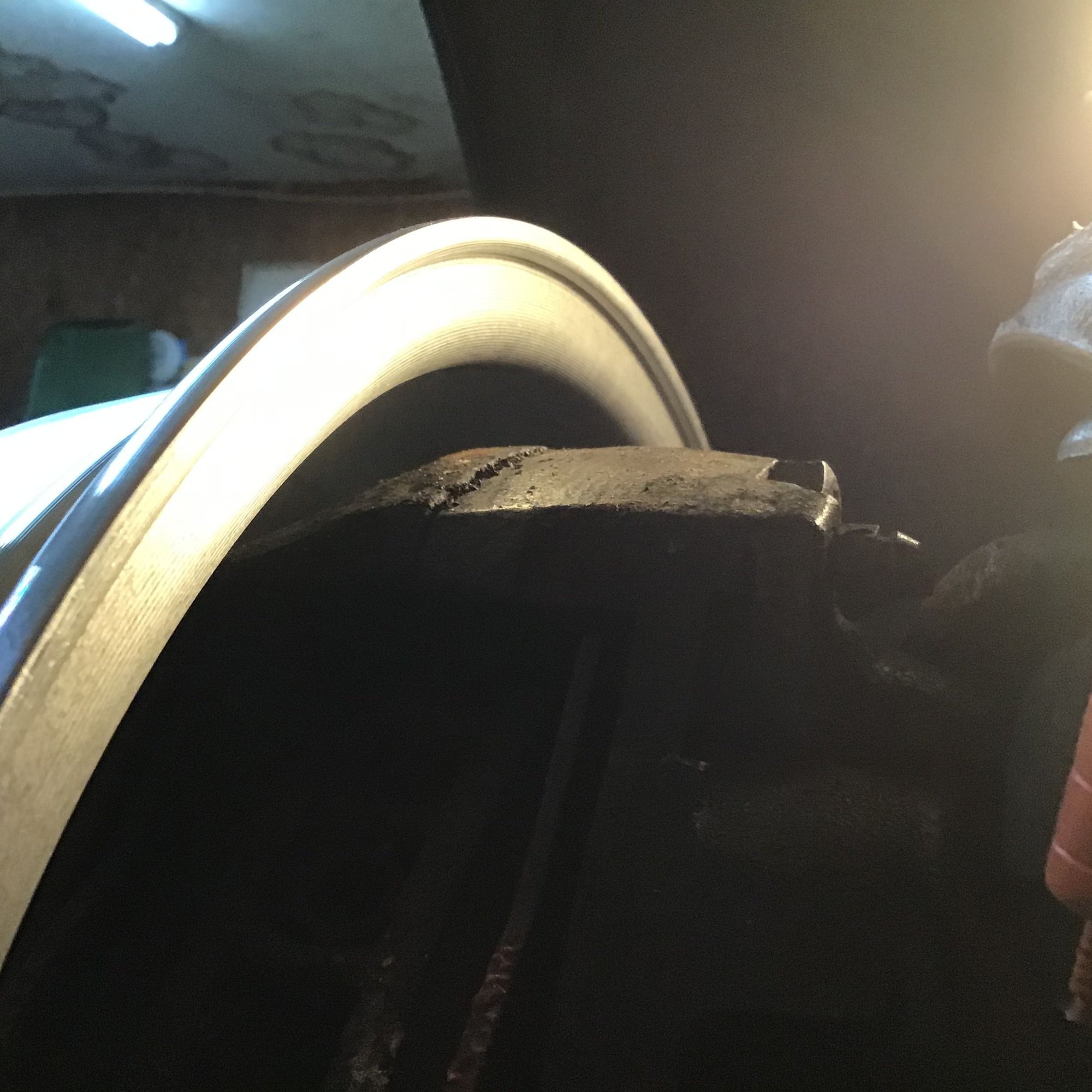

They clear just enough to be comfortable

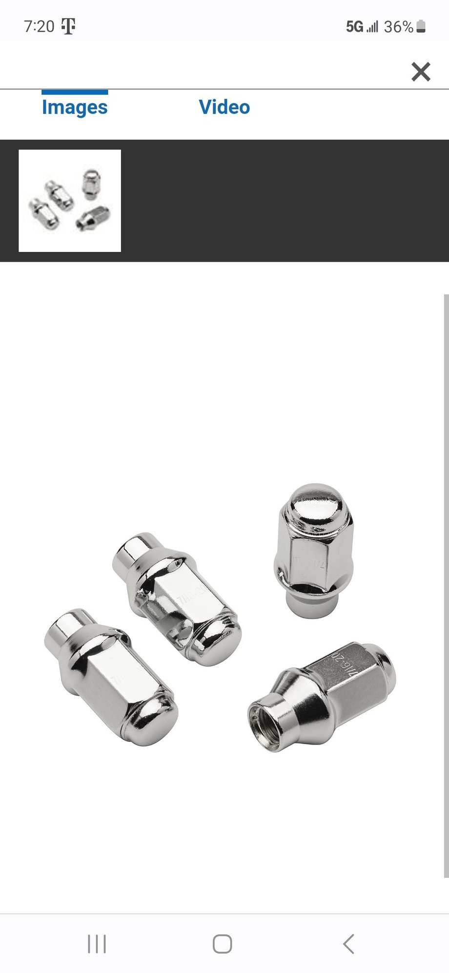

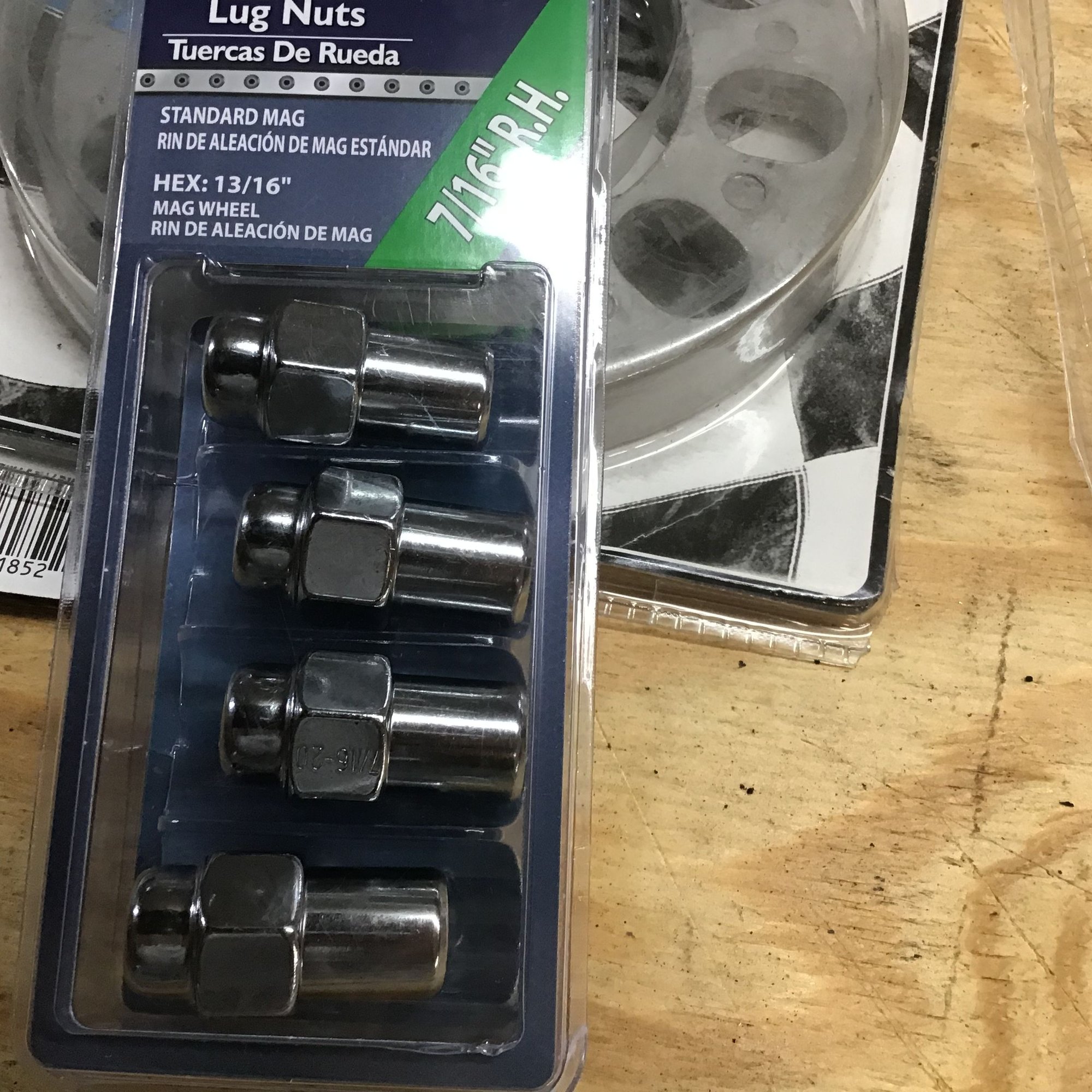

Golfobsessed have you tried to put lug nut,do you have to use a long shank nut,I can’t get the shank is to big to go through the holes on wheels,and the holes need to be a little bigger.

These are the correct length perfect actually,but the shank want fit through holes,they are 0.679,and I need a tad smaller.
I do not need the extended lug nuts as I do not need the spacers however you should be able to find the extended beveled lug nuts on line
I believe they should look more like this

and just my $.02... you definitely want better quality spacers than those

Yea,just happened to have these laying around and yes would prefer that,these are universal,so would like to have a direct fit.
