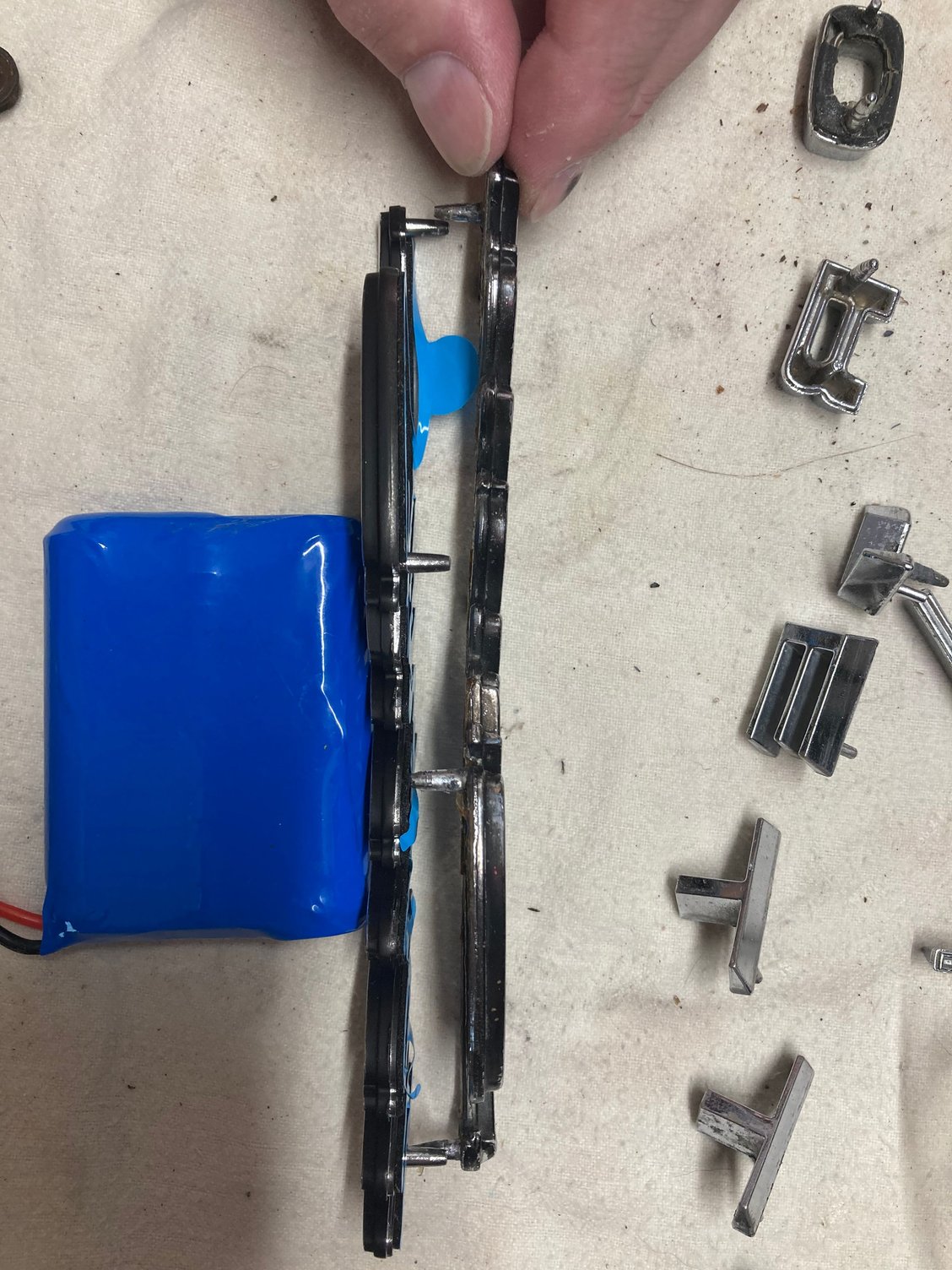

Hello all, I have 3 new reproduction Stingray emblems and none of them will fit in the existing fender post holes.
The old (original?) part fits fine.
The posts on the new ones are off by about 1/16". It was tough to get a pic of this, but hopefully it is clear in the photos.
Could the repros be from a different year (I have a 74)? Or do you think they were incorrectly made?
Any recommendations on getting new ones that will fit? Unfortunately its several years too late to return these.

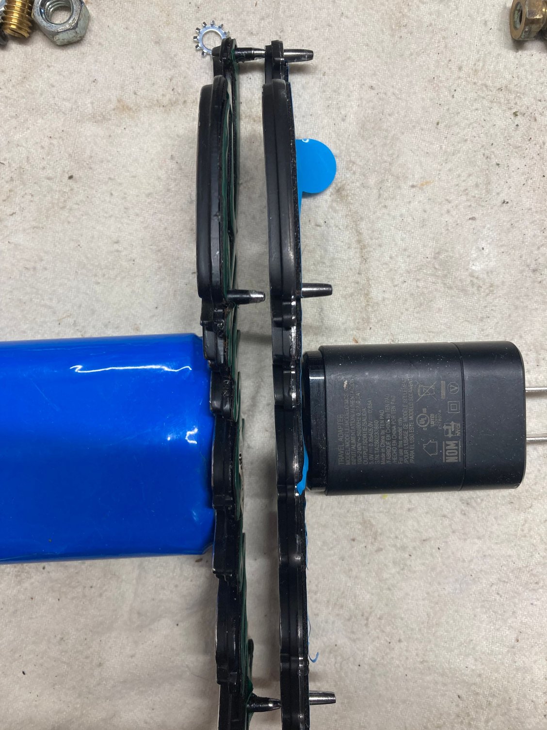

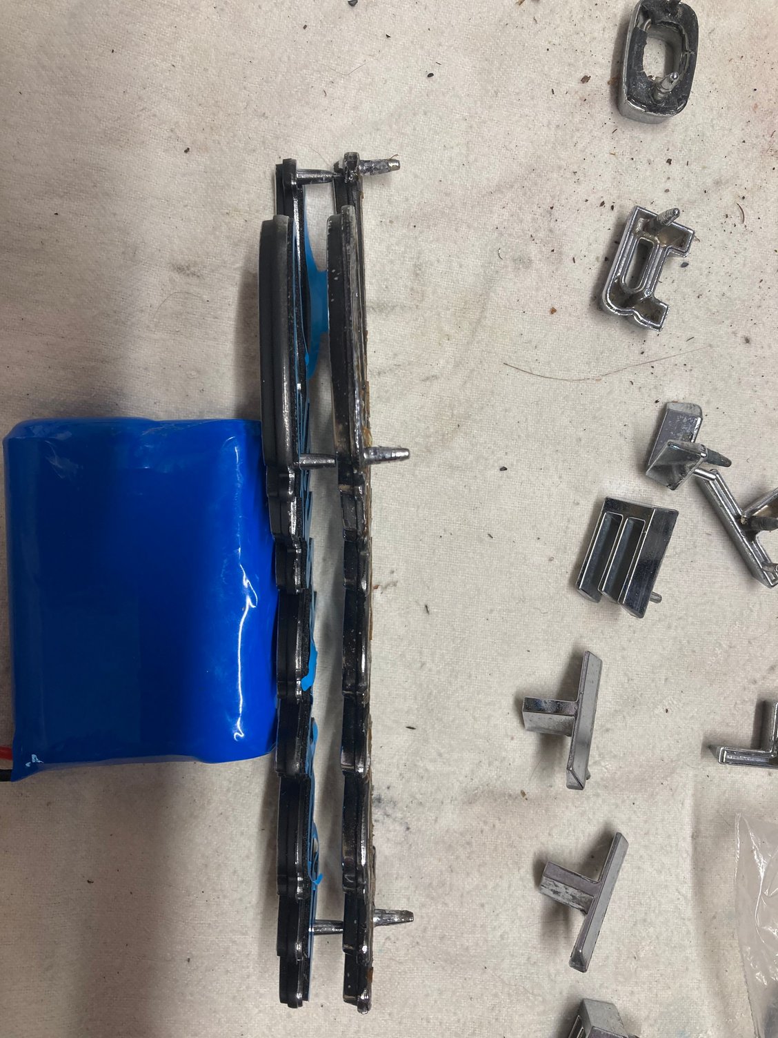

Wanted to follow up, thanks to all who responded. I was able to get some NOS replacements "Made In Canada" off ebay. They worked perfectly.
So the repros were the problem.
The pictures show the post offset of the repros (blue sticker) vs NOS (green sticker).

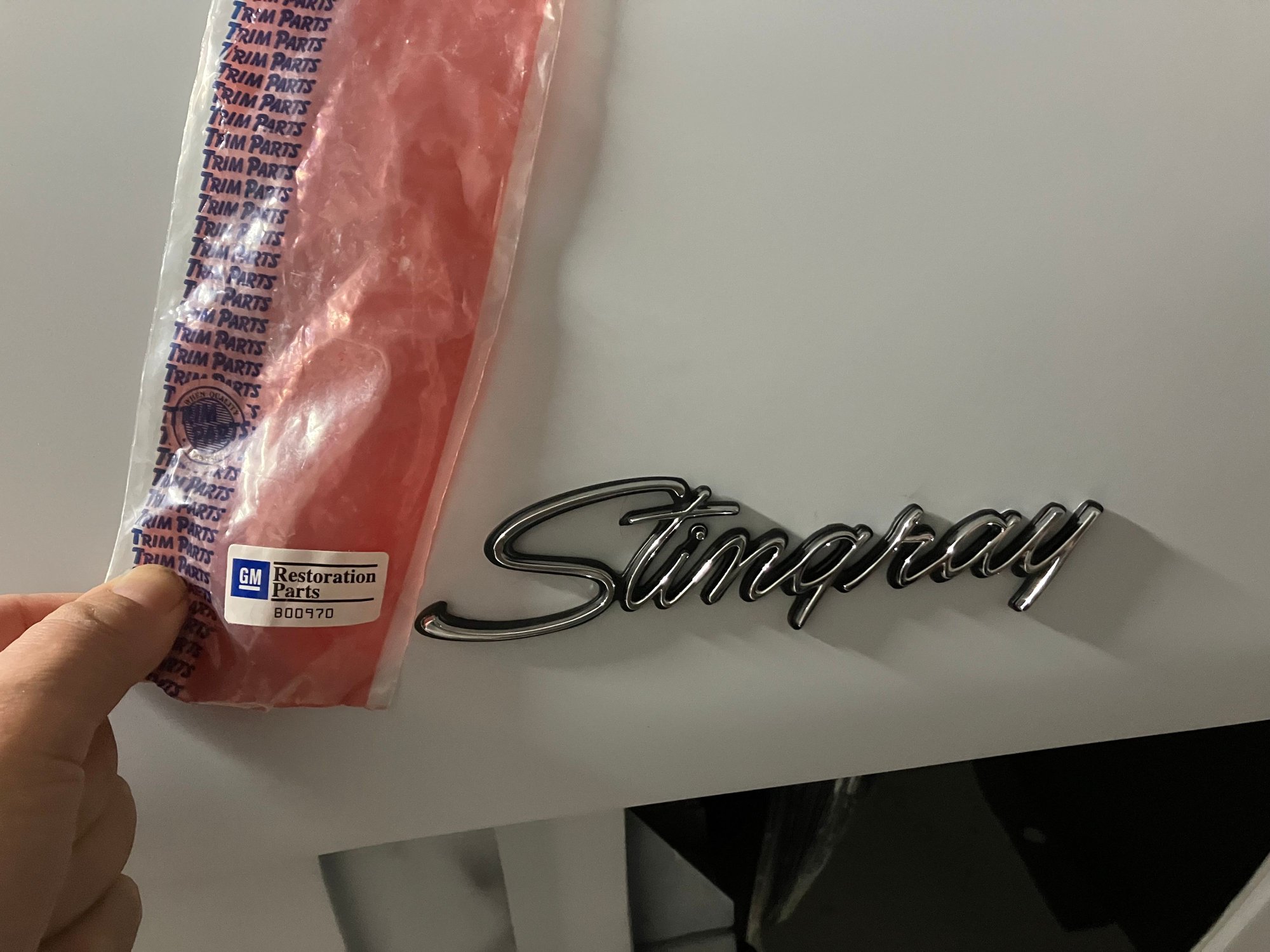

You guys had me worried so I checked the emblems that I ordered they are made by Trim Parts and the quality is outstanding and fit in the factory hole.

Trim parts are the most accurate and I think that all are made in the USA. Lou.
