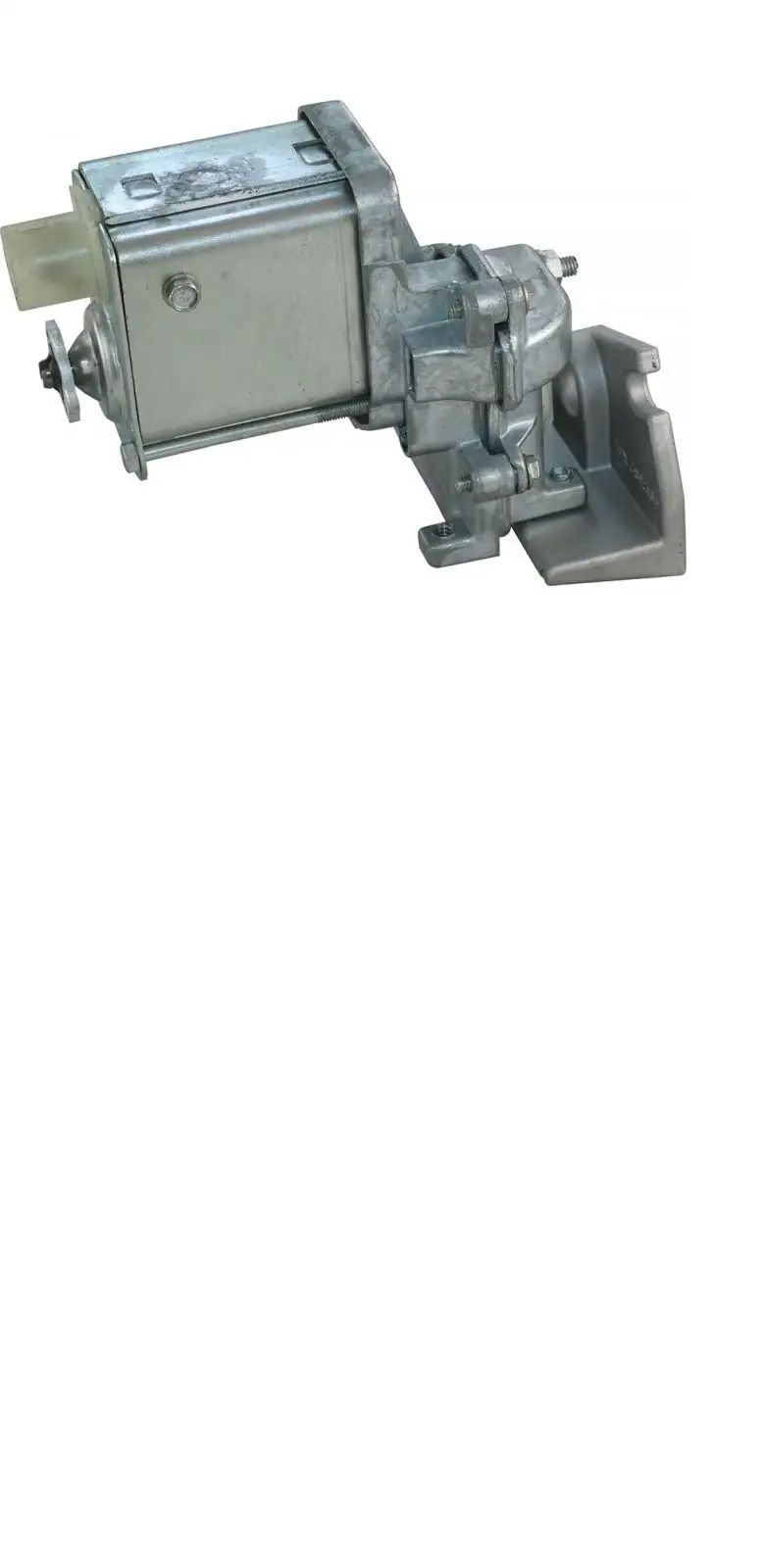

If you are looking for a headlight kit, this is the one to get. Made in USA!
https://www.ebay.com/itm/155261365162
