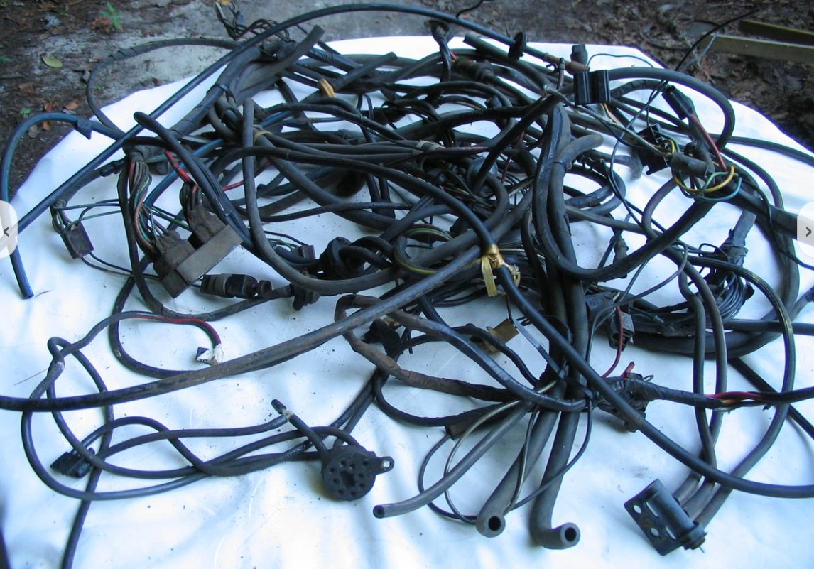

Originally Posted by Tranz Zam
I'd like to whip the engineer who designed the C3 vacuum system with every inch of vacuum hose he used.
I fail to see what you are so upset about!
"I've never seen so many vacuum lines on a car!" FRANKENBRO

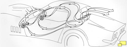

Originally Posted by wadenelson
How about we talk about 'Astro-Ventilation" Does it ACTUALLY exist? Or is it a figment of the marketing guys' minds.
I really wanna know.
I've seen a diagram and tbh it looks like wishful thinking.
Found this: https://www.corvetteforum.com/forums...ntilation.html
required by government to stop people from dyeing from evhaust fumes,, most cars and trucks no longer had a fan setting of off.
lol
I have the same pile stuffed in a box somewhere.
