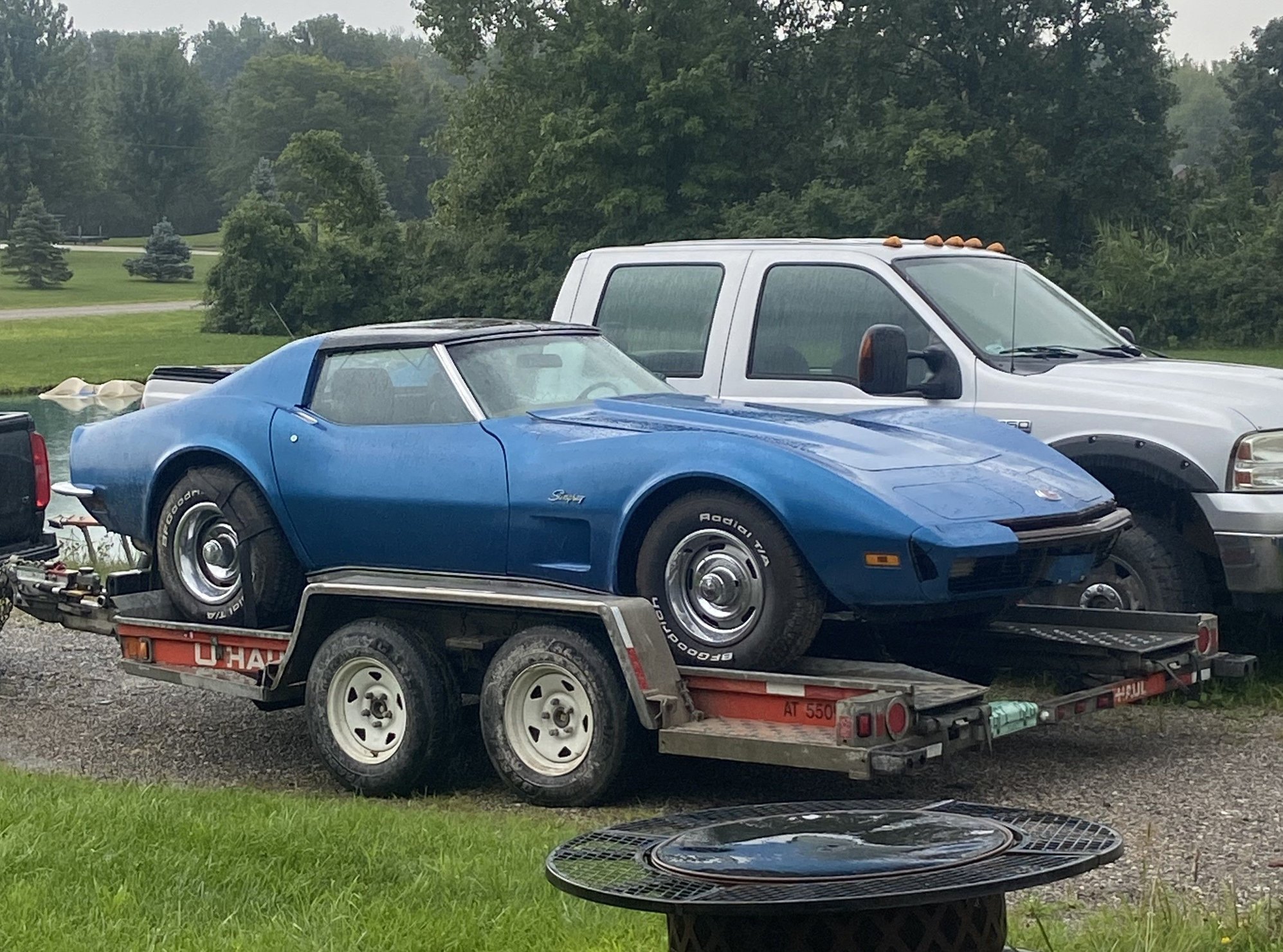

Here is a pic of me bring her home on the trailer.
