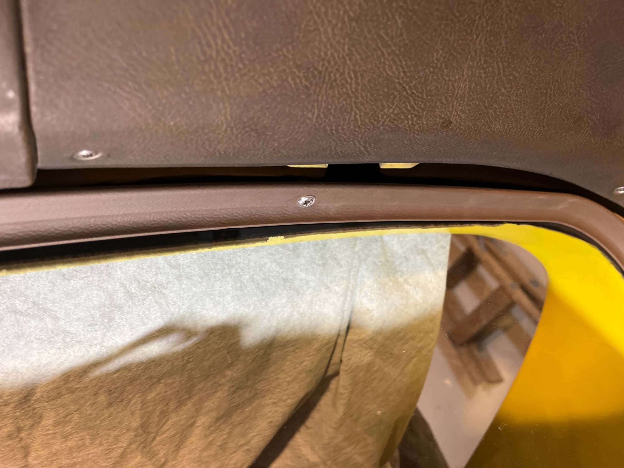

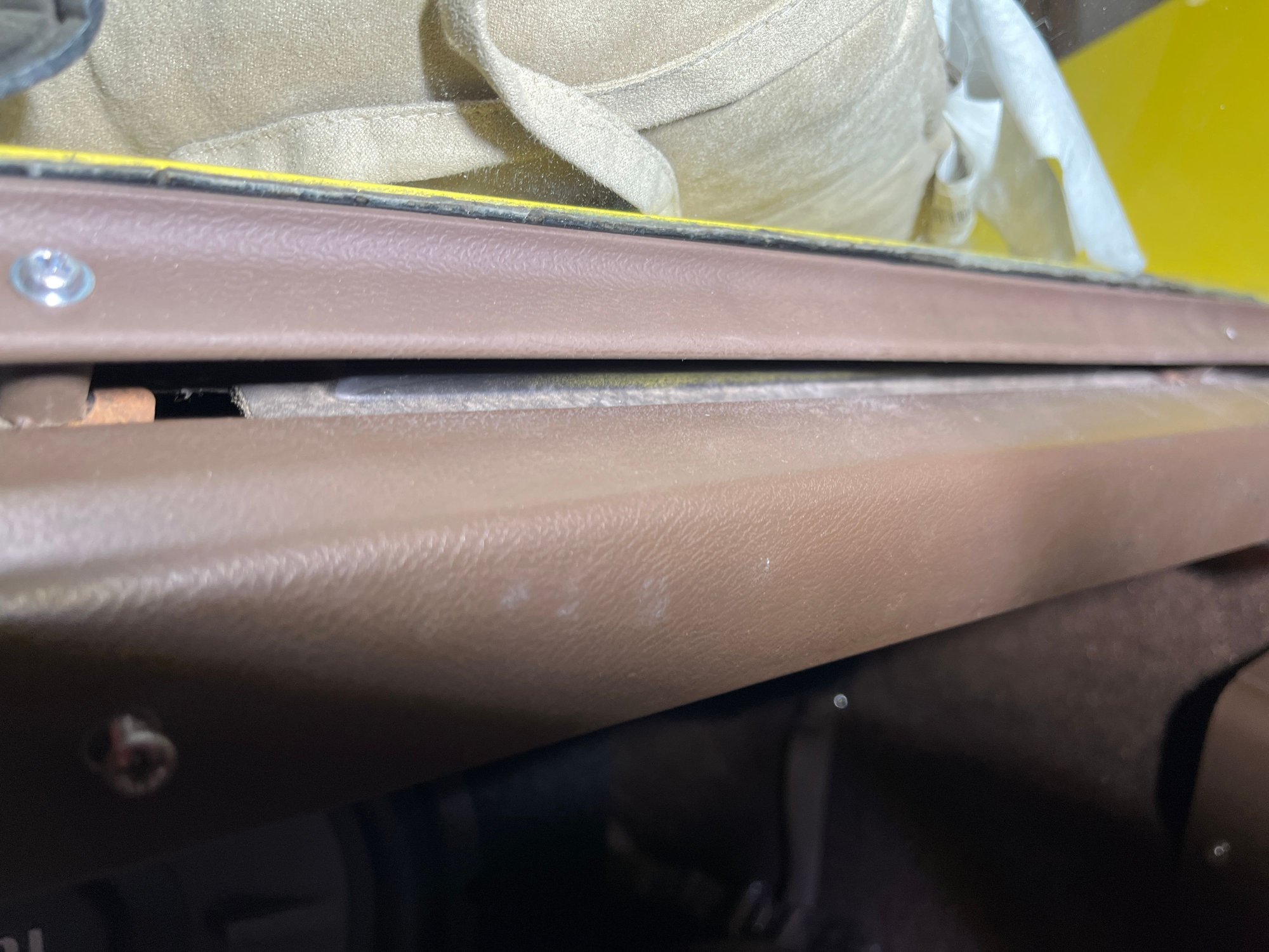

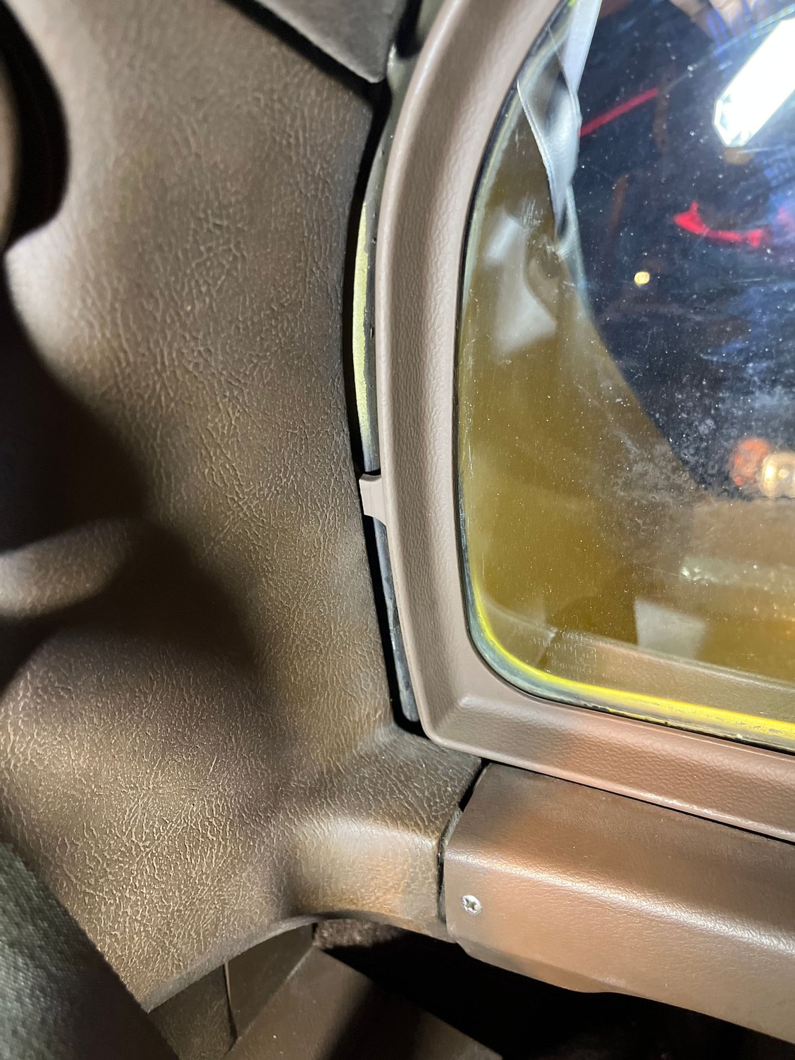

Can somebody please tell me is there something that goes around this rear window gap? I assume there is some thing, but can somebody take a picture of what it might look like. Thank you. It’s a 1977 Corvette. Looks like it’s missing some thing weatherstripping?

I have a 77.....and there is nothing to fill that gap. IMO.....thats the way Chevy built it. It doesn't go anywhere.....the seal is between the glass and the frame.

are you sure about that because it looks really should have something there. I mean there’s square slots they are like some kind of all the weatherstripping would go there but I don’t know can you take a picture of yours to

I to have a 77. Sorry Mate, that's the way GM built it! **** poor fit and finish. The auto magazines of the day just slayed the Corvette for it's extremely poor fit and finish.
Sorry you were expecting better.
On my car I used some Harley Davidson saddlebag weatherstrip to fill the gaps. Looks HEAPS better. But is NOT stock. I'll see if I can get a pic, I know I posted it on here awhile back.

I think it's like that because 68-72's had the removable rear window, and it's frame filled the space nicely. After dropping the removable window, it probably would have taken a major redesign of the birdcage/halo/rear window structure to eliminate the cap, which GM probably couldn't justify the expense for at the time, on such a low volume car. The mid 70's were a tough time for US automakers, between the huge barrage of new safety and emission regulations they were dealing with, a poor US economy and demand switching to economy cars due to the Arab oil embargo, there wasn't much engineering money left over for unnecessary changes.

you’re right about that Chevy doesn’t care. I’m just trying to figure out what to put in there. I get some kind of weatherstripping. I mean it’s even got square slots there too thinking I’m sure they were going to put something in there. I thought I was just missing something other than that I love the car.

The early C3 Corvettes has a removeable rear window. Those square openings were there to accomodate some of the hardware used. And just like many other things, they did not change the production molds after they ceased providing a removeable rear window.......which conveniently works well if a person wanted to incorporate a removeable rear window in the later models. I painted that area that you can see flat black, and it just goes away visually in my car.....although I have a black interior.

I am not 100% sure your inside window molding is original. Something looks "off" in the corners of the trim. And my '77 does not have the tabs.
I find it hard to believe it left the factory like that. Somethings been worked on by somebody with improper tools and skills.
A lot can happen in 46 yrs. Perhaps somebody removed the body off the frame, or somebody installed a non OEM rear window.
