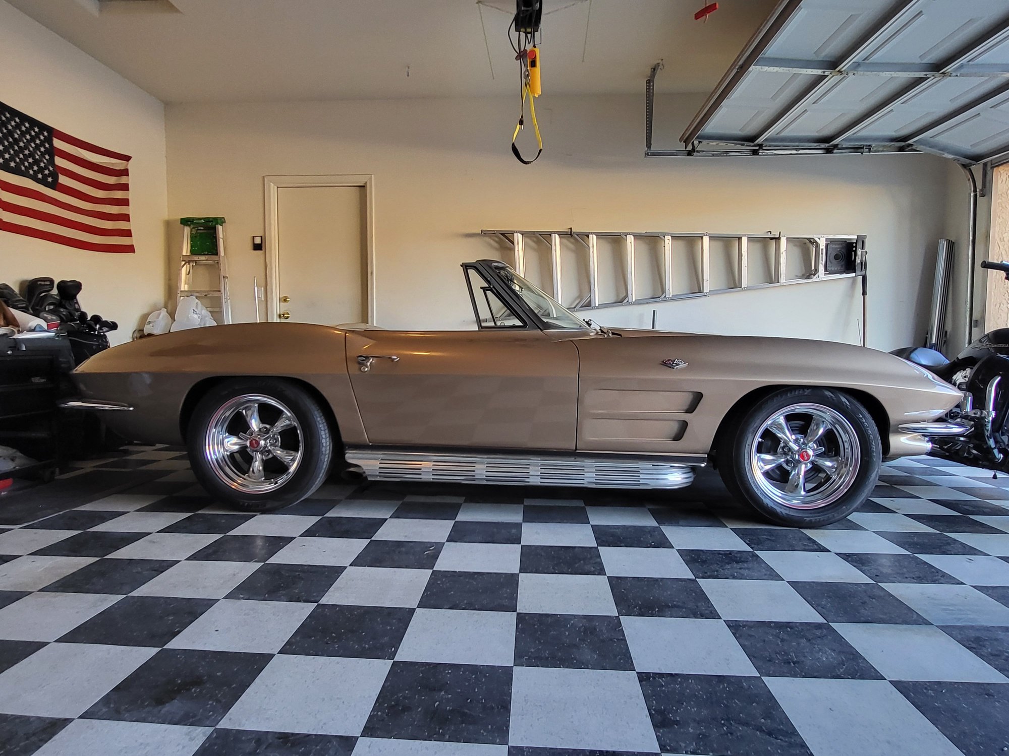

The 64 is 17x8 with 4" backapace torq thrust II and will also clear calipers

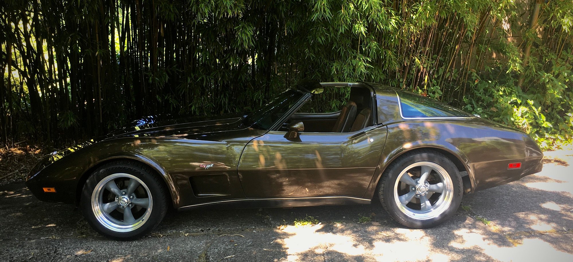

78 with American Racing TT II’s 18x8”, 4” backspace, Continental Extreme Contact 255/45/18. Lowered 1” with Hyperco dual-rate and Vansteel 360 springs. Zero mods needed. Used TT II’s for looks and better handling with shorted sidewalls. Tires selected for good ratings and relatively lighter weight. Marked improvement over OEM aluminum rims with Cooper Cobra tires.
Charlie
