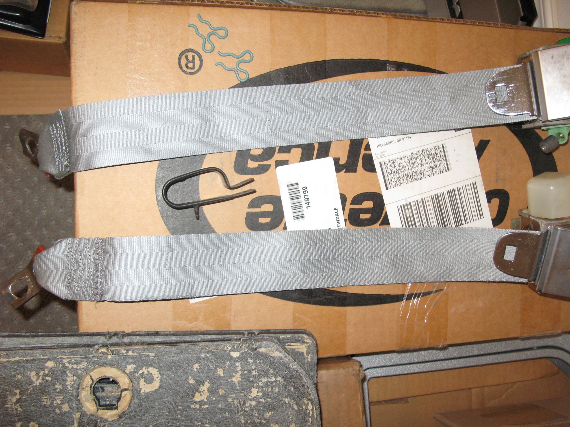

[QUOTE=general ike;1607074738]I hate to say it, but I see it this way, WHAT DO YOU HAVE TO LOSE?? It’s not that much work to get it done and the supplies are not that expensive. So I would try it.
May come down to this. Options are few if better door panels can't be found. I did spray my seat belts & luggage tiedown strap with silver SEM. The seat belts were nasty. My wife soaked and scrubbed in laundry detergent solution to get clean. Think I gave them 2 light passes of dye to dress them up a bit and not feel stiff. Once they get put in the car will decide if good to use or get new ones/send out for rebuilding.
Nobody will be touching the lower carpeting on door panel. Arm can touch the upper fabric. Maybe 1 or 2 passes to see if acceptable?
These were filthy dirty.
Luggage strap got 3 passes of dye.

[QUOTE=RickM Z06;1607076495]
May come down to this. Options are few if better door panels can't be found. I did spray my seat belts & luggage tiedown strap with silver SEM. The seat belts were nasty. My wife soaked and scrubbed in laundry detergent solution to get clean. Think I gave them 2 passes of dye to dress them up a bit and not feel stiff. Once they get put in the car will decide if good to use or get new ones/send out for rebuilding.
They look pretty darn good! A for the wife! LOL
I used Charlie for seat belt cleaning and sewing on the tags. They came out rather awesome. Later, I took the t-top strap to him...he cleaned them up for only the cost of postage to return.
I may take it back to the auto custom upholstery local shop to see if they'll replace that lower carpet. Otherwise, as you note, I'll clean and live with it. I know the challenge of a shop is the 45-year old material, peeling it back from the fiberboard door panel. Who wants to risk that?

Belts look really good!
