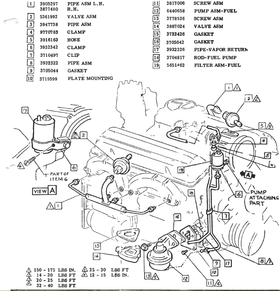

What size bolt is the one that screws in the block??
Old Oct 28, 2023 | 02:23 PM
cottoneg's Avatar
cottoneg
Joined: Nov 2007
Posts: 1,716
Likes: 279
From: New York
I do not see it here
