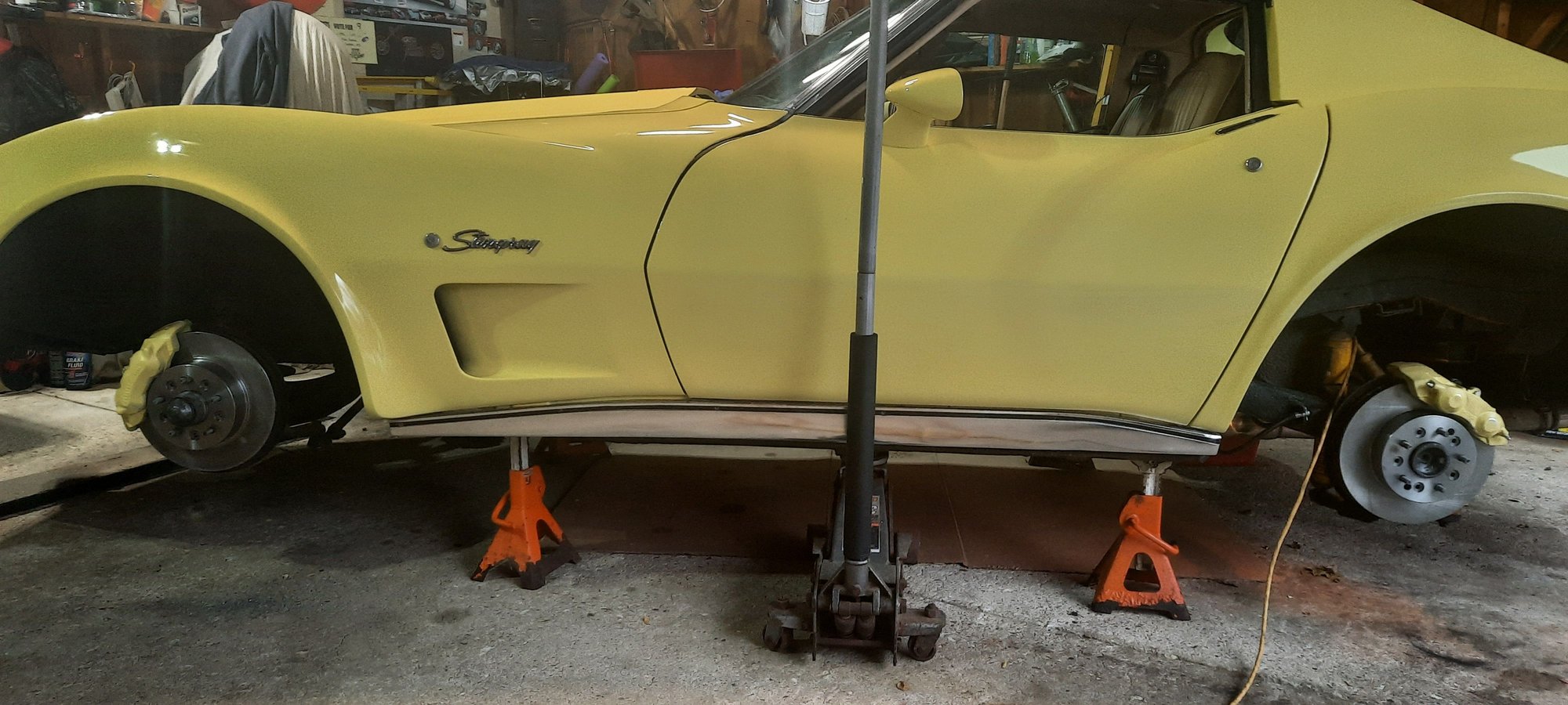

245/60/15 x 7 fronts, 255/60/15 x 8 rears.
Just replaced my rotors and calipers(painted to match car color)
what say C3G?
