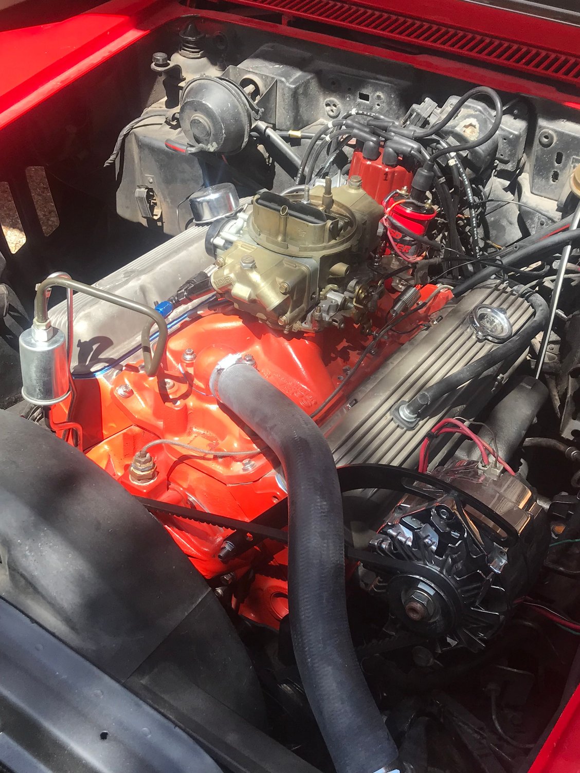

Default Different heads on motor
Hello everyone, got a question and need advice, so working on my 73 coupe I discovered that it has two different heads on the motor. Passenger side has #3927186. GM 13 Driver side is #3927185. GM 54 1A180. So it turns out the drivers side is 74CC head and the passenger side is 64CC How much does this make a difference in how the engine runs.
thanks
scott

Bubba strikes again. It obviously works and kept the car running and on the road. Is it delivering the best performance, likely not. Look at the bright side, install another decent 64cc head and you’ve certainly corrected the compression imbalance and improved the engines performance potential. I’d be wondering what other mismatched components lay beneath the surface in your engine though.

How does it run/rev/idle? I’m really curious. Half the cylinders are probably 9.5:1 and half are 8.5:1.
maybe Bubba was more clever and used two different thickeness head gaskets to make up for the difference in combustion chamber size.

Well it really hasn’t run in over 15 years been in storage. But with that said I just replaced gas tank, carb, shocks, But it seems to run alright the odd side does smoke when it’s running. My concern is what’s it doing to the engine.

Can't be pushing evenly on the crank. But that said maybe Bubba did put a shim gasket on one side? A simple compression test could give you an idea. A new set of matching Aluminium heads might be a great idea!
