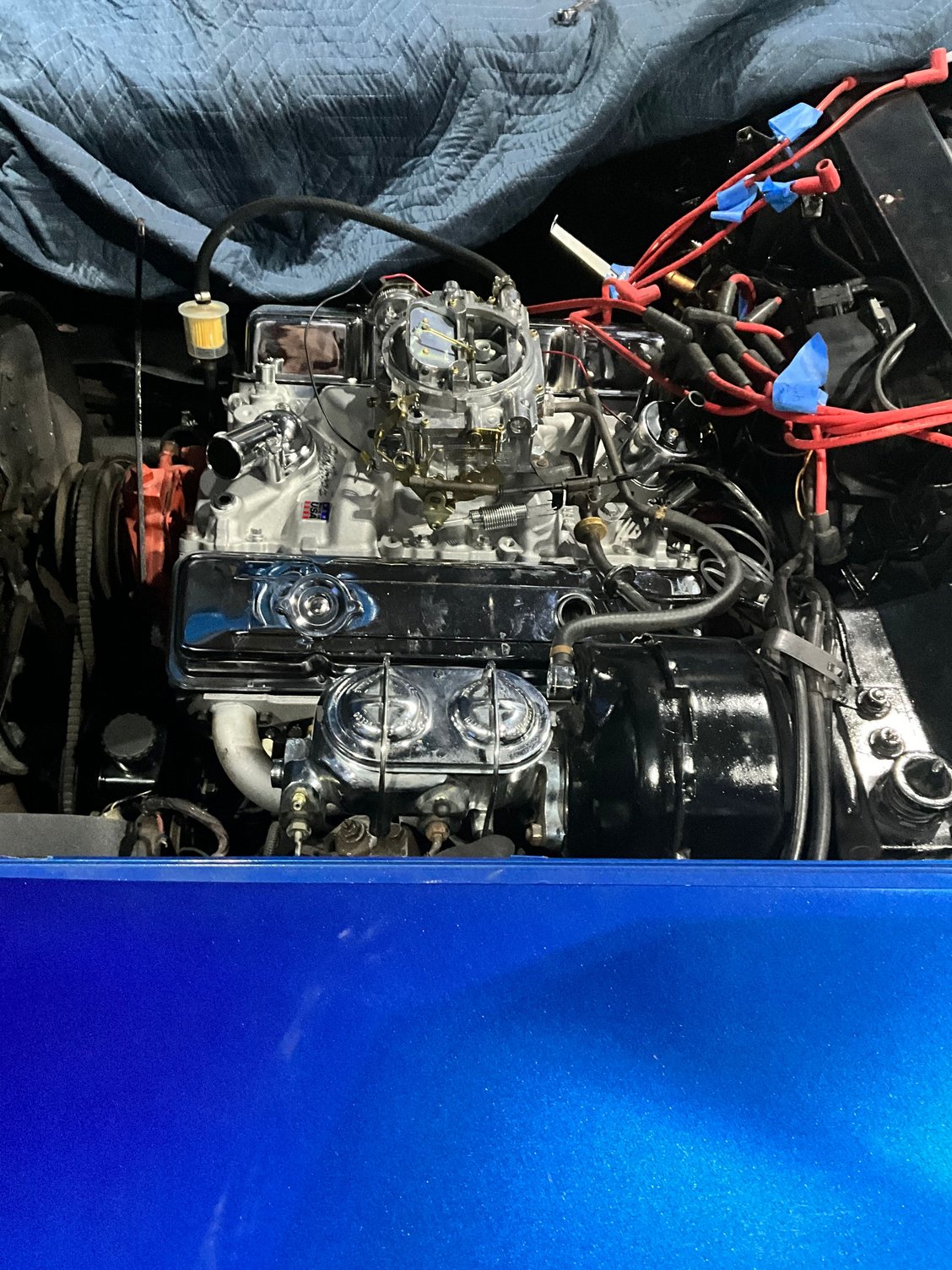

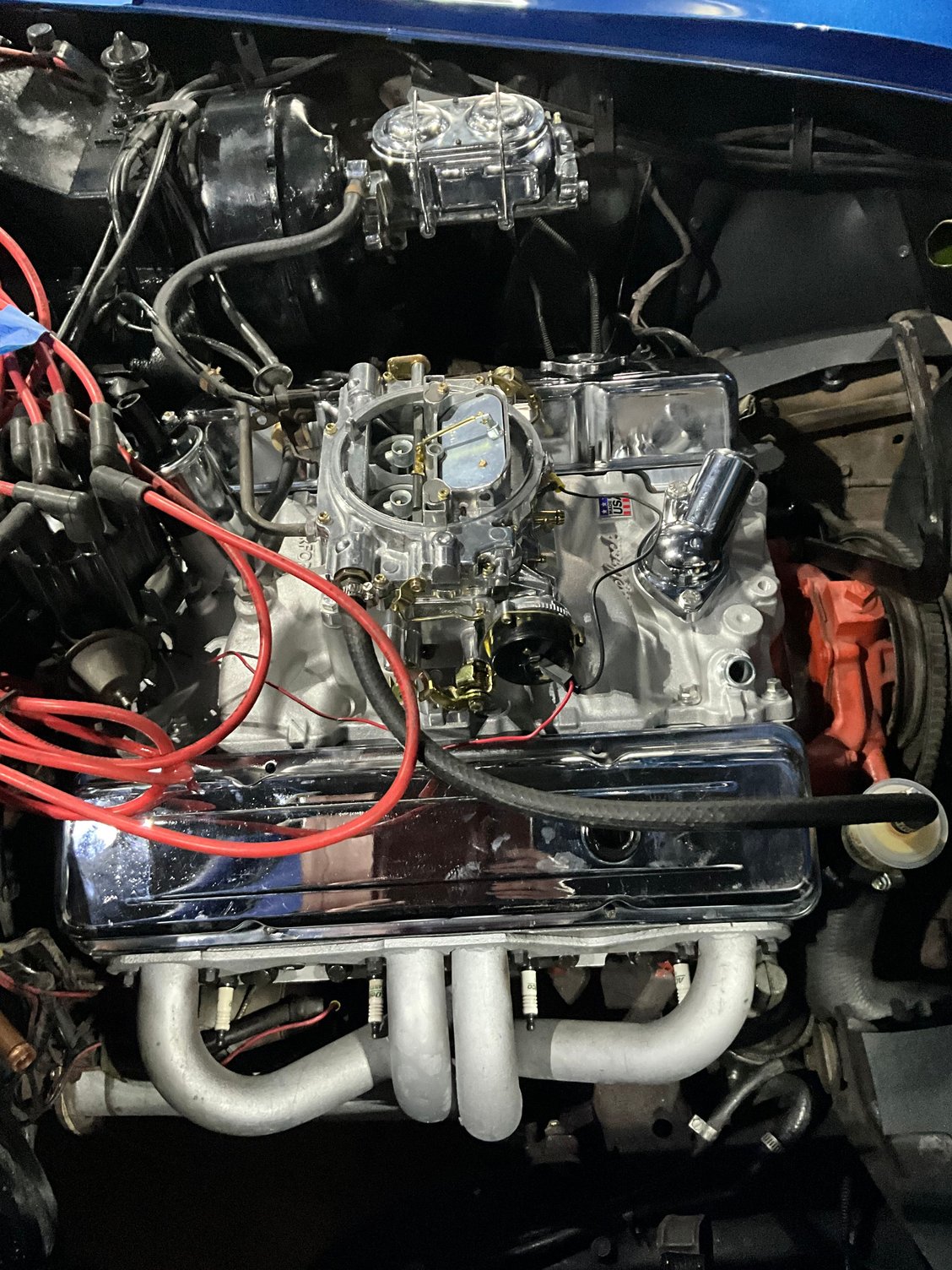

Well heads are on, top of motor is back together one small problem.. #6 spark plug is actually sitting on the header. I can’t even get the boot on it. If it isn’t one thing it’s another. And oh yeah I am fighting to get the bottom radiator hose back on and it’s winning

Wrong plugs for new heads is a guess.

Did the plugs in your oem heads go straight in or were they angled? (never mind I looked back and your old heads look to have straight plugs).
If you can’t get the clearance you need by denting the header tube, you may need to try a short plug or a new set of headers for straight plugs.
Are your headers long tube or are they short tube block huggers.

I believe they are short tube headers. I thought when I was buying the new heads they were straight in plugs I did not see anything about these heads being angled. But I guess they are angled. Can you get shorter plugs for a sbc 350
