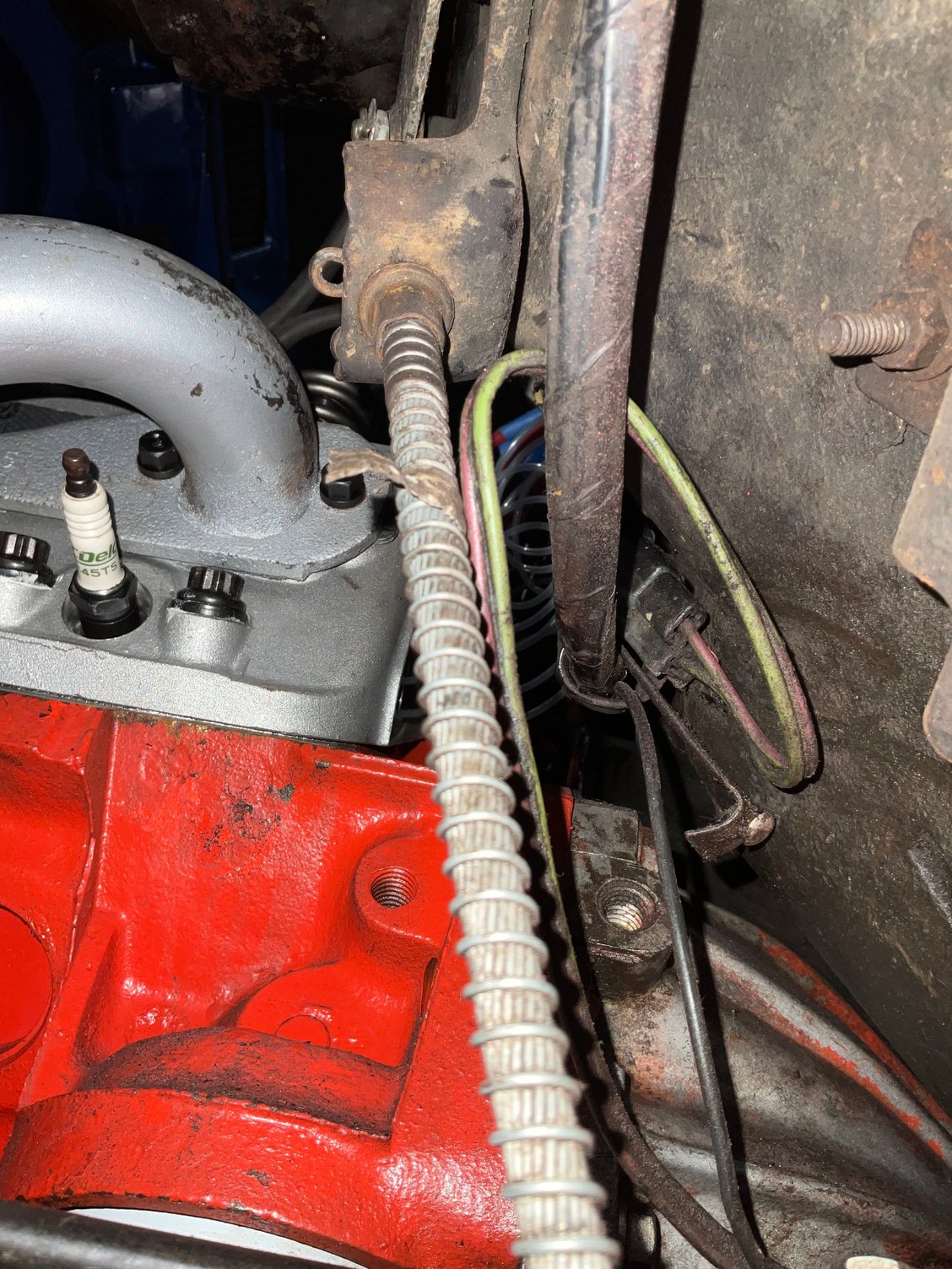

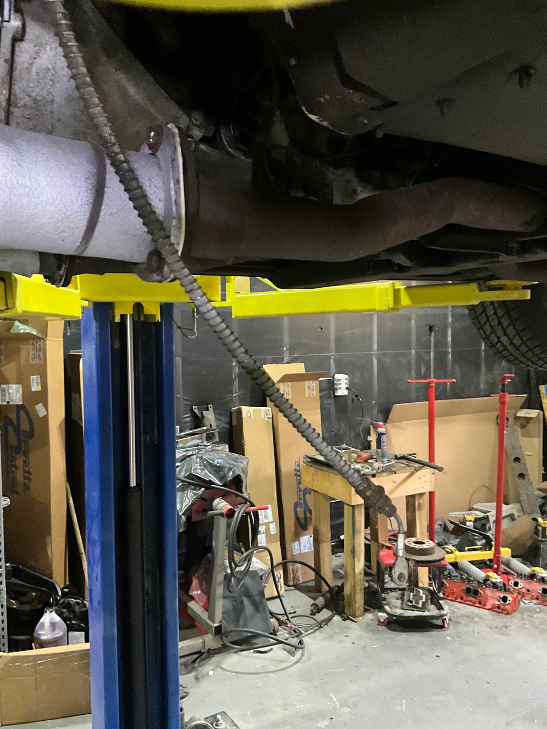

Now's your chance (and excuse) to get long-tube headers.
I believe that cable is the ignition interlock. Many folks remove the cable, and then lock the lever in the up position to bypass the system.
Here's a sticky on it, with pictures.
https://www.corvetteforum.com/forums...lfunction.html
thanks for the link. That explains it. Now my question is is this only on a automatic or did it appear on the manual as well.
The quoted text from Jim Shea indicates it was common to both auto and manual.
Here's a recent thread where the interlock lever was an issue for a 70 4-speed.
https://www.corvetteforum.com/forums...ock-lever.html
Can someone tell me what this is.
it’s a cable hooked to nothing tucked up on top of the transmission. It connects to what looks like the steering wheel.
The headers shown in these pictures are long tube headers and not short tube.
Looking at the older pictures in your thread, your old heads had straight plugs and so do the new ones.
I would go on Edelbrock’s website and see if they show the proper plugs for those heads and if it’s not on there website, I would call their customer service.
Are the headers new or were they the ones that were on the engine before the head swap.
Are the exhaust ports raised on those heads or are they standard port location.
On this last picture, the plug doesn’t look like it’s not installed properly, as stated above, these may be the wrong plugs.
the headers came on the car. I had just put those new plugs in the old heads and they worked fine. Wondering why now number 6 plug is on the header. The exhaust ports are not raised. Now I did notice that when I went to put the headers on there was two bolt holes on either side of the head other then just the one I used to put them on. Hopefully I didn’t miss align the one header on the head that will be the task for today
