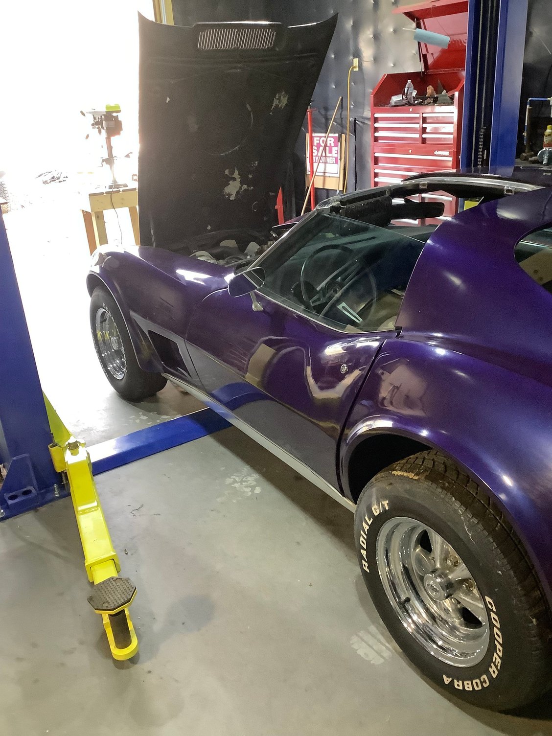

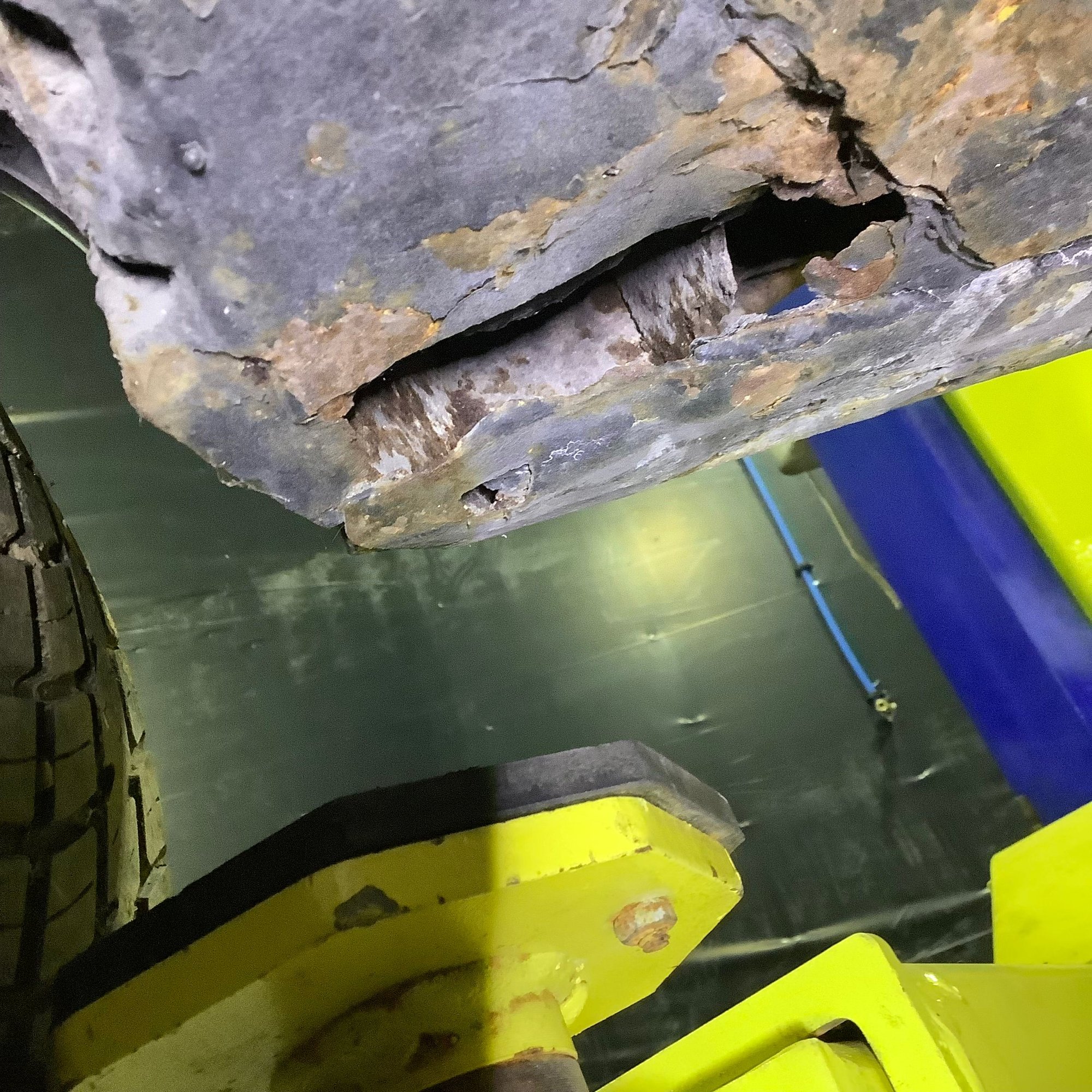

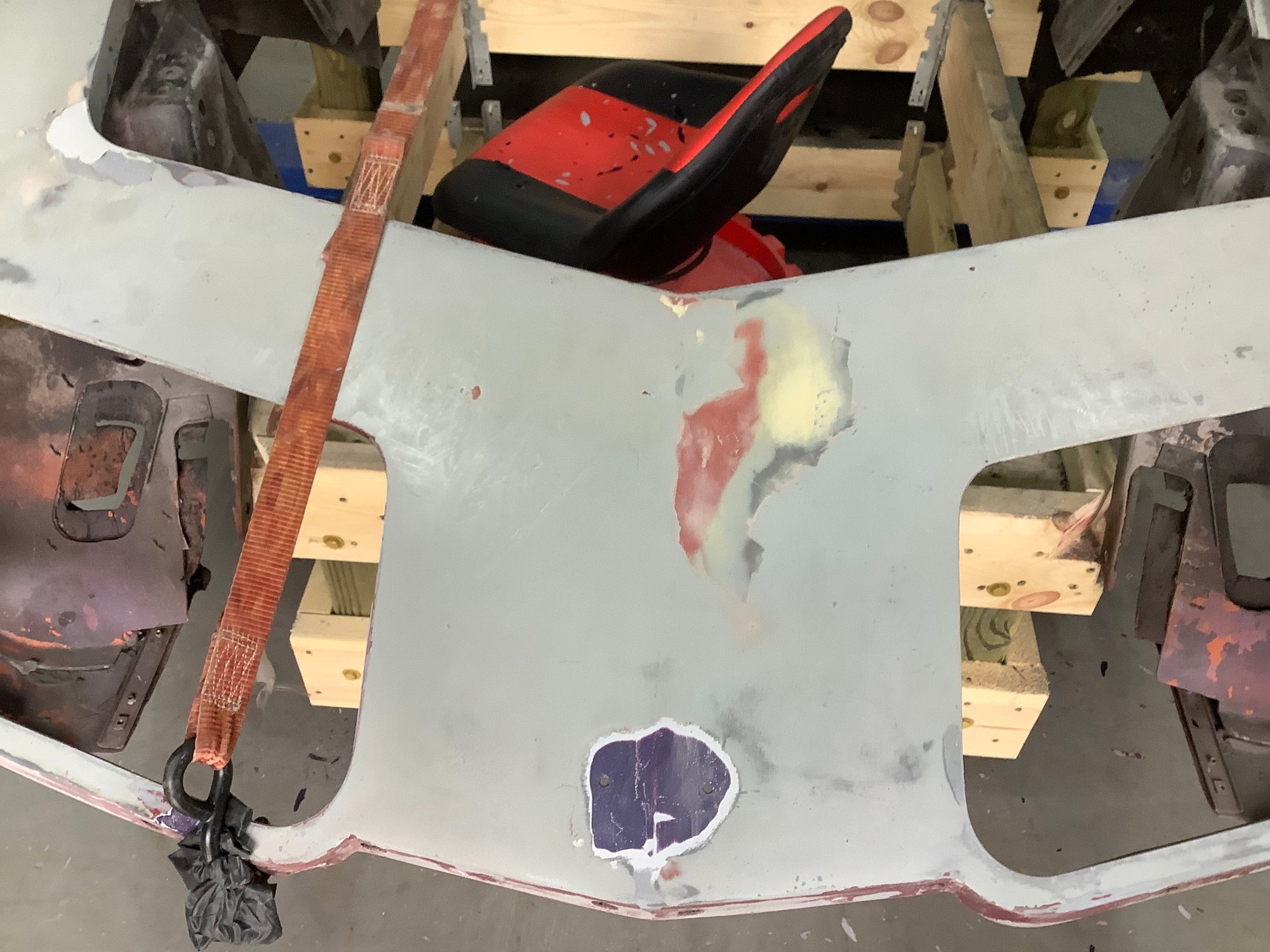

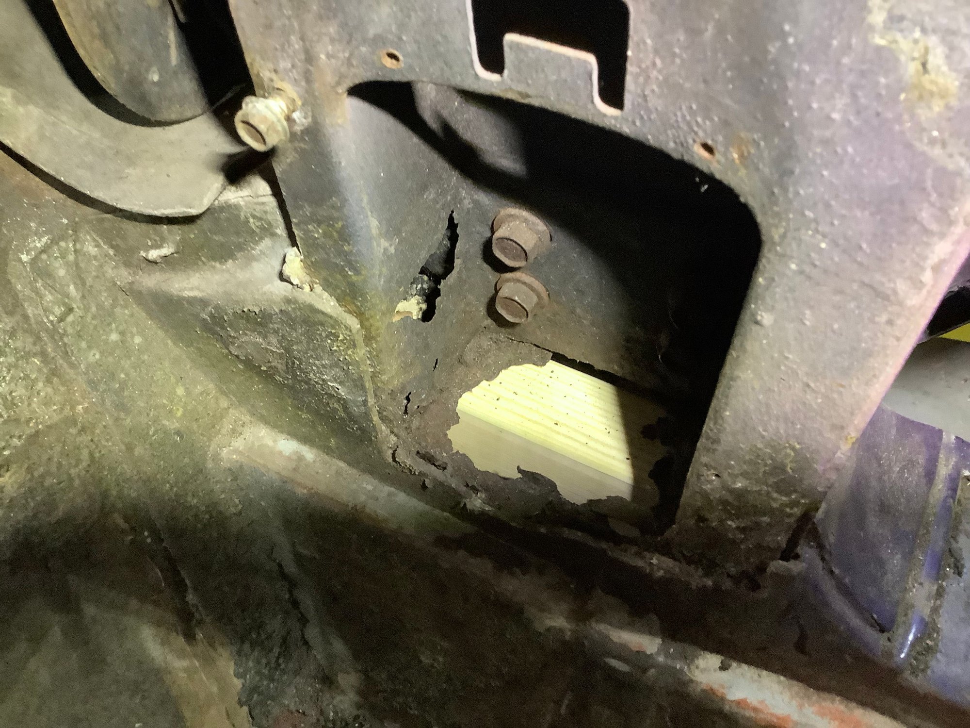

well here are some pics

Well...It looks like you are well into it! lol
I see you have a nice lift and tool box...That tells me you wrench some..
What is your skill set? Can you do paint and body?
Engine? Chassis? Willing to learn and try?
At least the bird cage looks pretty good on that top corner...
Does the rest look like that? Did you remove the front clip to get to a rusted A-pillar?
I'm gonna let some other's chime in on this one...
But in the meantime, I think you need that good spreadsheet of realistic costs for minimal restoration...as well as one for part out...
More pictures will help generate better opinions in the forum...

yes I have a decent garage set up. For DYI. I can rebuild engines, brakes suspension, wiring interior. No transmission experience, no body work especially fiberglass. Or welding
front clip is still on. Don’t even want to go there I have already added up my new parts receipt they total over 7,000 dollars that I have spent already. All parts are on a shelf waiting for next step. When the frame gets done

If I am seeing this correctly, the first three pics are of #2 frame & body mount (A-pillar) on the passenger side?
Or are they #3 mount on Driver's side?
It is almost unrecognizable...Is that a piece of sheetmetal bonded over the hole in the frame?
Looks like they bondo'ed the crap out of the frame to hide the rustout and then undercoated over it...??? or roof tar?
And it looks like several layers have been applied...
From these pics, it looks like that frame is toast...
I hate to see the stuff people do to deceive others...
The A-pillar bottoms are repairable...

yes first couple of pics are the bottom of the frame at the corners.
other are of both driver and passenger side # 2 body mounts

Those sections of frame are definitely repairable. But how is the rest of the frame? The number 2 mounts in the bird cage are definitely repairable, they sell inserts for these as this is common.
but how is the windshield frame?
If the damage is isolated to these areas it's definitely fixable.
As far as how much your sticking into it money wise, I'd hate to add up what I've put into mine over the years. And it's on going.
Sounds like you'll have a nice car in the end.
hello 4-vettes. Yeah I have already got the new #2 body mount replacement rocker channel for both sides. To have them cut out and re-welded can anyone tell me if you have to separate any fiberglass panels to do it or call they be replaced without touching the front fiberglass panel.
the weld shop said he would tackle the frame but if he got into deep with cutting the frame up he would tell me first that I should consider getting another frame.
