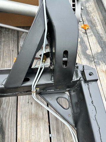

I am looking for some advice on getting my frame repaired. In rear on either side of the frame there gusset that reinforces the frame. Both sides of the frame have like a pocket in the frame. Can I have a piece of flat steel welded in both corners to replace the rust holes with out causing a problem to the body fittings back on the frame I took a picture of the area I am asking about. This picture is not my frame but the area of the frame

Are you referring to the horizontal triangle shaped gusset basically on the bottom of the frame forward of the crossmember? Yes you could. You can see the number 3 body mount in the photo you provided. It's on top of the outer frame rail. Fuel lines on both sides! Be very careful!

yes both gussets on either side have to be cut out and welded back on with new ones the indenions where you see the gas lines go. My welder says he can’t reproduce those indentions but rather just weld a flat piece of steel from where it’s flat to the corners. Will that cause a body fitment problem

are asking about this flat piece here?

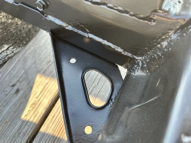

Those gussets are available from ZIP and a few others...About $30 each
If your main frame rails are rusted out...(Where you circled in black)
Time to find another frame...
yes I have purchased them. My welder wanted to know if he welded a piece of flat steel across the concave area of the frame towards the rear where the gusset goes to help strengthen that area of the frame since he has to cut a lot of the frame and replace it with good steel.

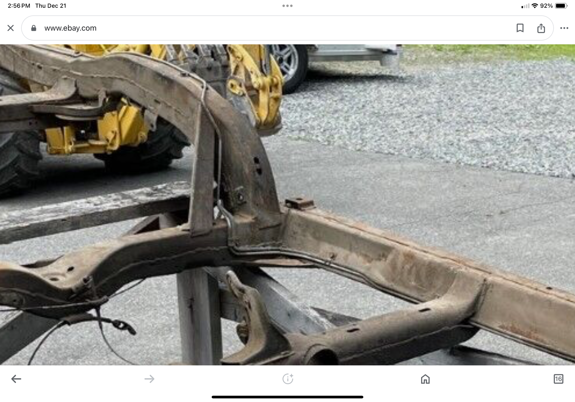

There are a couple of frames on ebay...One has been blasted and painted for $1600
(Not Affiliated)
https://www.ebay.com/itm/31496734224...Cclp%3A4429486
My concern is that if your frame is rusted through in a few spots you can see, be assured there are places where you can't see...These frames rust from the inside out because the stitch welding lets sand and dirt get inside and these sediments hold water...I'd hate to see someone put so much time, effort and money into a car with hidden frame issues...

I did look at that frame on eBay it’s way up north but yes it looks fantastic. My frame looks like it has rust in the rear corners were the gussets are rest of the frame looks solid. But like you said rust I can’t see is going to show after I sand blast the frame. This project just keeps getting better. As I said in a previous post the number 2 body mounts are gone and I mean gone like there is nothing but a big hole where the bushing should go. So now I have to fine someone that is willing to replace them with new rocker channels.
That frame looks really good and is only in Missouri... not that bad to North GA...
The best thing is that it has already been blasted and painted! That saves you at least $500 or $600 there!
I wasn't aware of your other frame issues with the rusted off body mounts...For me, this is a no brainer...
