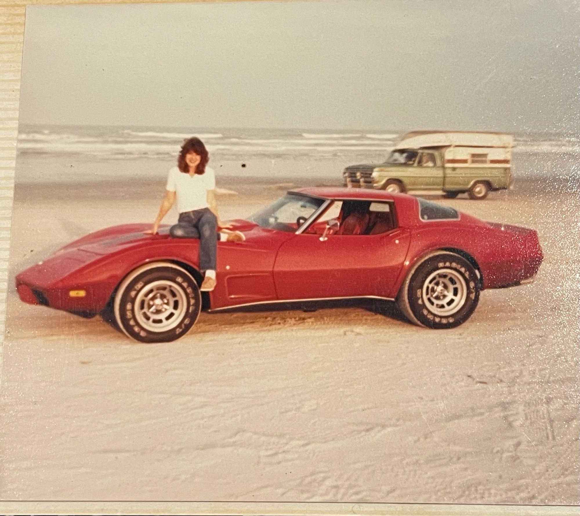

SmokeyC6's Avatar
SmokeyC6
Joined: Aug 2023
Posts: 54
Likes: 10
From: Portsmouth VA
Originally Posted by stingr69
Stock Ride Height and tire size. Maybe 1/2" rake.
My '76 on the beach at New Smyrna Beach FL. I had a 1" lift in the rear and 275-60-15 rear tires. This was if Feb 1980. Yes, it had a C2 coupe rear window.
I'm glad you wrote that; I was assuming the car was a mis-identified 1978!
