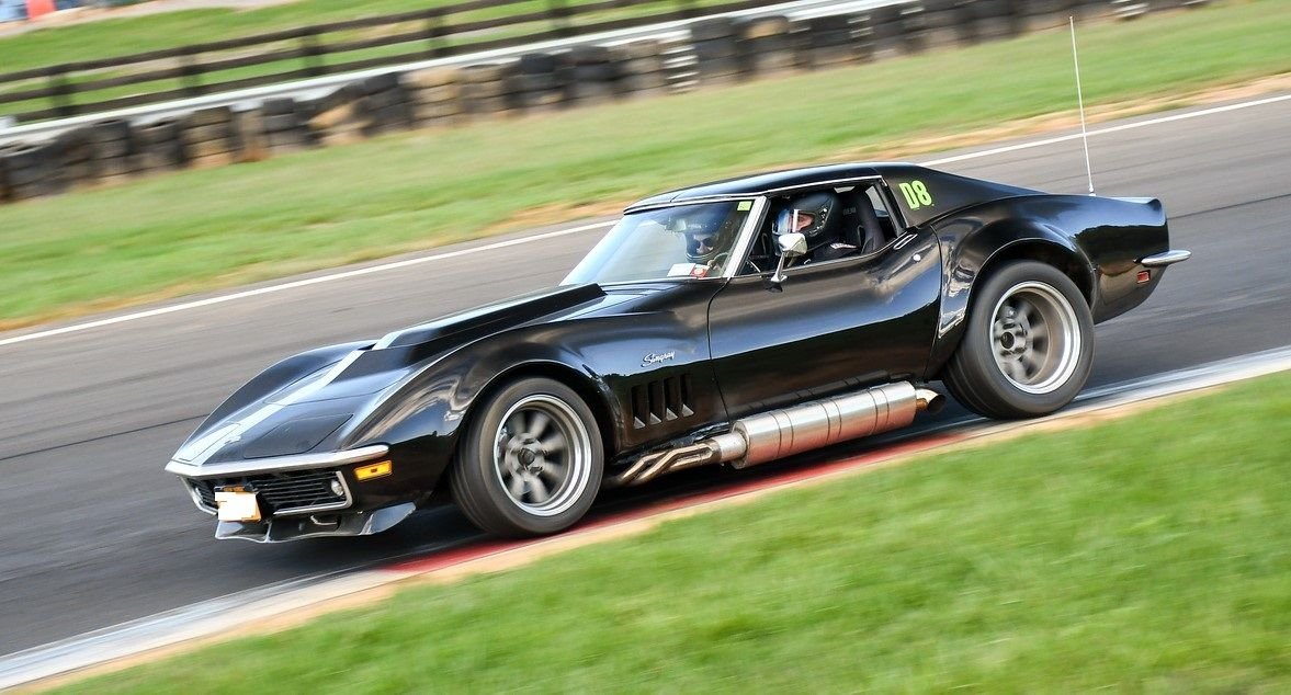

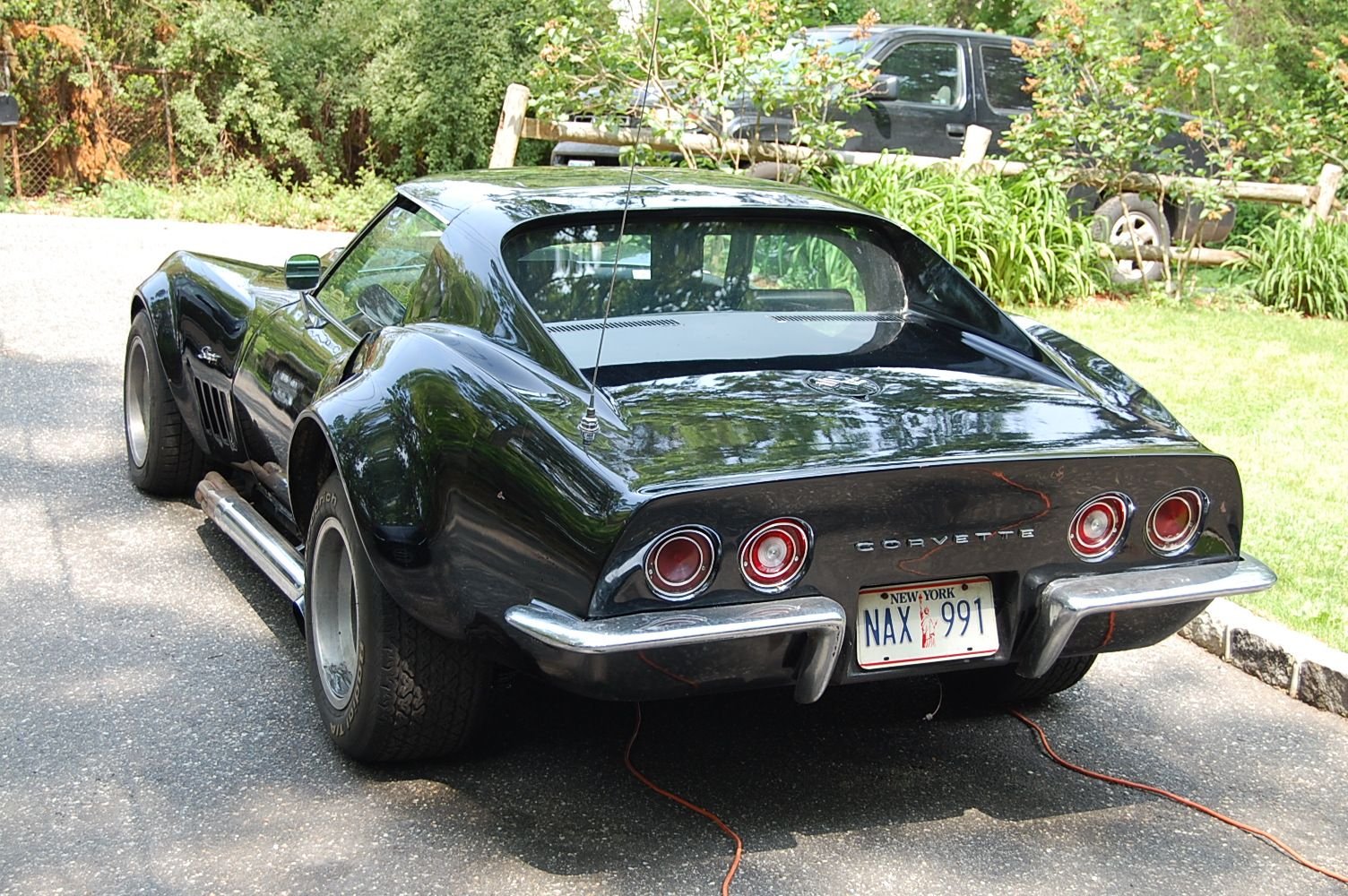

I have a 1969. The flares were originally purchased from Chevrolet back in the day when they sold things like factory flairs and real L-88 hoods. But I digress…
This pic is when I ran 15-inch rims and B.F. Goodrich tires. Originally, they were the old H50-15 (I think). 10 inches wide.
I abandoned 15-inch rims when you could no longer get street/track tires. I went to 17-inch rims and now run Michelin 335/35-17 in the rear.
Please note that somewhere along the line, I relocated the emergency brake cord holder on the rear control arm.

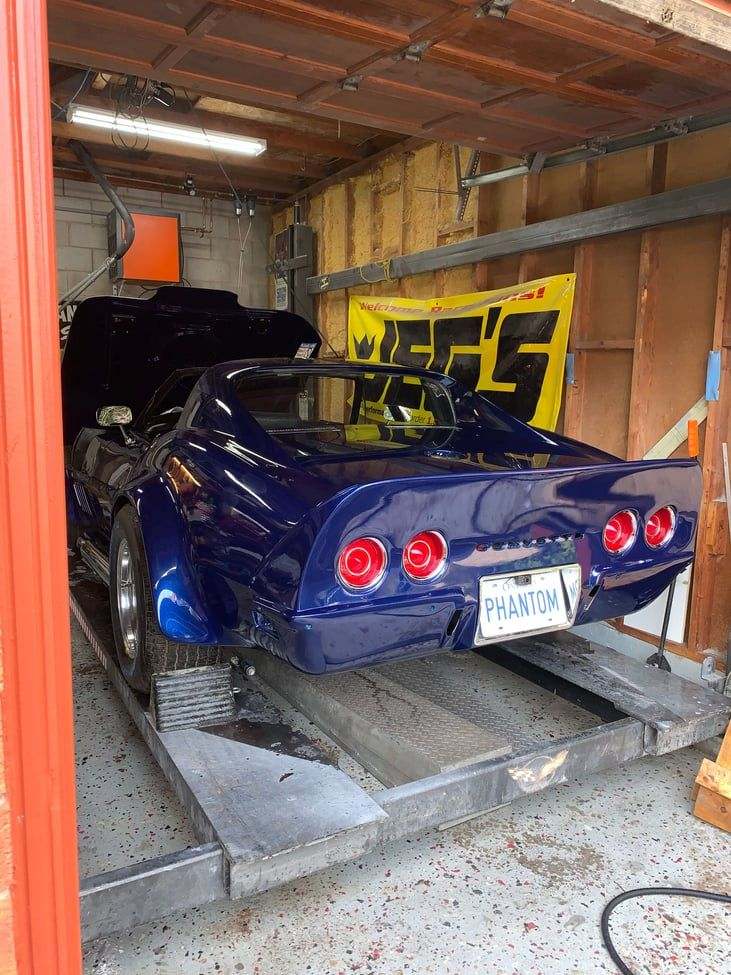

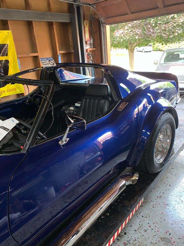

15 x 10 Torque thrust II ...
Dave

Your car looks incredible, did you use spacers? Do you know what back spacing? Did you lower it with lowering bolts if you did do you know which ones.
Thank you killer car!
Old Feb 7, 2024 | 03:36 PM
The Phantom's Avatar
The Phantom
Joined: Nov 2012
Posts: 1,974
Likes: 869
It's a looooong and ongoing story, I was shooting for COOL CAR, but Killer works and thank you. No spacers, 4.5" front and 6" rear.
