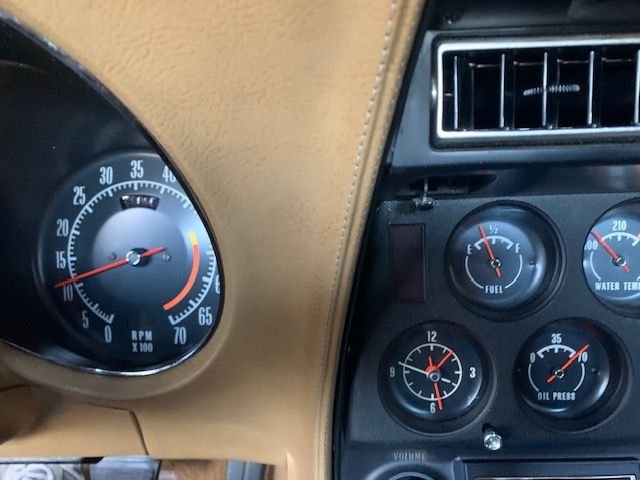

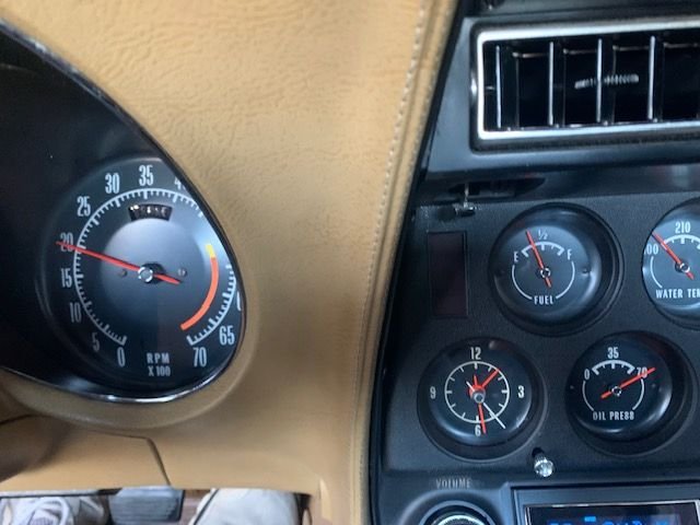

I've attached 2 pictures below -- one at idle and one at 2000RPMs. As you'll see, I'm reading ~70PSI at idle and higher than that at 2000RPMs. I know those sound high, based on other posts I've read along the way. But I don't think that I need to be concerned. FWIW, I'm sure that I need to check/tweak the timing as I'm pretty sure my distributor base plate didn't land 100% exactly as it was before doing all this work but I knew that the distributor rotor was pointing exactly where it was before I took out the distributor and I knew the advance canister was pointing almost exactly where I locked it down. In other words, I might be off 1-2 degrees at most from where I was so I knew I'd be safe to fire it up and see what everything showed.
In any case, I think I've saved an oil pan removal job and an oil pump replacement job.
Pressure at idle above (yes, the idle is a tad high since I haven't fine-tuned the timing yet, as I mentioned)
Pressure at 2000RPMs. Note that it's over 70PSI.

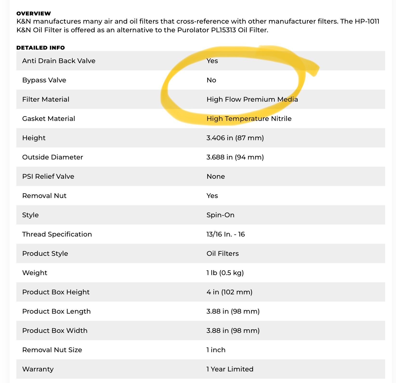

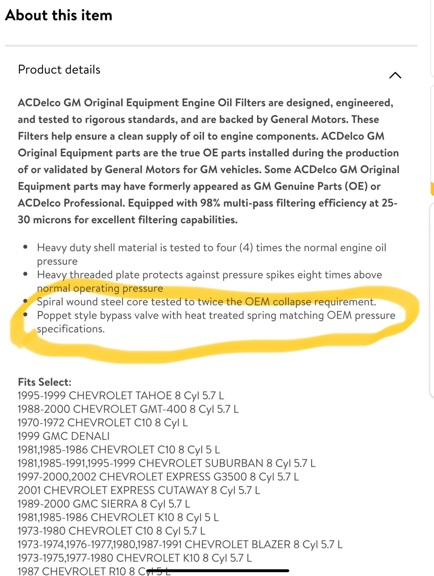

if the filter clogged, wouldn’t the bypass allow pressure?
Old Feb 22, 2024 | 09:27 PM
  #72
interpon's Avatar
interpon
Joined: Jun 2019
Posts: 7,649
Likes: 2,466
From: Indiana
its not the collar, its the bushing at the bottom of the shaft that makes sure the oil gets to the passages
edit…holy cow! No bypass..looks like ac delco does..
