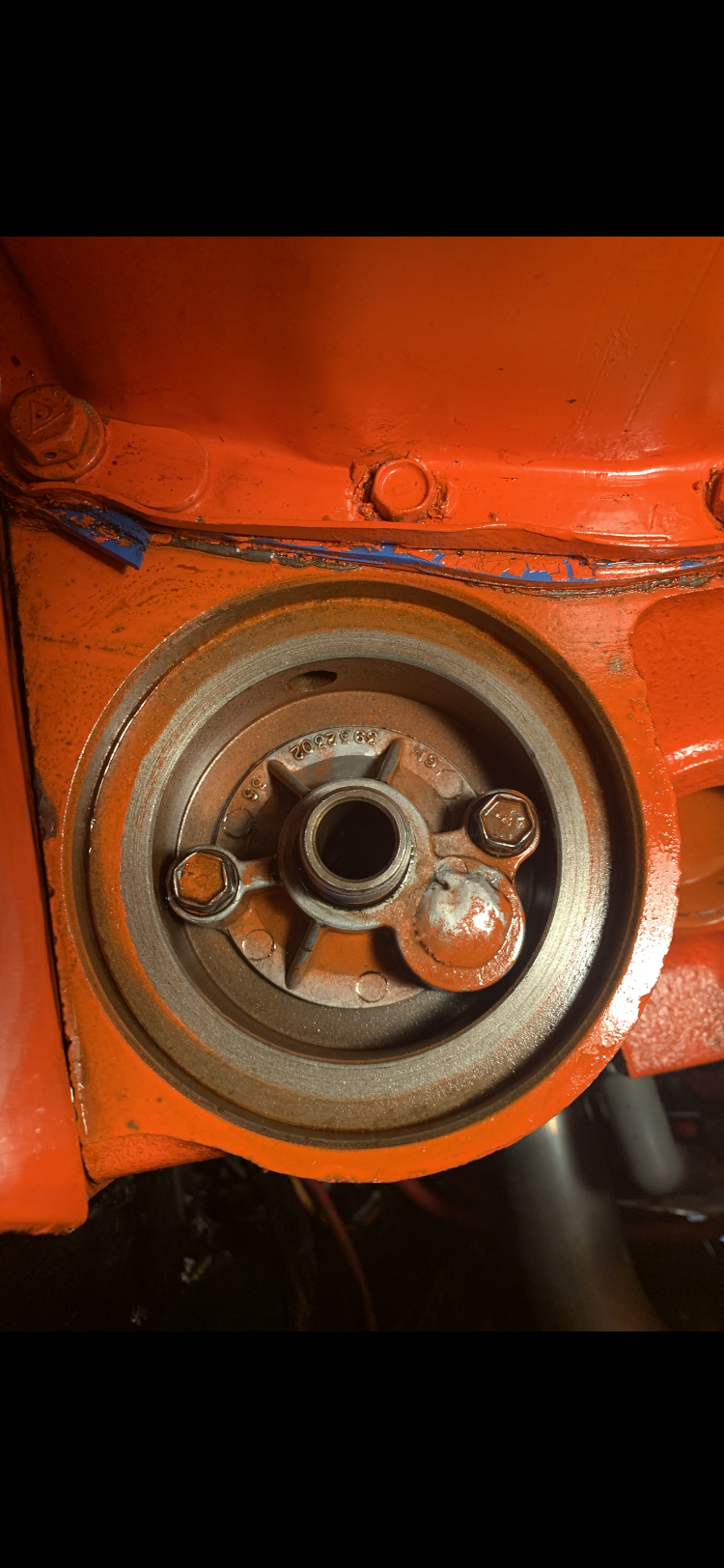

Default One more bit of information which adds more detail
Someone along the way (likely the engine builder) chose to block off the built in bypass on the oil filter adapter plate.
Here are 2 images I took during the entire journey I have described in this thread.
I’m not sure if the engine builders intended there to be that pin hole of a gap in their plug but whatever…
If I understand correctly, with that bypass blocked off, it would force all oil through the filter. And since the Purolator filter I had on there also had no internal bypass valve, well, yikes. I’m not sure if I mentioned this or not but the oil that I drained out had less than 1000 miles on it.
Having said all of that, Inwill reiterate that the AC Delco filter I have in there now DOES have its own internal bypass valve.
I’m sure I’ll get a mixture of opinions on this but I’m considering swapping out the doctored oil filter adaptor base that’s in there and installing a replacement which has the bypass valve intact and functional. I’ve seen guys say they block off the bypass valve on the adaptor plate to force all oil through the filter. That sounds reasonable… as long as the filter itself also has an internal bypass valve.
Let the opinions fly!

I’ve never been a fan of the block off bypass plates.
dirty oil is wayyyy better than no oil.

ive done it, my buddy that raced methanol engines did it, and his 11 second 377 75 fette has it. Its good for the motors bearing life but you have to use a high end, quality oil filter. The $4 Fram, puralator, stp filters will suck in the cheap cardboard/paper filter element and plug up the outlet. Its not dirty oil, its just the oil that is getting forced through there and cant get through a cheap filter fast enough collapses the element IF you cut yours up I bet thats what you wouold have seen, not bearing material, crud or pixie dust. I just put a brass plug in the filter adapter on my 427 build but I am using the tall truck K&N filter for more surface area and it has a bypass in the filter if the pressure differential is too great.
These racing application modifications are fine for street engines if you are aware of the how and why that its being done and what to do to make it work.

Now it's starting to make sense. I think your next step is to cut the filter open so we can see what was going on in there.
FWIW cutting the filter open and examining the filter media is a required step in every oil change on an airplane. We could probably learn from that. There are filter cutters available to make the job easy. I have a couple of different models.
