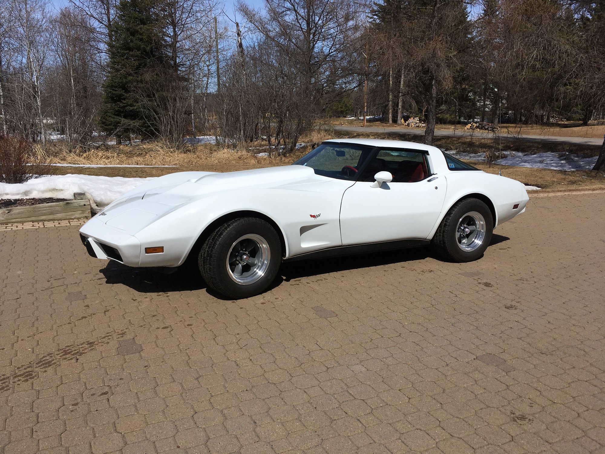

I have torque Thrusts with 255/60R15s on my '79. They sit just noticeable farther out than stock. Perfect to my eye. The problem is the regular Torque Thrusts won't clear the brake calipers on a Corvette. I got mine through one of the Corvette supply houses many years ago. (I would have to root through my records to remember which one.) As I recall they were having them specially made or modified to work on our cars.

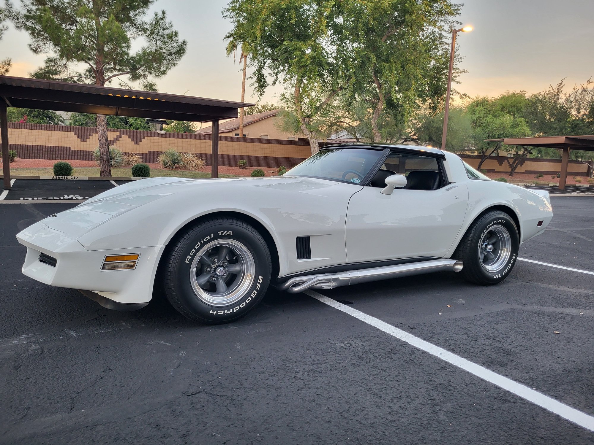

Both with 15x8.5 and 3.79" backspace and 255-60s no rub at all

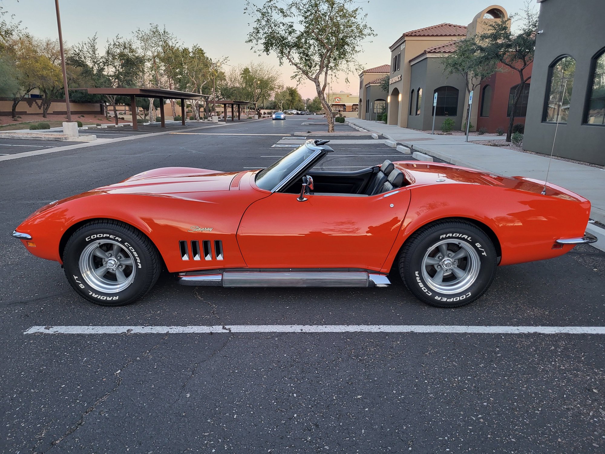

I ran that size tire with TTII polished aluminum wheels, 15x8, and had no problems on my 68.

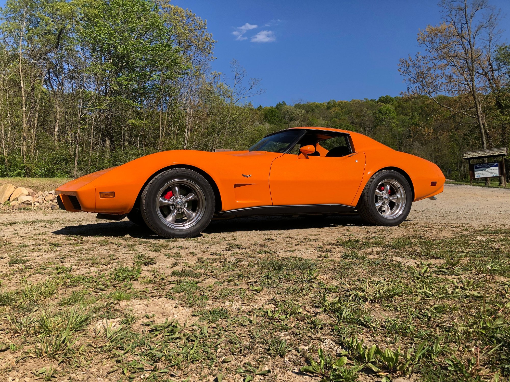

Here s mine they fit great smaller on the front .
