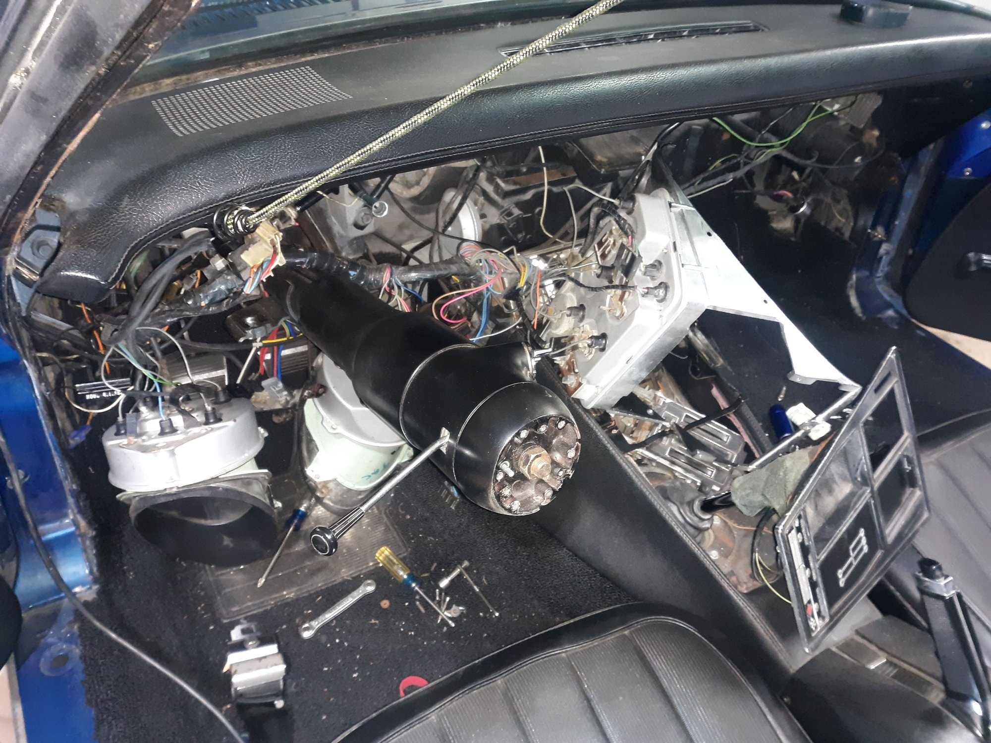

I have owned my 70 for about 10 years now. I bought it in very nice condition but it always had some issues that needed to be sorted out. These issues did not stop me from driving and enjoying it. So what's wrong? I was almost embarrassed to tell people other than my close friends that the fuel gauge, temp gauge, dash lights, horn, interior lights, windshield wipers did not work. My clutch switch broke and I have had that jumped out for a few years. When I bought it I was working full time and had other projects and obligations that all took my time, and did not want dig into the car and risk having it sit like so many projects do. So now I am retired and decided to go for it.
So far I found that the gas gauge had no ground, my temp gauge needs a sender, the dash lights need a new headlight switch, the lights in the foot wells have no bulbs I'm not sure why yet, I have the clutch switch and have to put it in. Overall the wiring is in good shape so I don't need a harness. A bonus is the now exposed upper birdcage is super solid.
a couple of questions
Where should I get a good headlight switch?
I heard the best temp sender is from Letric Limited, correct?

The update, I got the clutch switch in. What an ordeal, something that should take 30 minutes took 4 hours.
I ordered a NOS headlight switch.
Carriljc, the temp gauge never worked since I owned the car. It it getting power and twitches slightly when the car is turned on but will go about halfway when the lead to the sender is grounded. From what I'm seeing on a few vids on Youtube that points to a bad sender. Is the adjustable resistor you are talking about replace the resistor across the two lugs behind the gauge? From what I'm hearing the Letric Limited sender is accurate where standard parts store senders are not.
Still looking for info on the seatbelt light, it goes on but the button does not turn it off.

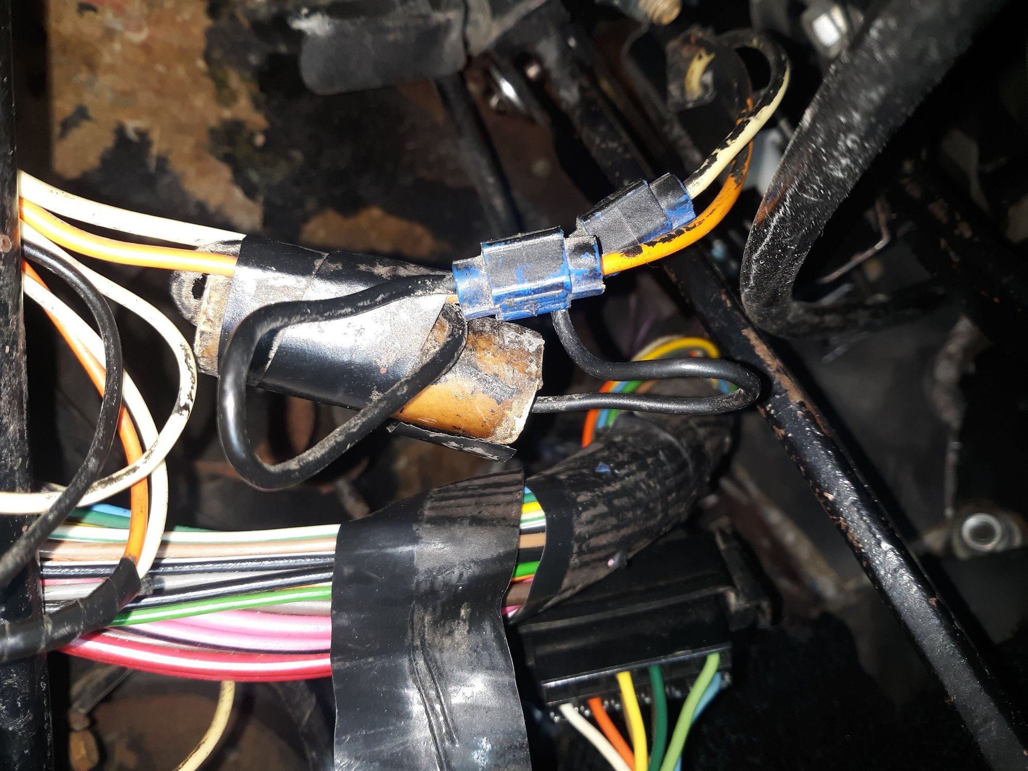

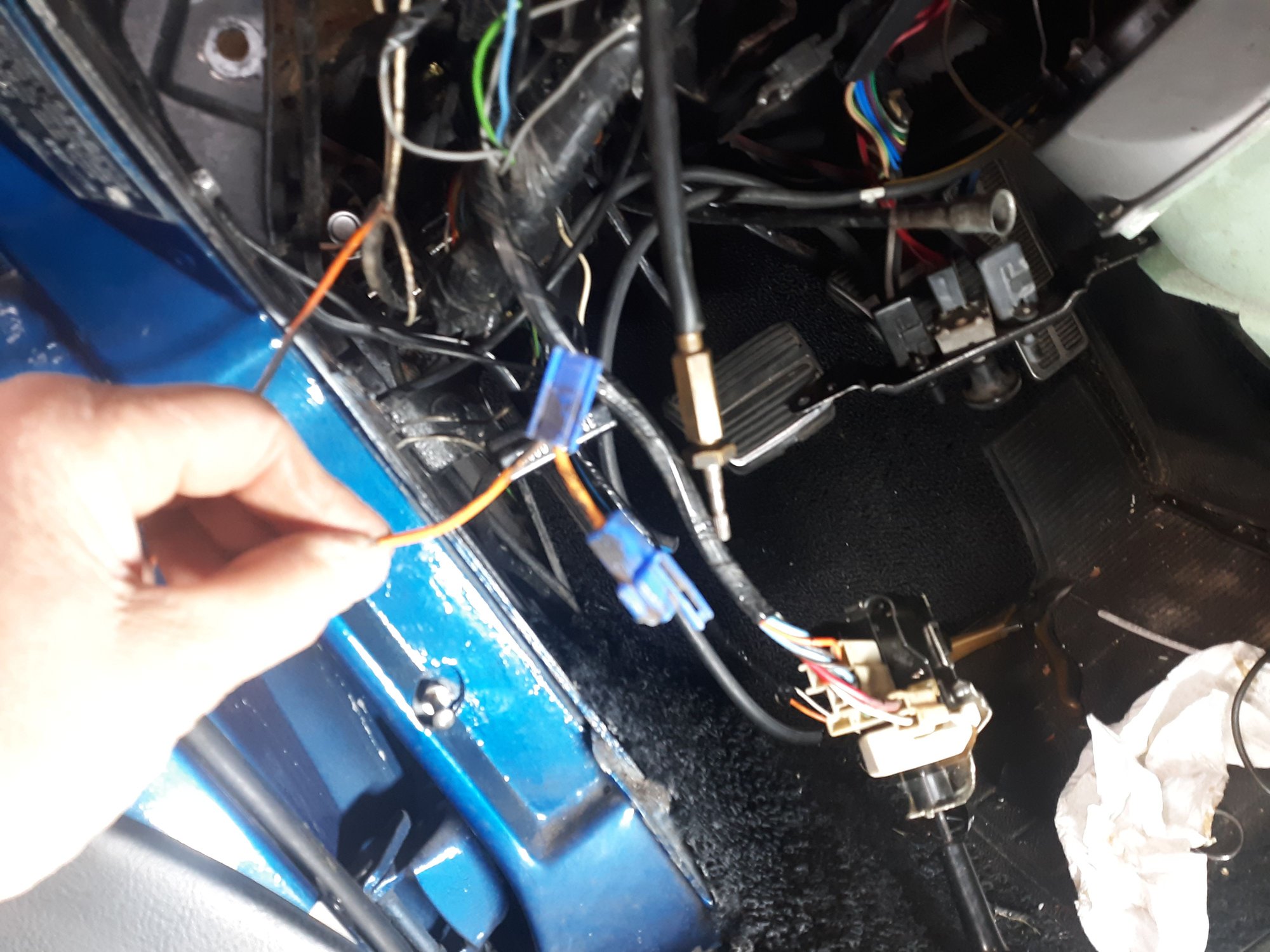

Well I think I have most of my issues resolved. I installed the new temp sender from Letric Limited today and need to start the reassembly. Once I get the driver side put together I can run the car to see if it works. So a couple questions remain.
This tandem orange wire with two blue plugs, it was not attached to any thing when I took it apart and I can't find it on my wiring diagram, what does it go to?
And this condenser looking device, it looks like it was spliced in. What do you think it is? Is it factory? and do I need it?

The condenser looking device is a condenser, and is factory-installed. The blue connectors shouldn’t have black paint on them, but they are factory!

I'm cringing looking at your center gauge cluster hanging like that. BE VERY GENTLE / CAREFUL not to break it, it's very fragile & doesn't take to much to snap it in the corners !!!

7T1 I did get the NOS headlight switch so that is resolved in the stock configuration for now but may look into a relay setup in the future.
427 Sixpack I know how fragile that bezel is, one side was already broken when I took it out!

I have a few repair pics in my tthread for the broken part...the screws are fine-thread small machine screws....the repair is not noticeable from the front once the bezel is repainted.
approx. page 336 in my thread...
https://www.corvetteforum.com/forums...post1606416531

IF you get brave....you can make a "splint" for the unbroken side of the bezel to beef it up.
I think the members said that applying too much pressure to the assembly when reinstalling it is what breaks the bezel.
Trying to stuff it into its original location can be a problem.
