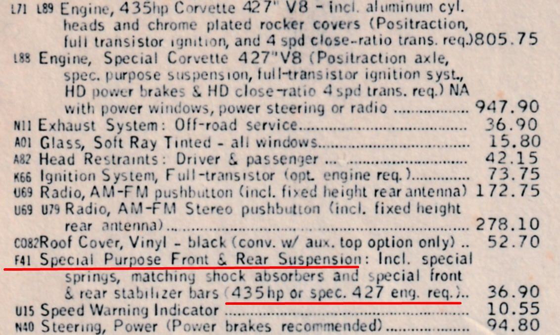

427/390 car - TH400 trans.
What was the standard leaf spring when new - 7-Leaf or 9-Leaf? Various research provides different answers.

The Standard rear spring was a nine leaf spring and the heavy duty F41 was a seven leaf spring.

I am fairly certain the F41 7 leaf spring was only available with the solid lifter engines
Yes.

Thanks for the info gents - picture is much more clear. For a 9-leaf spring would appear from my research that EATON Detroit Spring is the closest one to original as you can get -- is that the consensus of the C3 community who've tackled that project?
